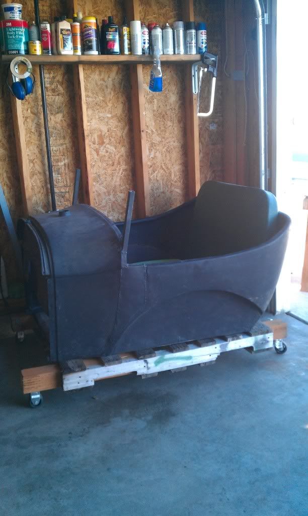

    Went to lunch yesterday and came back with this...I think I'm going to finally start a build thread and do a cheap spring cruiser. I think it started as a dodge but not really sure. I'll keep you posted, should be starting the frame this week![​IMG]

    1929 A cowl parts,... and a bumper car ????? :D

    I saw the A in the cowl...it's the back half that's killing me. At least they did a good job of making whatever they made. It's really solid just funny looking.

    definitely an A dash insert with a hole for stewart warner speedo.

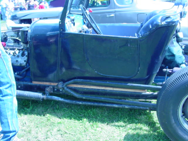

    my friend Forrest: J-lopy kid on the hamb in Palouse built something like that, sold it last year wonder if it's the same one?!? should pm him and see.

    I made something similar with an A cowl and backend from something else. Also narrowed it like the seam I can see in that one but filled the wheel wells. Before I filled in the sides I sat in it and made sure I could have both legs straight out with the cushion in. I think the traditional bucket is to short to sit comfortably down inside. You may want to stretch it some, and I found what I think is a touring door longer than a T bucket door, or else stretch a door also.

    Something looks off ,How wide is it ....Its a touring back peice and a model A .Looks like a one seater off a drag car

  12. Separate a 29 A Tudor at the seam under the beltline, and you will have the beginning of how the rear of that car was made. Different way of being creative.
