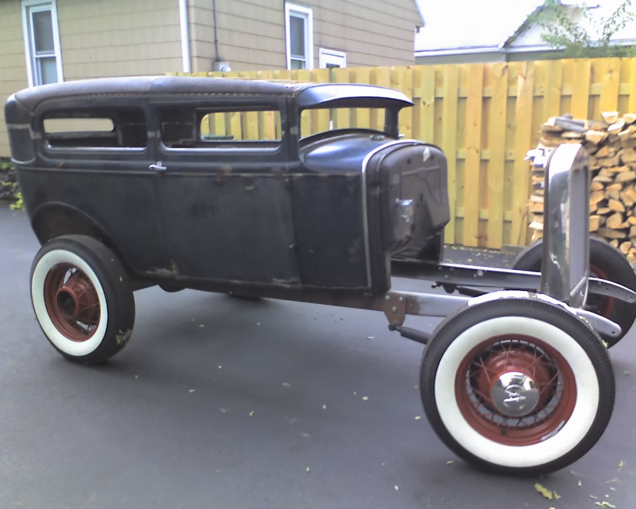

    Working on it now.
    Brent, The green follows me, lol.
    Gotta be honest, I want five. The blue one above is looking really good.
    When I look at this at four inches, it just tells me five would be better.
    However, at 6 foot tall, space will be a little of an issue.
    No fenders on this one, and no channel.

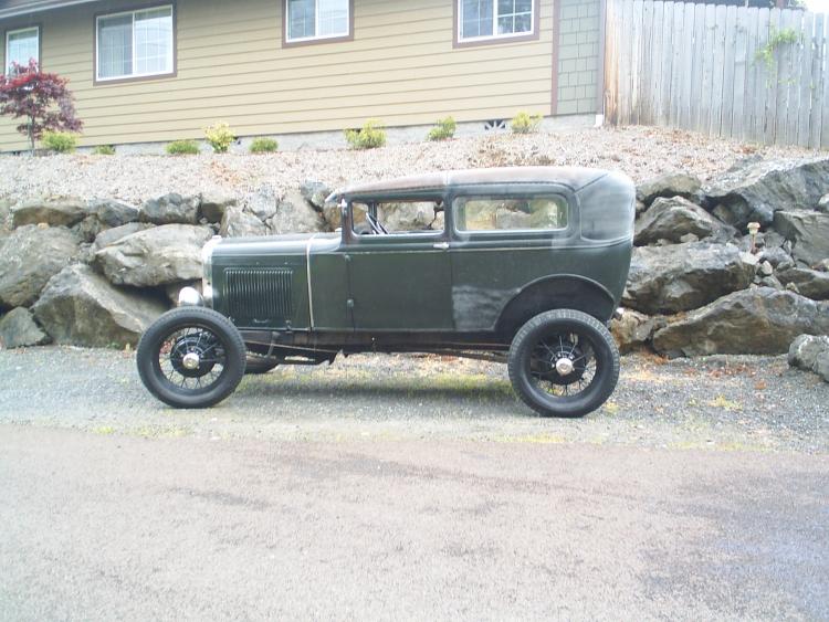

  3. 117harv
    Joined: Nov 12, 2009
    Posts: 6,586
    117harv
    I dont know how much this chop is, found the pic on here somewhere, maybe 6"?

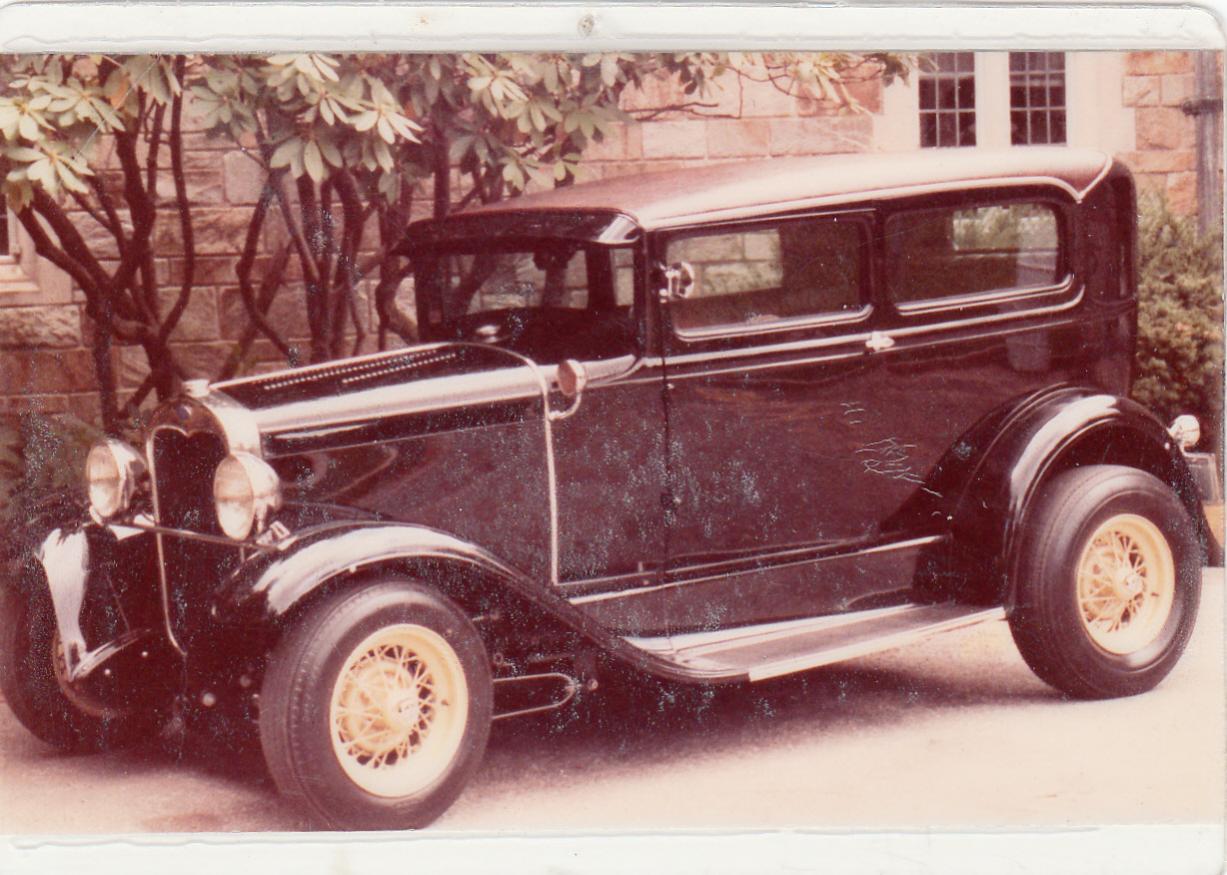

  8. ct1932ford
    Joined: Dec 3, 2010
    Posts: 13,273
    ct1932ford
    I did this one back in the 70's 4 1/2" I thought it was perfect. If you are going fenderless I would go 5" but no less than 4 1/2"

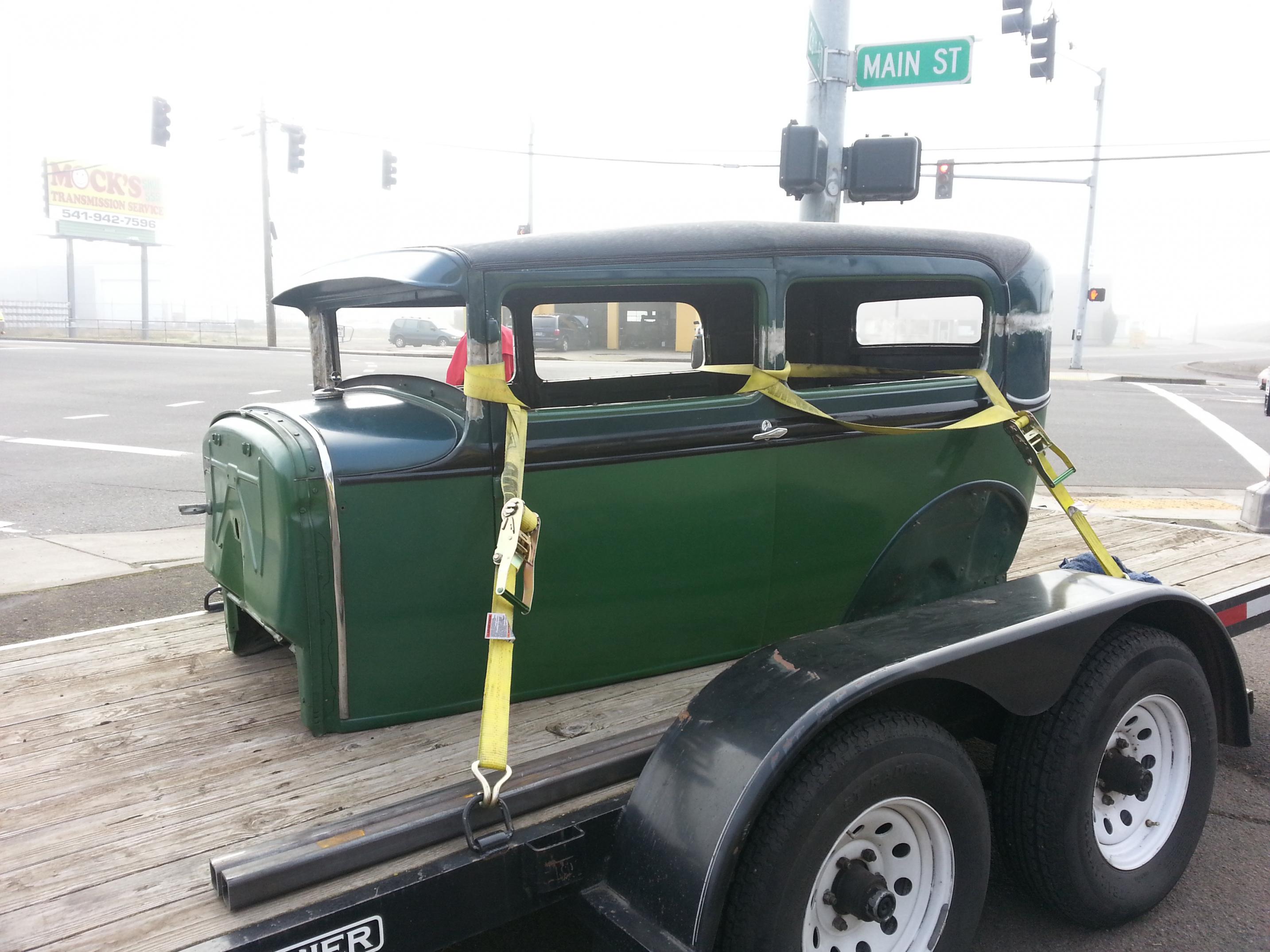

  13. A Rodder
    Joined: Jul 13, 2008
    Posts: 2,474
    A Rodder
    Made a little more progress
    Some puckering going on and some old body work revealed.
    This side did much better. I do think it would have been better to slice the bottom and bring it out to match the top rather than how I did it. Hindsight
    Not a great pic, but most of you guys know of the taper issues with these. This is how I dealt with it.
    And after a few tacks, the plane of the post is now stright. In the pic the door frame looks jacked up. The top and bottom aren't attached with tacks yet so they are sagging a little in the pic.

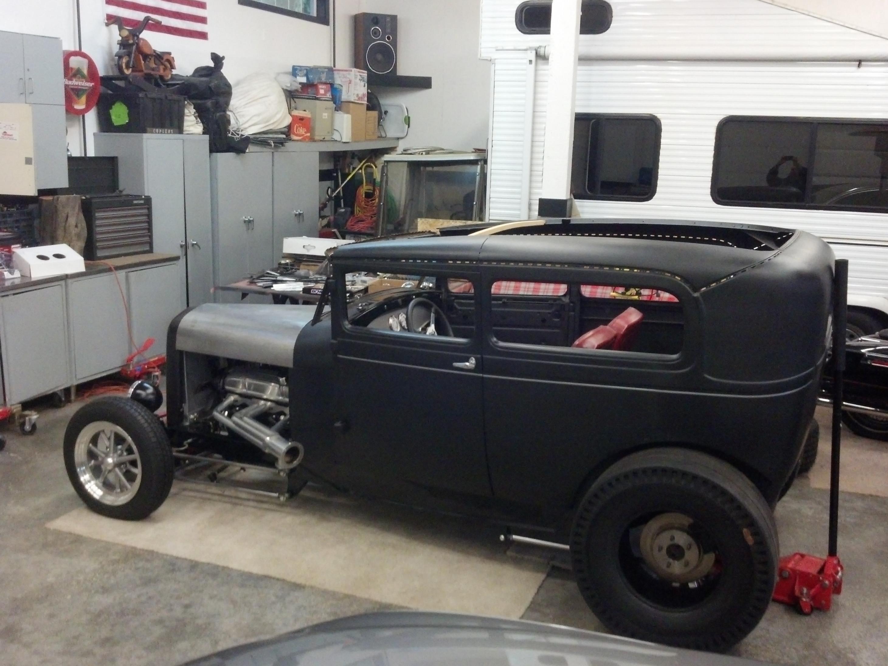

  24. A Rodder
    Posts: 2,474
    A Rodder
    I only... went 4"
    5 is really tuff looking but four should do.
