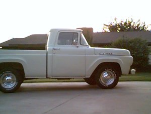

    would like to see pictures of your pick up ..Interested how you change the frount suspension,,I am thinking of using a 00 to 003 Crown vic if i can find one ....thanks Dan
