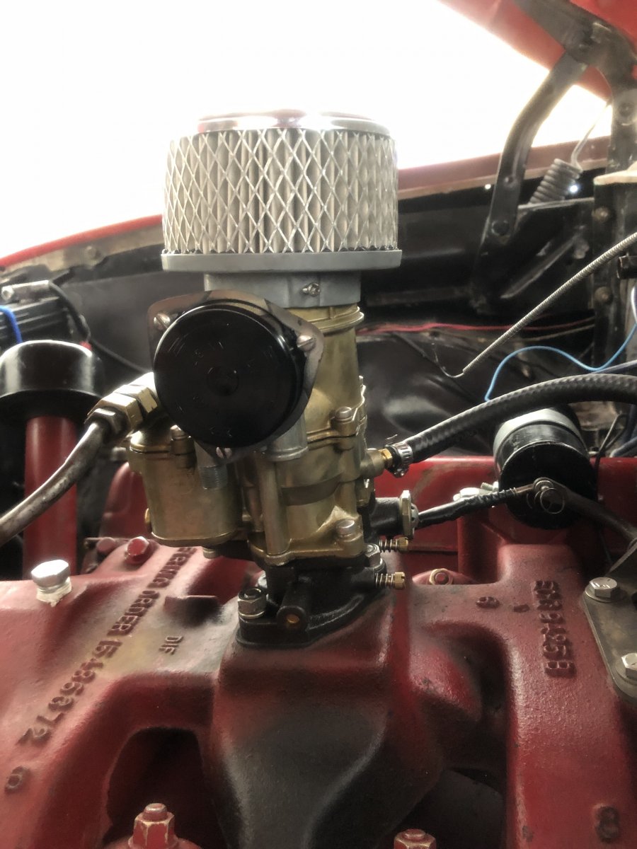

    A vacuum gauge needs to be connected to a constant source of manifold vacuum. It's a little trickier to do because stock or factory style carburetors don't have this.
    There is a silver pipe plug right in front of the carburetor in your picture, pointing at an angle. That is a convenient place to connect a mechanic's vacuum gauge, need a 3/8" NPT fitting with a barbed end.
    You really need to find a blockhead closer to you to help out.

    I have already said it a couple of times. The threaded port sticking down from the choke ***embly. This will leak vacuum if there is nothing hooked to it and it looks like there is nothing hooked up to it. have someone hold their finger over the opening while you start it or put a piece of tape or a rubber hose with a bolt in the end of it... anything to plug it

    Not all Qjets are created equal. A lean idle makes for less emissions ( smog). On about 73 and up Qjets the factory enlarged the air bleed orifice and
    put in a air by p*** under the throttle plates. with this set up backing out the idle screws makes no difference. THE fix is a small dia. piece of copper wire bent in a horse shoe shape inserted into the air bleed hole, the air byp*** hole in the throttle plate can be plugged with a accelerator pump check ball. These mods will richen up the idle circuit.

    That’s not the best vacuum source. The spark port off the carburetor to the distributor is metered ...it’s all part of that Loadomatic advance system.
    A better vacuum source is off the intake below the carburetor base. This is manifold vacuum that runs the wipers.
    It’s that way in an 8BA but Y blocks should be the same.
    The bottom line...
    Your not going to get a good vacuum signal off that location for your gauge.
    You have bigger fish to fry.
    What’s the history of the carburetor? Remanufactured....When?
    Do you know what vehicle it’s from? There’s hundreds of applications for a 94.
    Do you still have the original carburetor?
    I may be wrong here on a 94. The info about the heat choke below is based on later 2100s, Holley 1850s and 4100s.
    I can’t see how the heat choke can cause a vacuum leak unless it’s pulling through the screws in the carburetor body. The heat choke is a stand alone unit that screws to the side of the carburetor. It should not draw vacuum. As a matter of fact, if anything you might have an exhaust leak off the exhaust manifold if equipped with the heat tube rather than a vacuum leak from the carburetor. That is unless it’s pulling through the mounting screws which is unlikely.

    There is an internal p***age in the carb that puts vacuum in the choke housing. The vacuum is how the heat from the tube is drawn up there

    here is a pic of one of those carbs, see the gasket between the choke housing and the carb body? that is because there is a vacuum p***age there. click the pic to enlarge. She needs to check the threaded fitting coming out of the bottom of the choke housing for a vacuum leak

    It is plugged, I had plugged it before in there to block the p***ageway and I did notice that the whistling sound that would periodically happen disappeared but it still didn’t fix the problem of not holding the idle

    I also managed to get someone to press on the pedal to keep her Idling while I adjusted the idle screw and the mixture screws and doing those things didn’t even help the issue she still peters out after a while

    Can you turn the idle screw in more, how about a picture of the carburetor side views.
    How many turns are the idle mixture screws out?
    If you put your hand over the carburetor when it is running, does it get better or worst?

    Idle mixture screws are 1 and 1/4 out each. I’ll take pics and post later. Also, she revs when I cover the top of carb with my hand

    Hard to tell but it looks like the idle speed screw is not touching anything, am I wrong?
    Sounds like the idle dash pod is working but not the idle screw.

    have you looked at distributor points gap/condition? - not problem but, large hose from back of carb to distrib too large of diam - hose from fuel pump to carb 5/16"?

    Looks to me like you adjust the idle with the dash pot

    Dash pots are just used to slow the return of the linkage to idle, kind of like a shock absorber for the throttle linkage. The idle speed would still need to be set by the idle speed adjustment screw, and I agree with @saltflats , it doesn't look like the idle screw is touching anything. But my eyes aren't so good, so maybe that's not right.

    It looks like the fast idle cam and linkage that is activated by the choke is missing from the p***enger side of the carb. Since it is missing, there is nothing for the idle speed screw to bear against.
