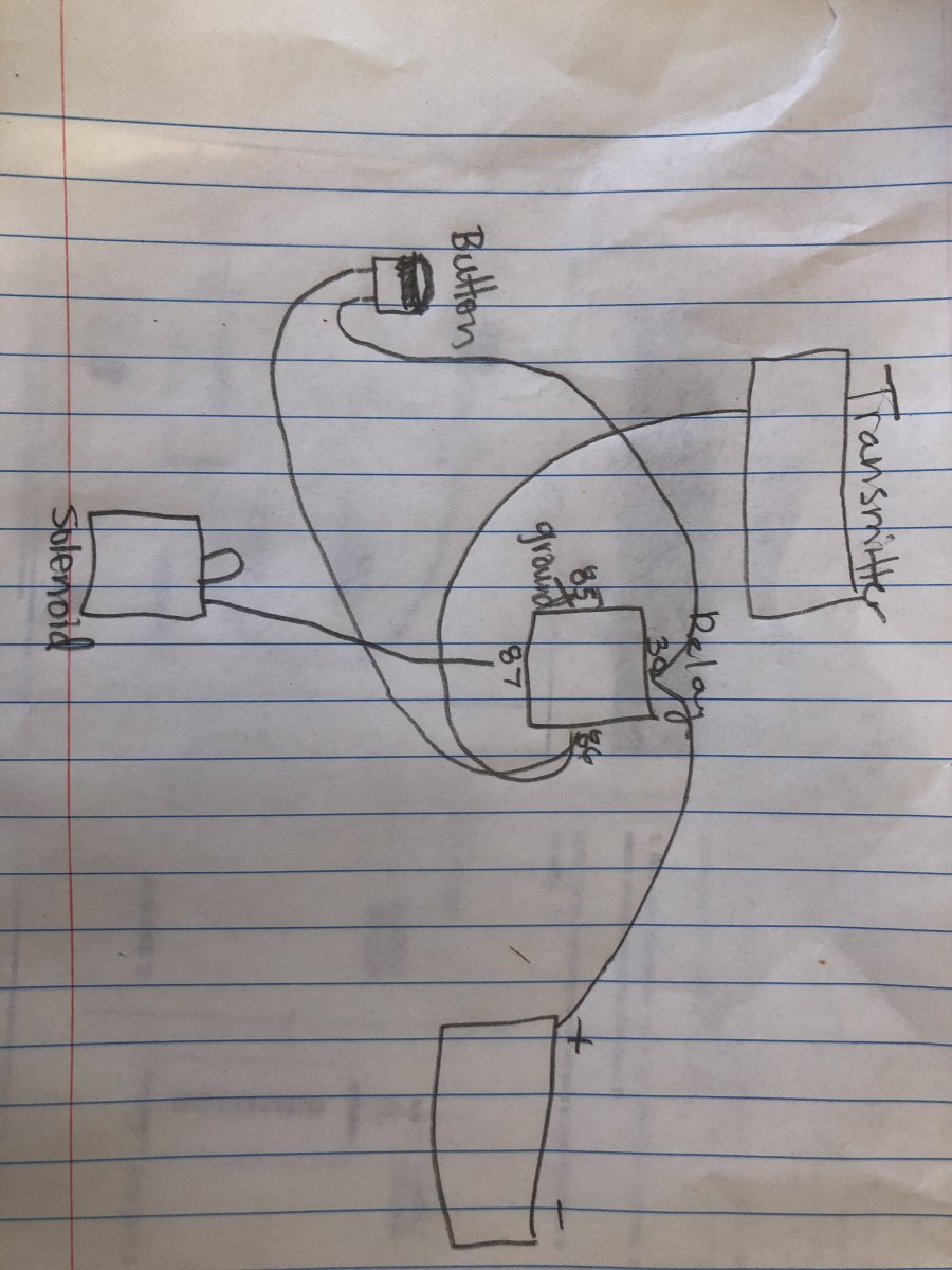

    So I’m switching gears again and working on the wireless entry remote wiring to the two front door poppers. I’m completely lost once again lol. 61704767439__B335967F-E460-4194-8A4F-CD8AA79AE9F5.JPG this schematic may as well be written in Greek, makes absolutely no sense to me. ‍♀️ any advice would be appreciated. I have the solenoids already mounted, just need to wire it all. I’m not planning on using all of the wires. Just the unlocking directly to the two doors.
  10. fresh hops
    Joined: Oct 19, 2019
    Posts: 71
    fresh hops
    I would take some tape and label each of the wires based on the schematic. Your going to need to have 12 volts supplied to the poppers, make sure the 12 volts is fused. The system your installing will switch the ground to activate the door popper. I would think this 12 volts needs to come off the battery since you want to activate the doors without a key in the ignition. The relay that connects to the ignition switch looks more complicated than it is, you will need to identify the "on" and "start" post on the back of the ignition switch, Not sure why they want you to put the other red wire on the starter, I have never installed one of these.
    This is not that bad, what do you find complex? understanding the layout or identification of the components?
    You might want to lay out the parts in the same orientation as the schematic.
    Remember this is just a road map, no big whoop!

    There’s several things I’m confused about. One is , the blue/white and the green/white wires. What do those hook up to? It says lock and unlock.
    Also, the white and brown wires, are those going directly to the switch and then to the solenoids?
    I have a switch installed inside the cab to open the doors. I’m confused as to how I would wire them all. [​IMG]
    I wired everything as in that drawing I did, but the remote transmitter just makes a clicking noise when pressed, solenoids won’t activate

    Your relay is wired wrong.
    30- Battery and feed for ****on Switch if > (is solenoid getting ground from just being bolted in place?)
    87-Solenoid
    86- signal from Transmitter and signal from ****on Switch.
    85- Ground
    Ok. Note I've come to this based by your pencil drawing only.
    Christie likes this.

    Which wires do I have wrong on the relay?
  16. Christie
    Joined: Jun 4, 2007
    Posts: 215
    Christie
    Yes, solenoid is ground by being bolted in place. Thank you so much I’m advance for your help!!!! I’ve watched countless videos on you tube and I’m still wiring it wrong ‍♀️I’m literally hanging on your next word on what to do next lol!

    Up dated my post so please re-review.
  18. Christie
    Joined: Jun 4, 2007
    Posts: 215
    Christie
    Like this?
  19. Christie
    Joined: Jun 4, 2007
    Posts: 215
    Christie
    I’m confused because If I wire it this way there’s no connection to the solenoid from the ****on though
  20. Christie
    Joined: Jun 4, 2007
    Posts: 215
    Christie
    I wired it this way and nothing happened :(

    Try putting 12 volts to solenoid and see if it works. Are you using key fobs or not?
  22. Christie
    Joined: Jun 4, 2007
    Posts: 215
    Christie
    Yes, using the key fobs. The solenoids work fine with the ****ons in the cab, it’s when I add that whole mess of other wires for the transmitter/key fob in, that’s where I’m completely lost. I actually went to take a nap because I got so frustrated lol!!!!

    Not to rain on your parade; but, those fobs will need to be programmed to work Specific insstructions from the manufacturer, do you have that info?

    I do have instructions on here for the fobs. But I’m not sure if they need to be programmed. ?? IMG_9220.JPG
  27. ROADSTER1927
    Joined: Feb 14, 2009
    Posts: 3,286
    ROADSTER1927
    It is in the first instruction on the sheet. Under features. Good luck, Gary:)

    Did ****on at least work?

    So that means I need to wire it to the ignition and lamps/lights as well? IMG_9220.JPG
    And I’m still confused on the two wires (blue/white and green/white) where do those go?
