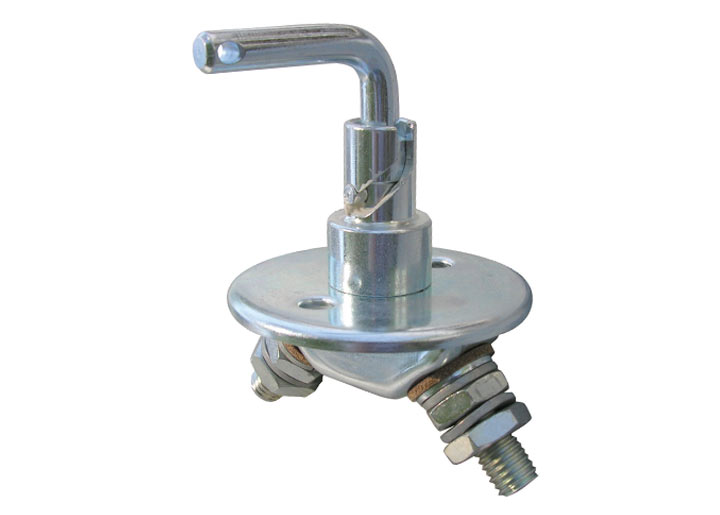

    I install one of these in everything I mess with :D
    Also works as a anti-theft measure :rolleyes: :rolleyes:

    I was looking at the cut-off switches that have the aluminum knob permanently attached as they would fit where I want better.
    I bought a wire harness kit today,just have to rip the old stuff out and install the new.

    You might want to re-think that switch - hecho in China??? - and go with a heavy duty type with removable key - just an old racer talking here....
    www.specialtauto.com/delorean-parts/electrical-2.html
    or....
    www.texasindustrialelectric.com/switches.asp
    or the type I used for racing from Bosch....
    www.autoatlanta.com/porsche-parts/accessories.php?sec=Electric&model=912 1965-69&subsec=Batteries-and-Related
    They make good theft deterrents as well....

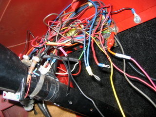

    This didn't have anything to do with the short & fire, but this is why I'm re-wiring with a whole new harness & fuse block....imagine trying to troubleshoot this mess!!!
    And I've owned cars with worse wiring !!! (before I rewired them)
