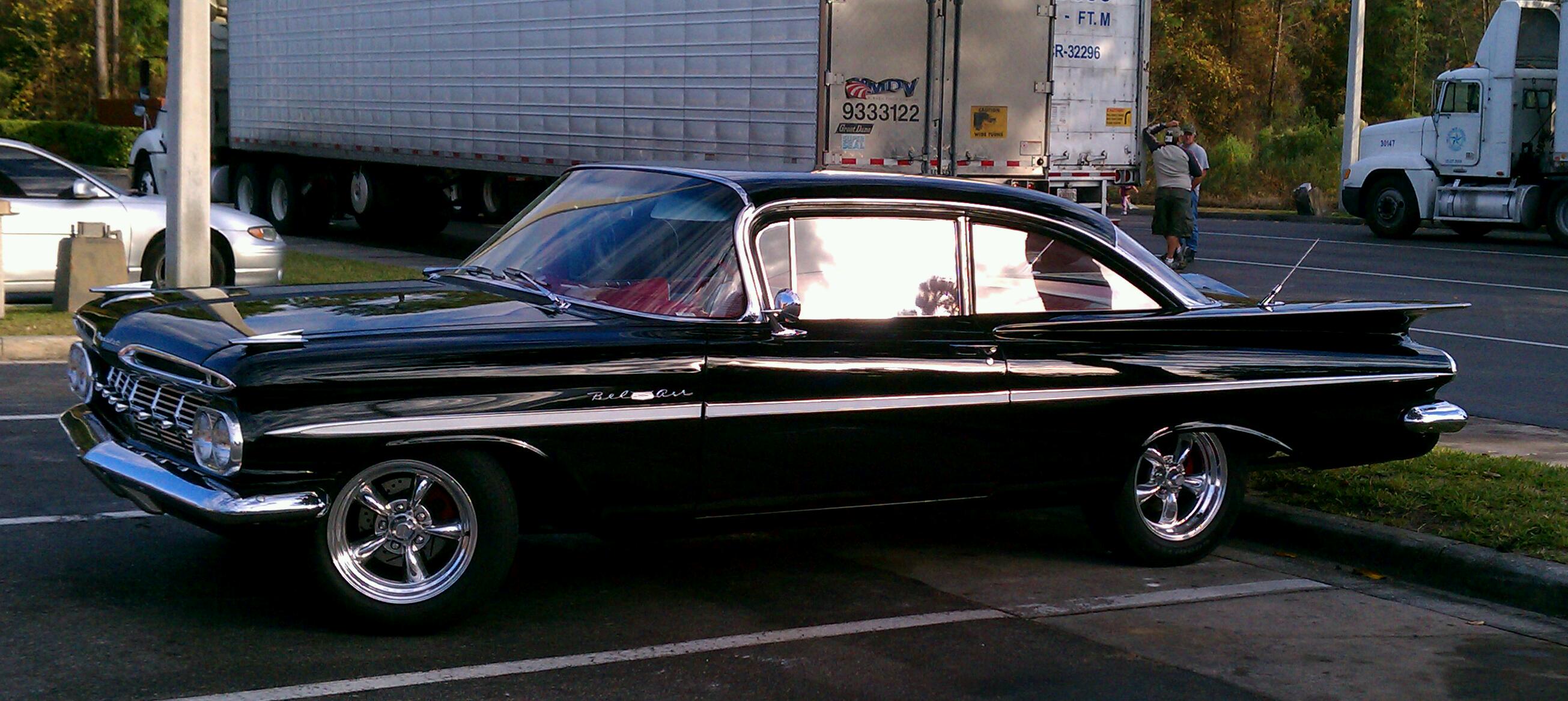

    always wanted one and now i got one :D :D :D
    picked it up in Florida and drove it home to houston with no problems.
    its an automatic, i will try to turn it into a manual floor shift car.
    any tips on how to do this would help me out.
    (dumbass me learned today this is not a bubbletop, i am always glad to learn something on the HAMB)

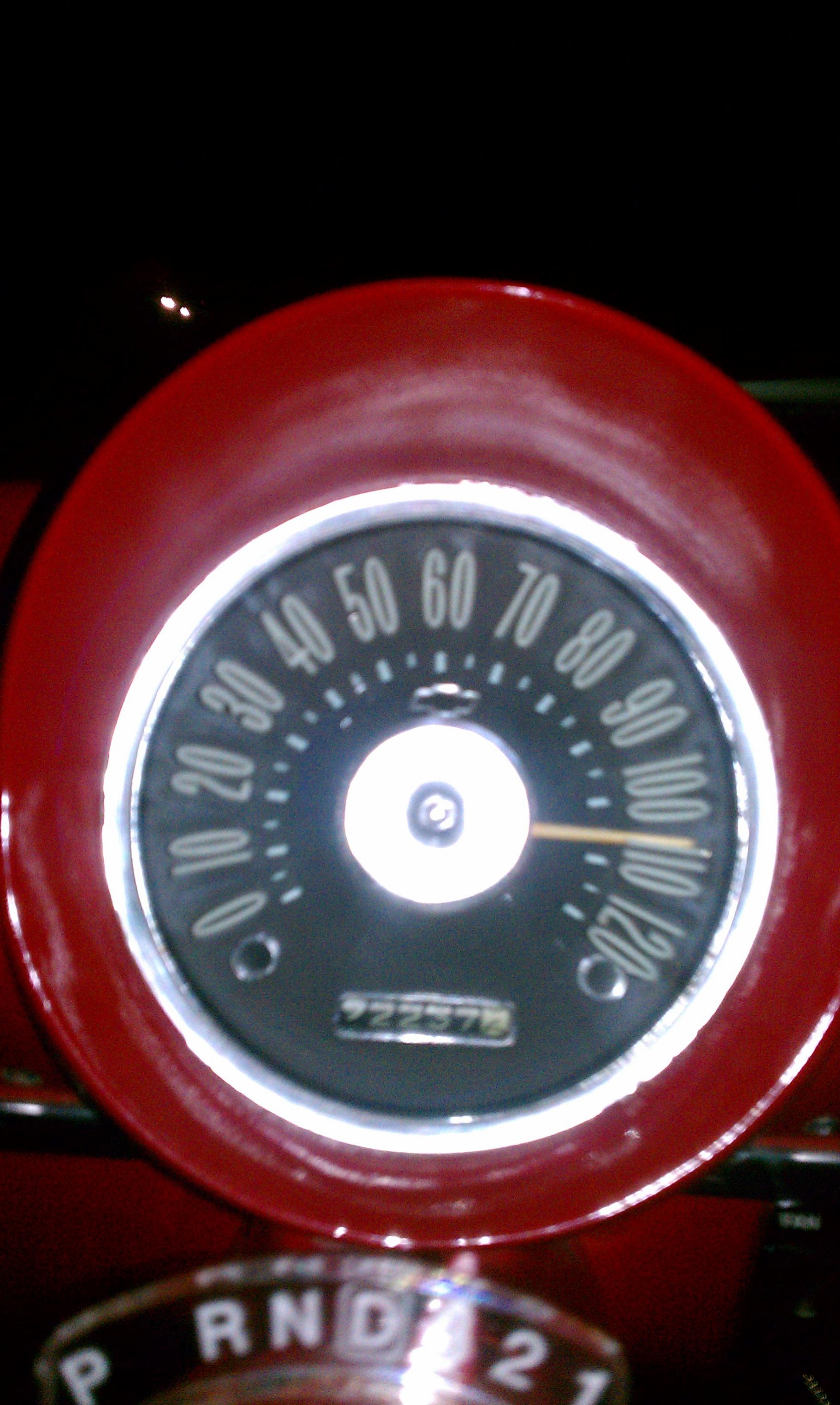

    Speedometer broke or..........whoa.
  4. So its got a hydro and you want to switch it to a manual? I am seeing 1,2,3&D there correct?
    really nice lookning car but I think that is a 2 door sedan if I am not mistaken. really nice car. 283 car or 348?

    its got a 350 motor with a 700R tranny.
    maybe put a muncie in it would be my plan

    I have a Muncie M20 in my '56 Nomad and would love to put a 700R4 behind it instead. Lower first gear plus overdrive sounds nice with the 3.70 rear gears I'm running

    Well to change the auto to a standard would require a petal setup and of course the trans. It depends then if you want to look stock or modified. You could source a standard colum or go aftermarket to get rid of the automatic indicator. And then the question is do you want manual or hydrolic clutch.

    To go standard trans, buy the linkage parts, and trans of your choice, easy to find through auction sights. The crossmember has to be modified or replaced to fit a 700r4, a stock crossmember wors with a 3 or 4 speed, I'm not sure about a 5 speed. The driveshaft will need to modified to fit the standard you choose. Factory service manuals are available online, and have great schematics for the parts needed to go with the standard. Mine has a 427 and a 4 speed, all factory parts for the bellhousing and linkage, obviously some fab for the hurst floor shifter.

    It's not that hard to change it over from an automatic...need pedal (clutch & brake) assembly, bell crank, original tranny mount...I have all that and it's for sale.

    The first thing to do is to buy a "FACTORY GM" 1959 Chevrolet shop manual and assembly manual. These are reprinted and can often be found used on Ebay for a good price. These will have good illustrations of how and where the factory clutch linkage goes.
    As far as parts....Try to find a complete clutch AND brake pedal & linkage setup from any 1959 or 1960 full size Chevy. Stick brake pedals and auto brake pedals are slightly different. The easy way is to remove the entire brake & clutch pedals and bracket assembly in one piece from under the dash and replace the auto brake pedal and bracket assembly. You do not need to change the steering column to a stick column if you are going to a floor shift.
    Since you have a V8, you will need a V8 bellhousing....Either a stock 59-60 V8 one or a scattershield, (such as a Lakewood), will work. The rest of the clutch linkage is the same between V8's and sixes, (except for the cross shaft pivot that screws into the side of the engine block). Remember to get the cross-shaft bracket that welds to the left frame rail.
    You may, or may not need to modify your driveshaft. I've never had a 700R trans, so I do not know how it compares, length-wise with a Muncie 4 speed. The rear half and center bearing will be the same, no matter what trans is in the car. The front half varies in length, according to the length of the trans. A 4 speed , (or 3 speed O.D.), has the shortest front driveshaft half, while a 3 speed has the longest. The stock rear motor mount crossmember works with a Muncie. There are two sets of holes in the frame brackets, to vary how high the crossmember bolts in.
