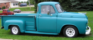

    On the pictures, the red one is a 50 cab/clip mounted on an 80 dodge 4x4 chassis, the teal one is clipped with a F, M, J (Volari/Aspin) mopar clip, both trucks run 360s with autos. The teal one has an 8 3/4 from a 78 Dodge pickup with 3:23 gears, the red one has a 9 1/4 with 3:55 gears. Gene
