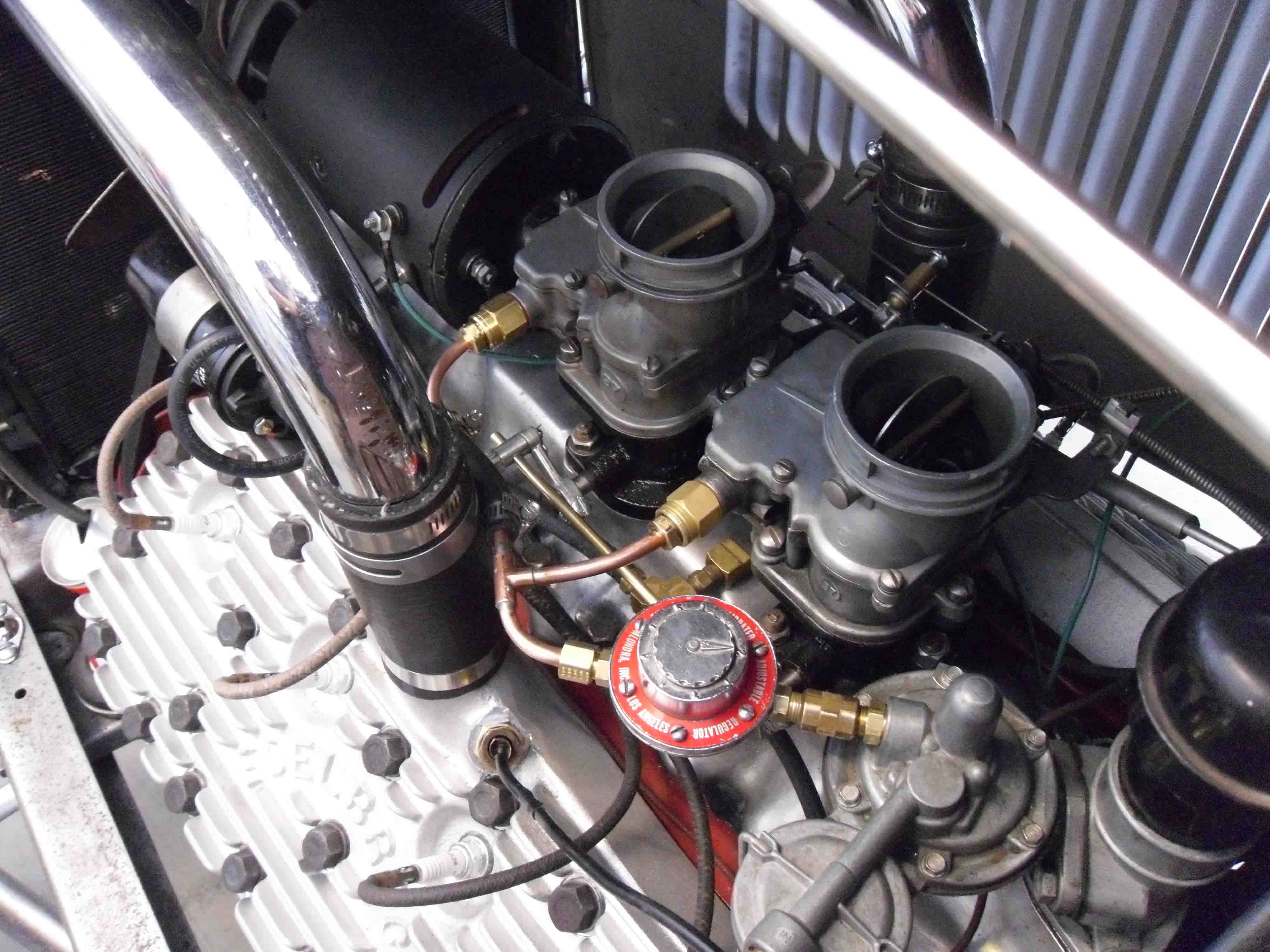

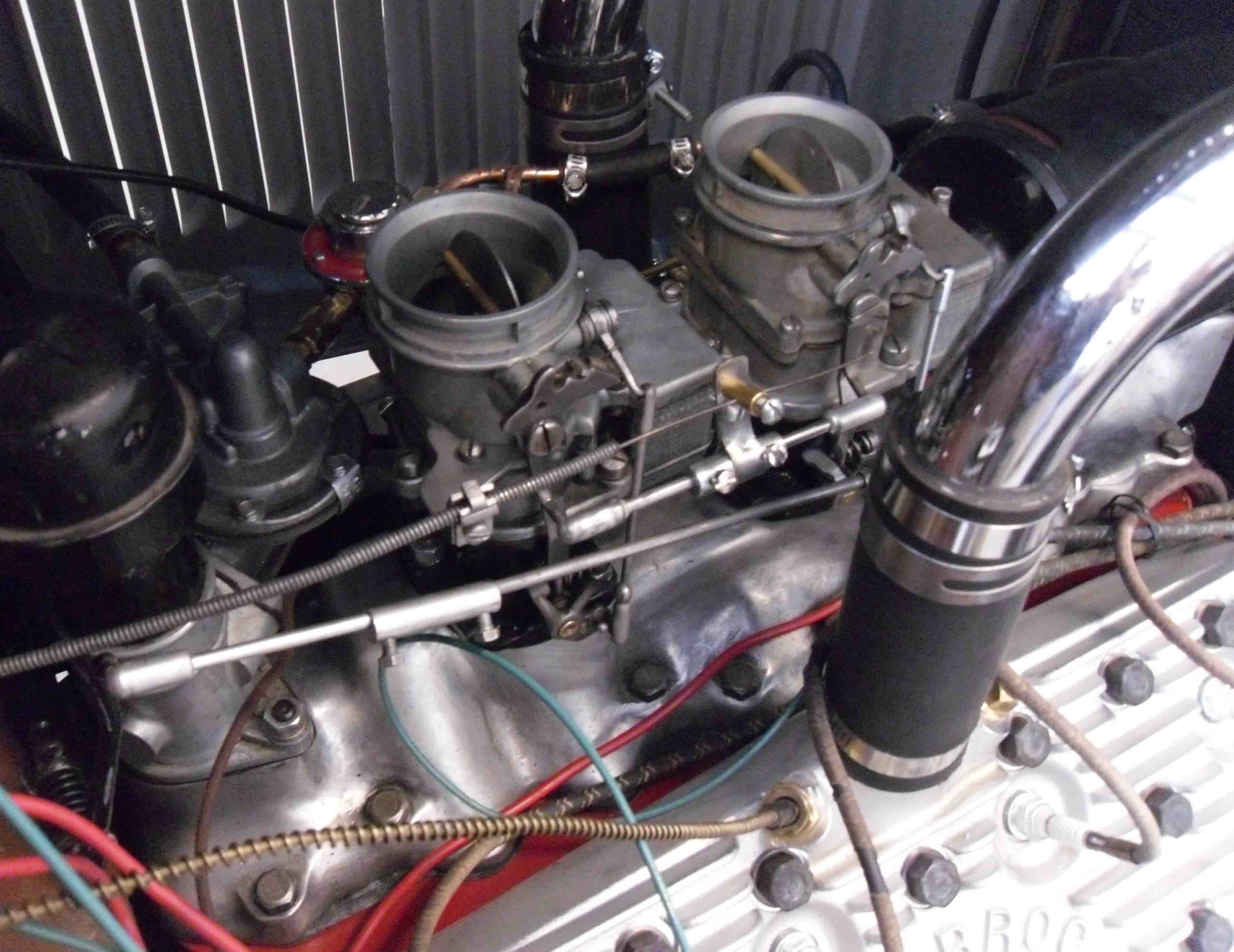

    Those are dual 97's (not progressive)on an Edmunds intake.
    I used copper line and brass fittings with one little piece of hose for the fuel.
    I used a choke cable from a '49 Ford with a Holley 94 choke bracket modified to fit the 97 and adapted a brass cable stop to a small bracket on the choke linkage.
