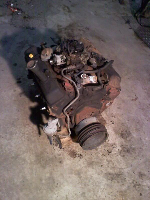

    I scored a 86 c10 pickup on craigslist to grab the 305 out of for my 65 panel. Here we are in my shop pulling the donor motor out of the c10.
    I'm getting some 350 heads tomorrow from a fellow HAMBer. I need to figure out which edlebrock intake to get and which Holley will work. And get some headers.
    The tranny in the truck was shot but I scored a 700r4 from a car for free. I just need to find the short shaft tail shaft.

    Got the motor cleaned up, the old 6 cylinder out and the v-8 in.
