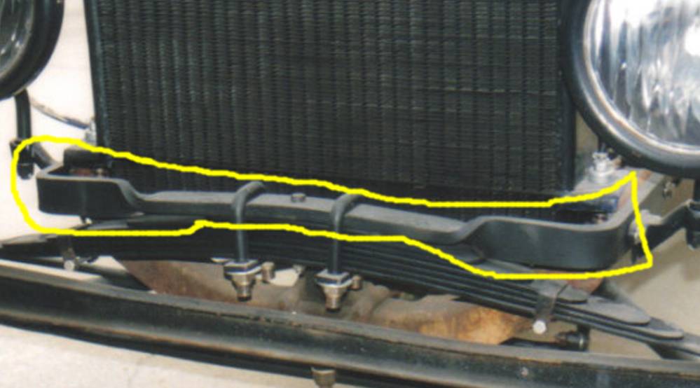

    I hate to say this, but that mount looks too weak to me...

    Hitchhiker
    Dude it's a T. It weighs like 1300 pounds soaking wet. It'll do okay.
  4. GuyW
    Joined: Feb 23, 2007
    Posts: 824
    GuyW
    It APPEARS to be bent already, tho....
  5. Hitchhiker
    Joined: May 1, 2008
    Posts: 8,507
    Hitchhiker
    I noticed that too.....
    But......
    Looks CAN be deceiving.:p

    Ted H
    Fellas,
    I don't think you realise just how strong steel is. Look at the surrounding parts. For instance, look at the perch bolts. and I am sure the bar was formed to conform to the shape of the spring. Had that been made of 1" plate it would have supported an 18 cylinder Pratt& Whitney Radial. And just so you know, I spent the last half of a long working like as a fabricator in heavy industrial steel fabrication.
    After all, the car lasted for decades.
    Now back to the cars.
    ted

  17. Hitchhiker
    Joined: May 1, 2008
    Posts: 8,507
    Hitchhiker
    So you think it's bent on purpose to conform to the arch of the spring?
    LOL! engineers....:rolleyes:;)
    Just kidding.:D
    seriously though
    How it mounts at the frame is what concerns me. Do we even know if it's bent or not? And from an engineering point, if it was bent would that make it more likely to fatigue in that direction?
  18. flyin-t
    Joined: Dec 29, 2004
    Posts: 1,652
    flyin-t
    After I built that front mount I heated the center of it and shaped it (tried to) to the contour of the top of the spring pack after it was mounted on the axle. I didn't want to stress the springs by tightening it to a flat surface, possibly breaking the spring.
    The car's been on the road for over 10 years like that and runs straight and true. I built in 7 or 8 degrees of camber too.
    Though it's no longer mine, the guy I sold it to drove it in the Pasadena Roadster Reliably Run a few years back and finished. Won an award for oldest engine!
    Outback likes this.
  19. MrModelT
    Joined: Nov 11, 2008
    Posts: 2,745
    MrModelT
    That's how I would have done it...conform it to the curve of the front spring, would give a larger "pad" area to mount to and would allow you to move the spring clamp U-bolts farther apart..both of which would make the front spring more stable. The steel stock he used looks rather substantial and if it was heated, bent and cooled properly, the steel should retain all of it strength and flex rather than becoming hard and brittle if it were dowsed in cold water immediately.
    I have seen my fair share of "rickety" modifications done with T's and a few period mods that would make even me a little nervous..but Flyin-T's setup is a real nice one, perfectly period and plenty strong.

    Thanks, I was shooting for a period look.
    I cooled the mount in oil after each heating.

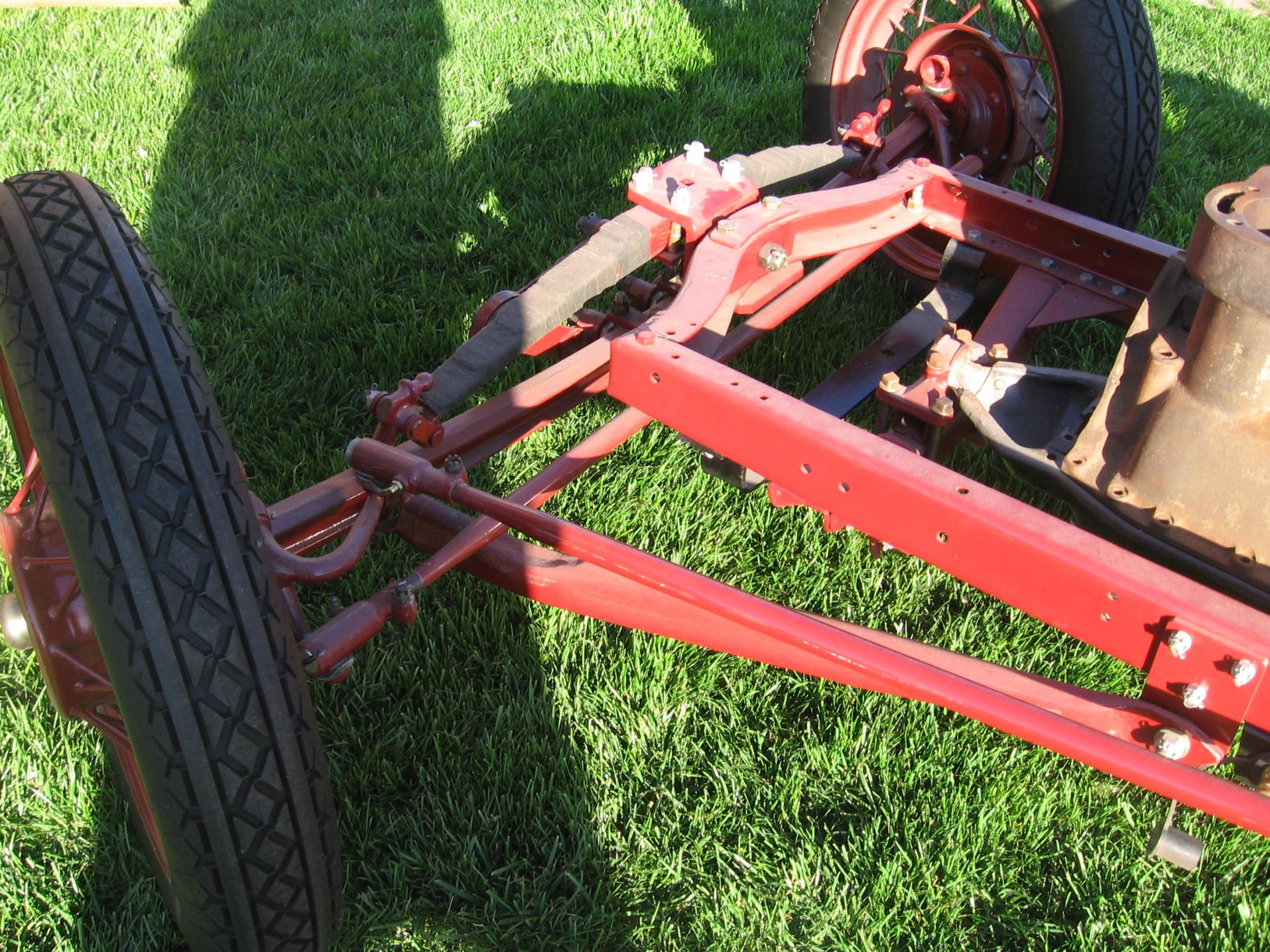

    Posted these before. You need to drill out the rivets on the Model T axle tubes and rotate them, moving the spring to the front of the axle rather than on top.
  23. MrModelT
    Posts: 2,745
    MrModelT
    You certainly nailed that one dead on!
    Cooling it in oil is an old trick that allows you to harden and cool the steel at a slower rate than with water since oil has a higher boiling point. I was always tought that with flexing or load bearing parts, such as suspension parts...it was better not to harden then like that, but rather to cool them slowly by placing them in an oven and slowly reducing temperature until they are cool
    so they retain their strength and flexibility rather than hardening them which could cause them to crack or shatter. Used that process a few times and seemed to work great....haven't had anything on the roadster break yet....knock on wood :D

  24. daredevilcustoms
    Joined: Aug 18, 2008
    Posts: 123
    daredevilcustoms
    from Ohio
    Found some pictures of the front end.
  25. MrModelT
    Posts: 2,745
    MrModelT
    I have seen this car or the same set up on another very similar car before. great design...was most likely an old dirt track car. The frame has been stretch 10 -12 inches using a T rear cross member and frame sections for the lengthening portions and the axle is actually Model A.
    Love the knee action shock set up though!

  28. fiveohnick2932
    Joined: Mar 29, 2006
    Posts: 916
    fiveohnick2932
    from Napa, Ca.
    The spring is suposed to mount to a flat. Because the spring has to flex upward and flatten. As it is now the spring doesnt have much free area to arc upwars into.
