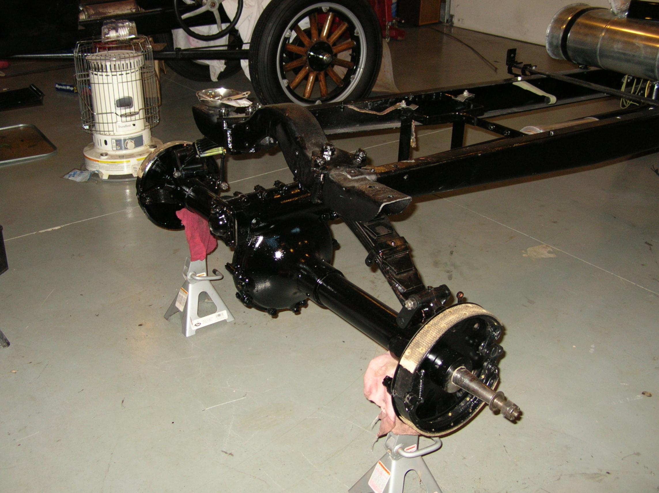

    It may be a home built job from the late 1930's or very early 40's....when T stuff was really cheap and even more plentiful then today.
    That is actually a stock large-drum '26-7 p***enger car rear axle....have the same one in my roadster :D

    Gosh, I thought the pumpkin looked to big for a T. I coulda swore it was a 3/4-ton Ford truck rear.
    Maybe the scale of the car fooled me into thinking it was bigger than it is.

    Naw....it's just a REALLY small car! :D
    The 1-ton TT rear axles are actually worm-drive and substantially larger:

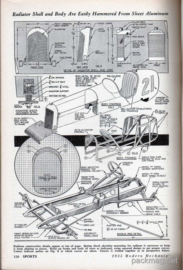

    "Radiator shell and body are easily hammered from sheet aluminum." Say, what?

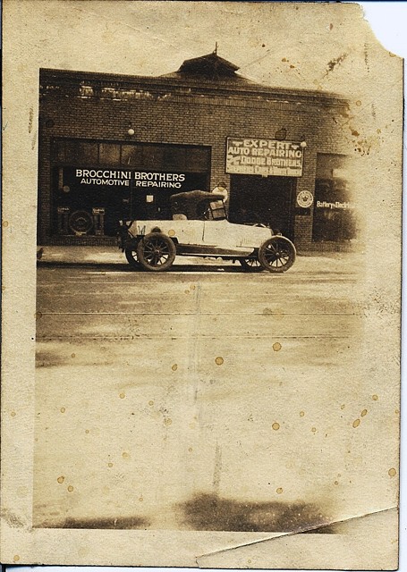

    Here's my grandpa in his little speedster he called "Lincoln Pup"....about 1925 or 26....my mom came along in 1927 so the car disappeared and he p***ed away the year after I was born. Wonder if it had a Lincoln under the hood.
    And his little Dodge roadster with buffalo's I think - I'm told he courted my grandma in...

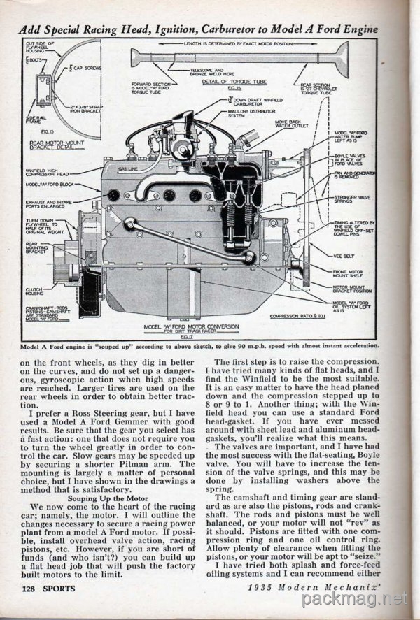

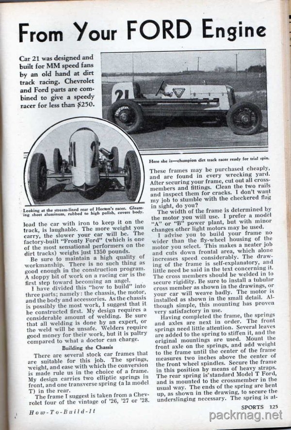

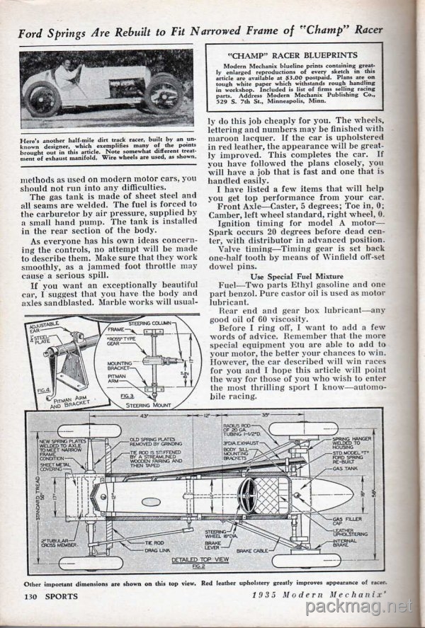

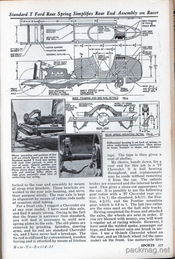

    I think this is the entire article.
