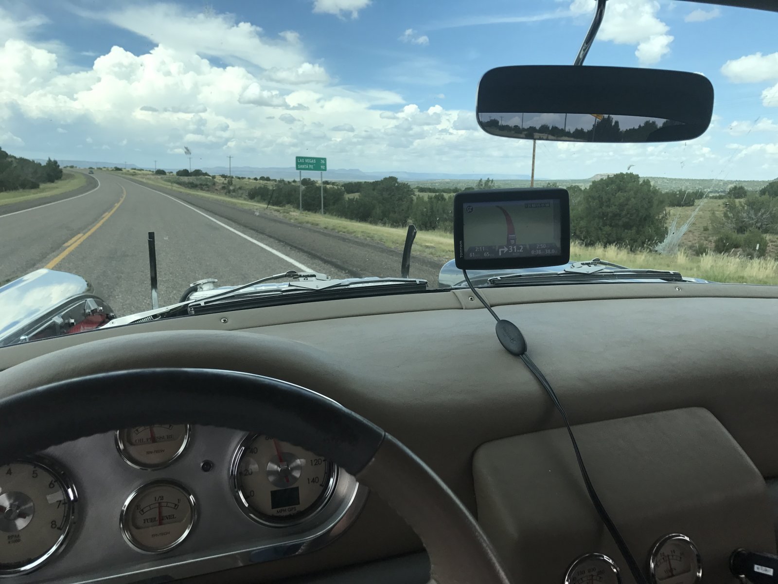

    I have an old Garmin GPS stuck on the windshield of my 30 pickup, it's been there so long I think the rubber suction cup is permanently adhered to the gl***, I'd probably have to s**** it off with a razor blade to remove it now. I hard wired the power cable in to the ignition switch so it comes on whenever I turn the car on, and automatically turns off when I switch the engine off. That's my speedometer, and odometer, when I hit 100 miles on the Trip mileage I start looking for gas; and reset it each time I fill up. Occasionally I still even use it for directions...

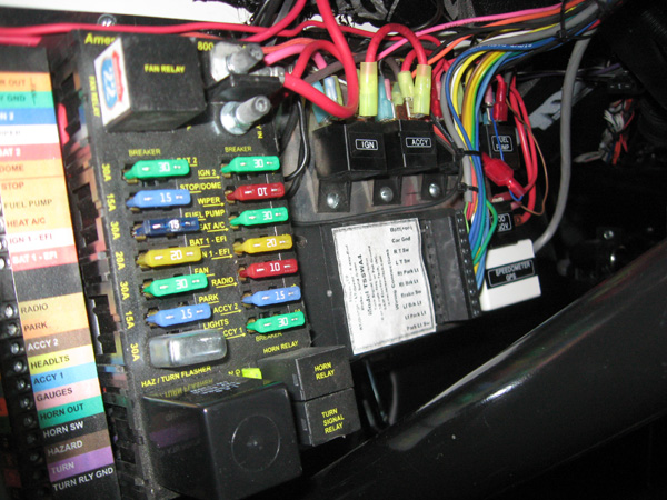

    I use a speedway GPS sender with a SW Wings Speedo in my forty coupe. It is very accurate. My sensor is located under the steel cowl. It is slow to find satellites when I back out of the garage. It may take 5 minutes or 3 miles to start working. The other concern is mountain p***es with steep cliffs or tunnels. It usually just shows the same speed you entered the area with until it establishes contact with the satellites again.
    The GPS is mounted on the electrical panel under the dash.
    When I compare the accuracy of the speedometer to the Garmin I usually use for longer trips they are both reading the same. I recently installed a world cl*** T5 5 speed in my 40. I tried to use a pulse sender with that transmission but it did not work with my SW speedo.
    Would I recommend using GPS? Yes.

    Thanks for pointing that out. I have the same for my 3w 32 project and was wondering if or how the sensor could see the satellite through the steel body, not that I care too much on the how (but remain curious nevertheless) but good to know the answer to the if.
    Incidentally, your panel amused me as it reminds me of a particular pet hate of mine! Why when using a supposedly complete wiring 'kit' is it necessary to add on all manner of additional, seemingly basic, items, such as that pictured? Most annoying but you've covered it nicely.

    Well If I wasn't so **** about circuit protection it wouldn't be so full of extra stuff. There is even a panel in the trunk for a few things located back there. That big black box on the under dash panel is for a turn signal kit ( I am using a stock steering column) . If I had used a modern column I could have used the circuits in that fancy fuse panel;).
