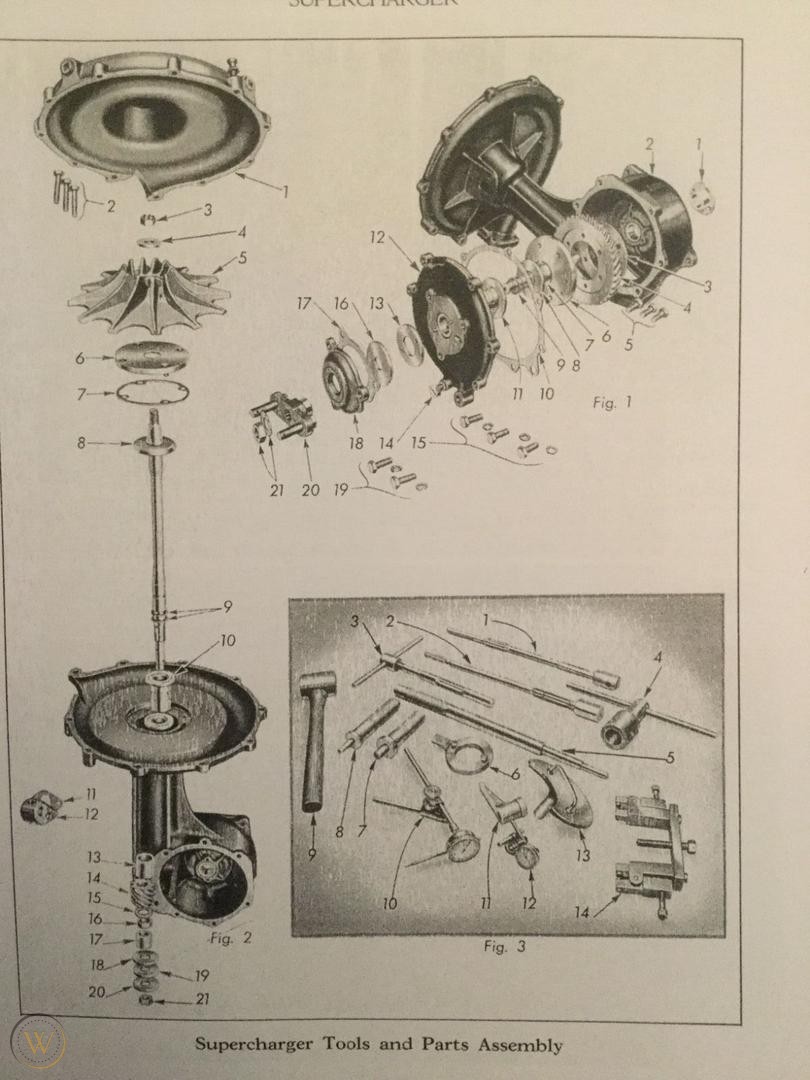

    Just bought a Graham supercharger with the intention of fitting it to a model A banger, so, got it all stripped down and thinking I am missing a few parts ……
    I have searched the net and the forums on here and am struggling to find any exploded diagrams or manuals ……..
    Has anybody got any manuals/diagrams etc etc……especially of the oil pump side as that is what I think I’m missing………or any body got any photos that might help?
    Many thanks guys.

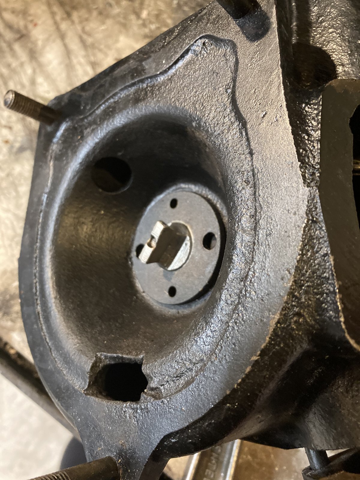

  12. harryhotrod
    Joined: Jul 14, 2009
    Posts: 26
    harryhotrod
    When I took it apart and pulled the rear cover I saw this shaft with what looks like it should drive something,………………strange way to finish a shaft that does nothing…….or maybe it does?
    Any input/advice on the internals of these things would be greatly appreciated. 7A965EFF-9F9C-4D00-AEA5-12D982025A73.jpeg
