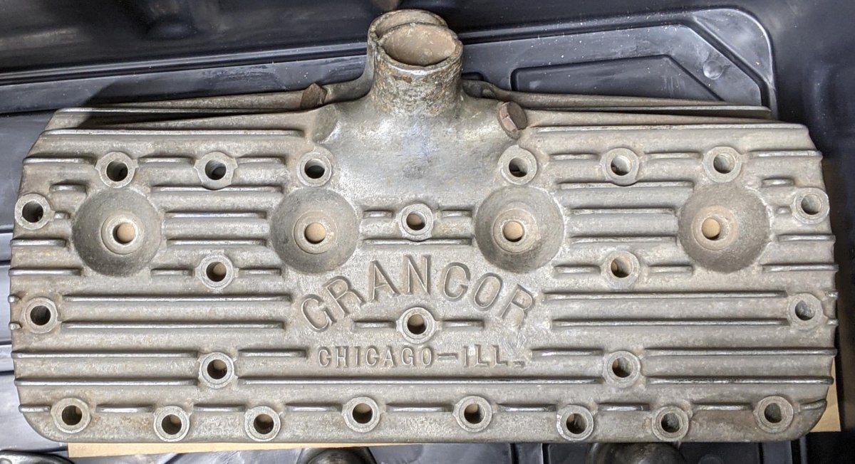

    Your second to last picture shows that there is still an offset between the back of the water outlet and the sealing surface of the head. That would seem to indicate that these heads have not been ,milled to an excess.
    All in all they look pretty good to me. The first set I saw were on a friend's '50 Ford (he named it "The Stray") in 1958. (He also had dual carbs; since all I had on my '51 was a Mallory dual point conversion, I was very impressed.)
    chryslerfan55, loudbang and catdad49 like this.
  2. alchemy
    Joined: Sep 27, 2002
    Posts: 22,777
    alchemy
    They have been milled though, you can see the dome is much smaller than the original size, about 3-3/8".
    loudbang and alanp561 like this.
  3. tubman
    Joined: May 16, 2007
    Posts: 8,255
    tubman
    Don't take this the wrong way, but do you actually know the original diameter of the combustion chamber in a GranCor head?
  4. alchemy
    Posts: 22,777
    alchemy
    No, but all the other aftermarket heads I've seen started out with a diameter close to a stock Ford cylinder. Might not matter if there is still enough clearance to the pistons in the engine they go on.
  5. tubman
    Posts: 8,255
    tubman
    Yep, foil balls.
  6. Hemi Joel
    Joined: May 4, 2007
    Posts: 1,655
    Hemi Joel
    from Minnesota
    I picked up a set of Grancor heads off Ebay in January 2015 for $777. IMHO, Ebay can be a good indicator of a parts value when it is exposed to a large pool of buyers. Mine are slightly different than yours, and in slightly better condition

    If those heads were mine, and I was concerned about the surfaces of the water outlet ports, I'd not even bother with a machine shop. I'd take a flat mill file and back file the surfaces. It wouldn't take but just a few strokes and they would be shiny clean and flat. And, if that wasn't clean enough, new gaskets and a liberal application of #2 Permatex would solve the problem. Those deserve to be on a running engine.

    The consensus seems to be these are repairable/useable and as a swapper for many years I know this is the cardinal sin but were should these fall in a price range?.. And I know the next sin it telling someone that price.... But, they do need to be in a running engine.

    If those heads were mine Id place them on my engine with no gasket loose held on with 2 bolts loose and roll the engine by hand. If the combustion chamber cleared the lift of the valvles id run em. I dont see anything in those pictures that would deter me from bolting those right on. Ive seen way way worse heads run without leaks.
