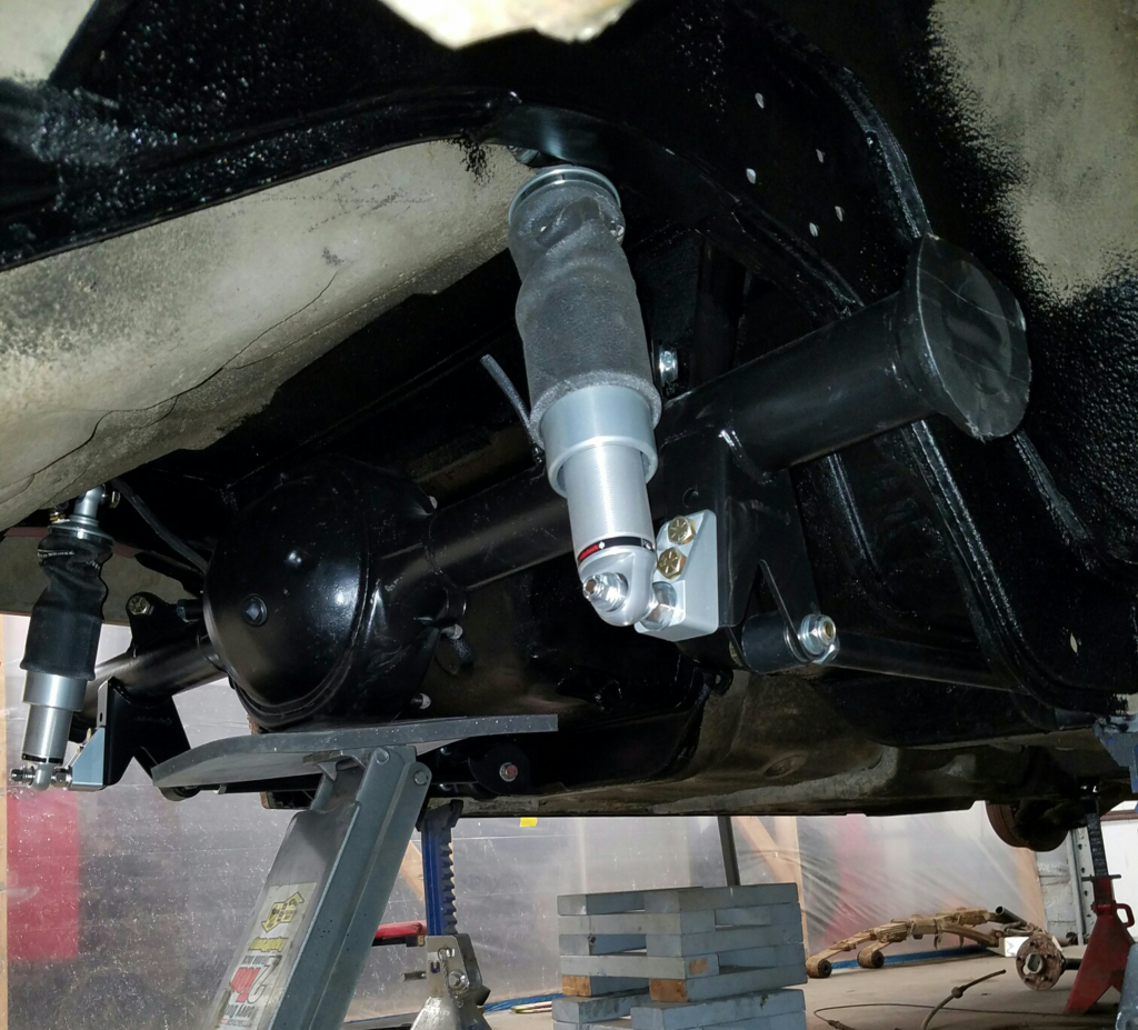

    Spent New Years eve cutting and modifying a universal 4-link kit I got from Ridetech. I also have all my Ridetech shockwaves now.

    I'll post some more detailed pictures of the new suspension after I get everything fully welded but here is a cool picture I took today with all the new 4-link bars tacked in. No shockwaves were installed in this pic so I'm not sure if it will sit this low but so far everything is tucking nicely!

    Here's my new rear suspension welded up and ready for paint/powder coat. The curved bar will get welded between the frame rails. It's based off the design Ridetech uses on some of there kits and at least one other bullet bird I have seen done similar.

    Here's how I beefed up the unibody with 3/16" plate where the shockwaves will mount.

    I hit the undercarriage with a wire wheel and slopped on some black rustoleum for protection. The suspension parts are either painted with SEM trim black or powder coated.
