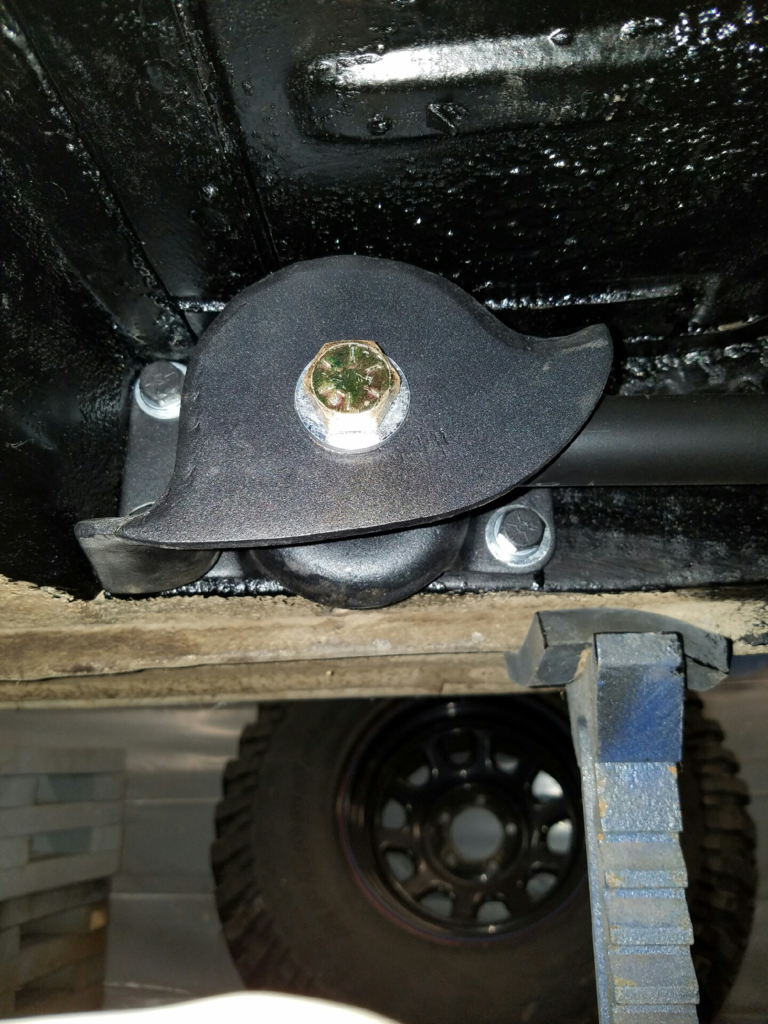

    Modified the original leafspring mounts to accept the new lower control arm.

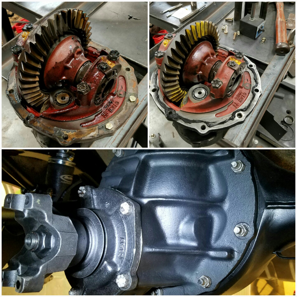

    Just a quick update to keep me motivated. Rebuilding all the suspension and rear axle is kind of dragging out longer than expected. I rebuilt the Ford 9" third member with new bearings and seals, kept the original 3.00 gears for cruising.

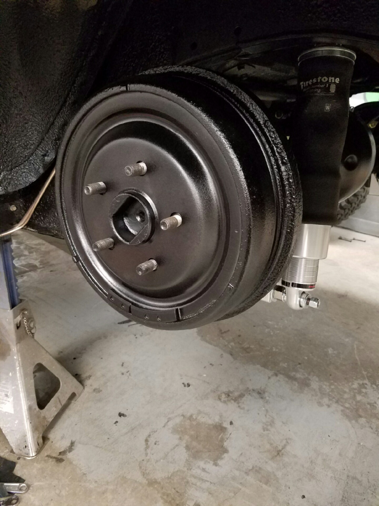

    Disk brakes would have been nice but there's just too much to buy right now. Original power ***isted drum brakes were rebuilt, ready to put some miles on.

    Fitted the front shockwaves to the upper control arm after a full day of fabrication. While the suspension was apart I sand blasted and powder coated almost everything. New bushing, bearings, and seals. Still need to run air line and wiring.

    The 4 wheel power drum brakes stop my 'Bird just fine. I had my booster rebuilt, & replaced the wheel cylinders, shoes, & the rubber hoses- no regrets.

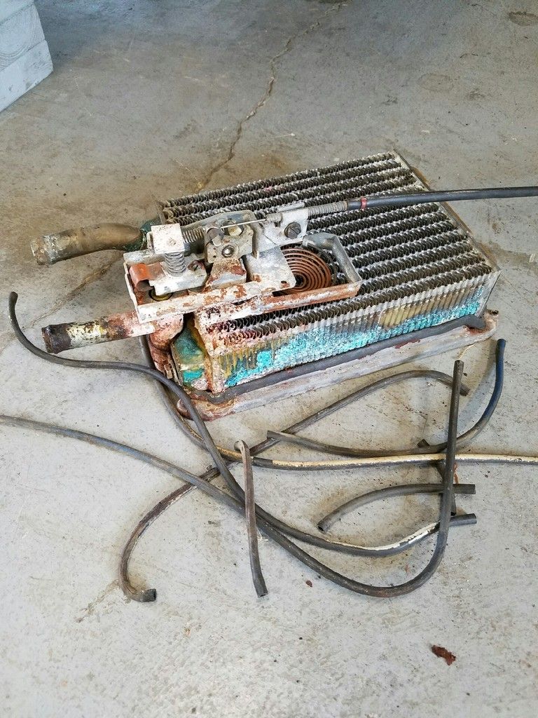

    While most of the interior is out I'm trying to sort out the heater/air conditioner. After sitting 42 years I don't trust anything that has coolant in it. I ordered a new heater core and replaced all the vacuum lines on the heater box.

    One question, did you have to change the length of the lower link bar to use the stock spring mounts?
  23. GNon18s
    Joined: Jan 13, 2013
    Posts: 58
    GNon18s
    from Pa
    I shortened both upper and lower 4link bars that came with the universal ridetech kit
