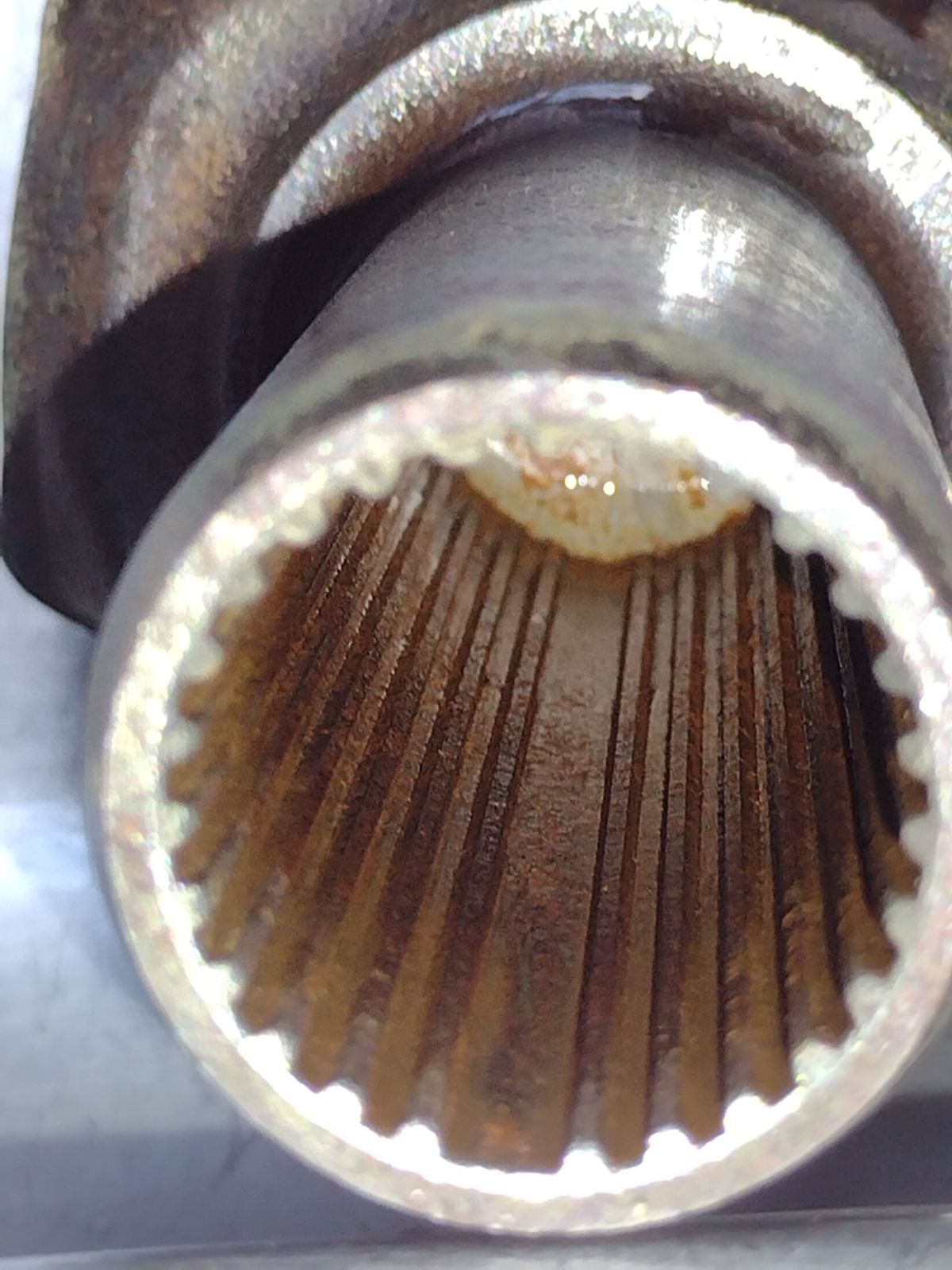

    So I am in the parts collecting/prepping stage of a transmission swap project for a '56 Chevy.
    The cast iron power glide does odd things at times, slipping, jerking, flare up between sluggish shifts and leaking. I rebuilt a fresh TH350 a couple winters ago prepping for the day when the powerglide finally gives out. My plan is to use the original driveshaft with a conversion u-joint and a yoke from a mid-70's malibu driveshaft that i have on hand.
    Luckily, i tried to test fit the yoke in the transmission and discovered it won't slide in and out.
    At some point, it sat outside and the splines are rusted. See attached photo.
    My first plan was to sand blast it, but getting pelted with all the ricochet sand grains didn't seem very appealing.
    Next plan was to soak it in PB blaster and clean it with a bottle brush. Soaked it for almost a year. Didn't help enough.

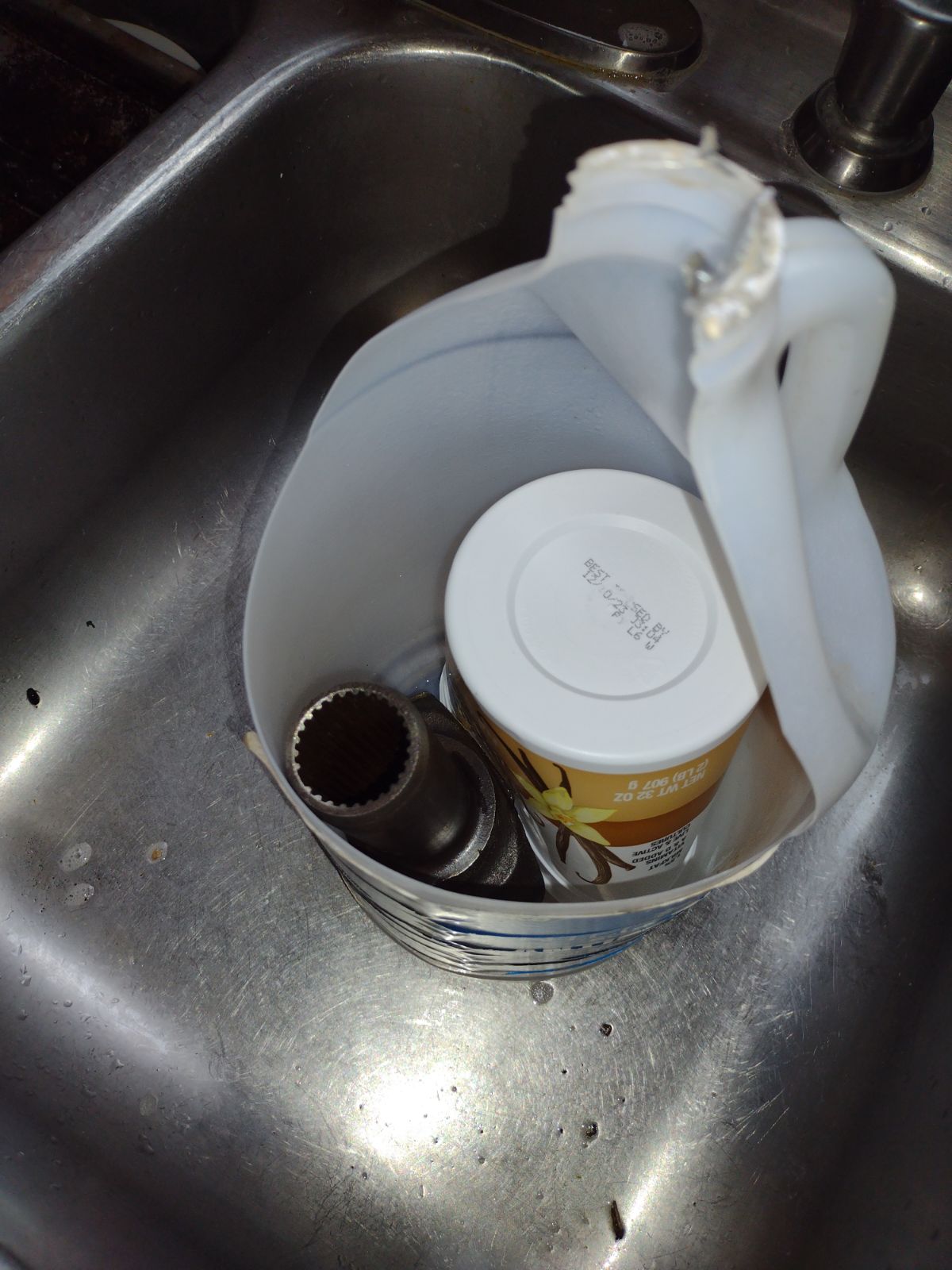

    My plan is to let it soak for a month and post the results. See 3rd photo.
    Small jar of mol***es was about $4 at local store. Used about 1/4 of jar to fill yoke.
    There was talk of gingerbread men with the remainder. spline rust.jpg Gr M jar.jpg

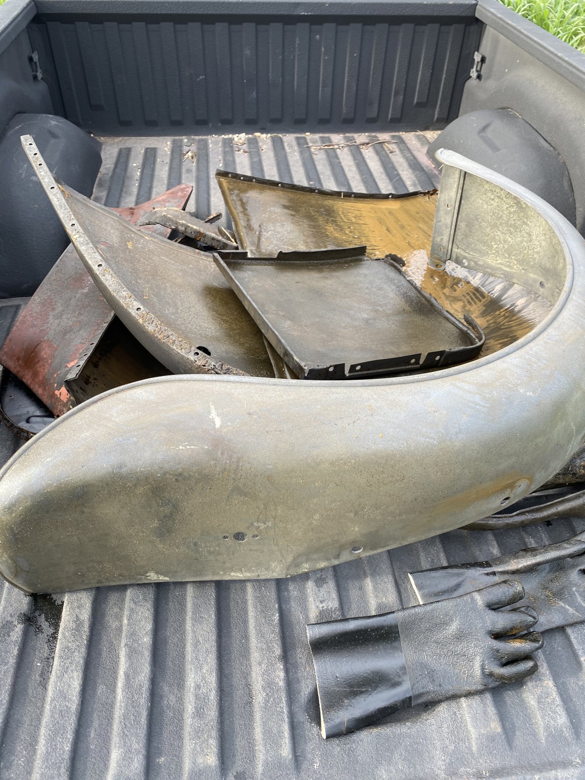

    This heater was in very poor condition, the doors were completely frozen shut, then the doors were so thin they would bend if trying to force open.
    I let it soak for 2 weeks in a 25 gallon container out behind a shed in the deep part of the property .... it does smell.
    The shell came out of the dip with shiny metal & the doors, defroster flap worked smoothly.
    I remember reading it is not recommended and can be harmful to machined surfaces such as cylinder bores or bearing races .... sheet metal or body parts etc it works great.

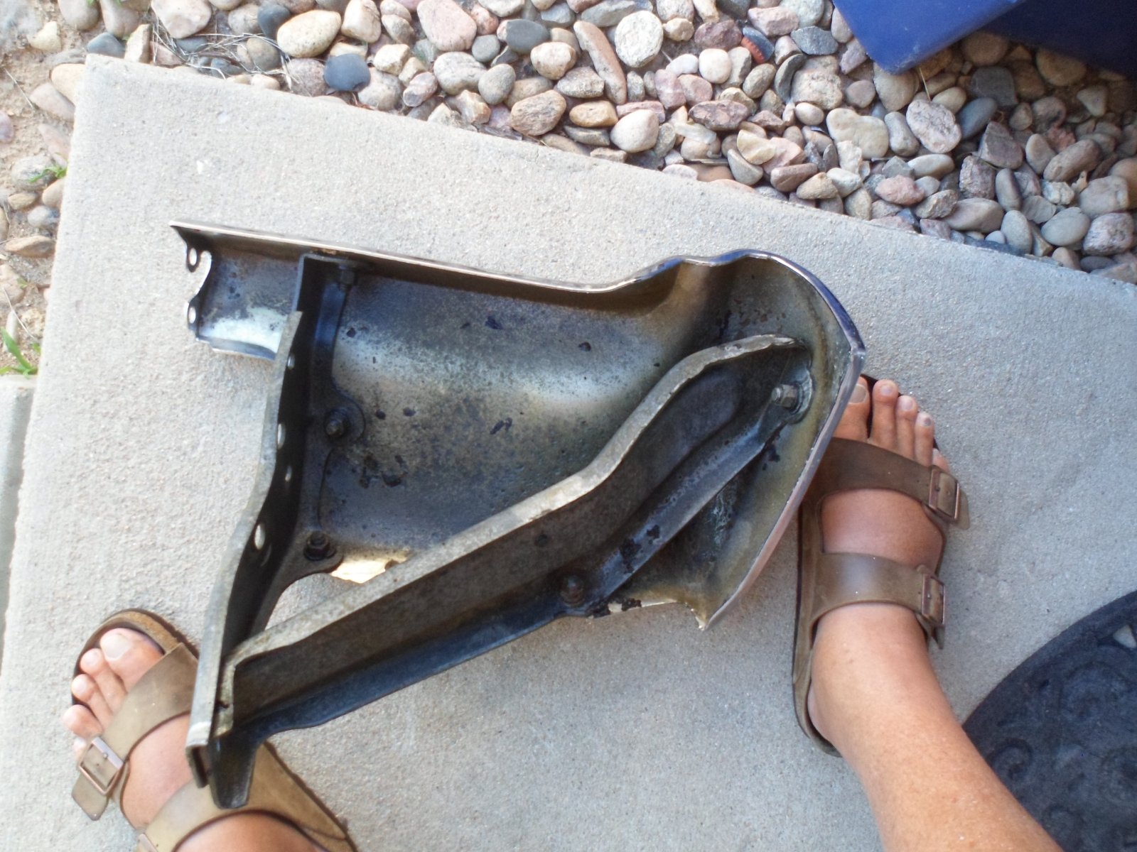

    Yep, before and after on '64 Chevy bumper ends...soaked for a couple of days in Citric acid bath...

    Update day 1: no noticeable difference in my sample area.
    Follow up on comments:
    The PB blaster soak and s****ing with an old screwdriver got it to the point that i can tap it in place and tap it off.
    I haven't been around feed mol***es in many many years. My memory is that is really thick. Baking mol***es is thin, almost like maple syrup.
    After I paid a lot for a conversion u-joint, I discovered that modern spline yokes for the stock u-joint are available.
    I plan to give this at least a week before doing something else. White vinegar or pepsi would be in line with the kitchen theme.

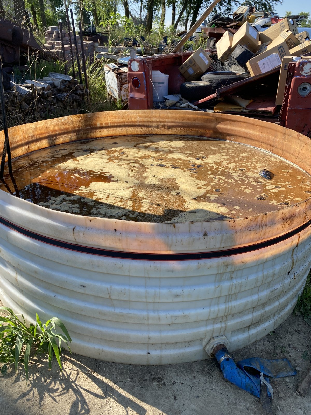

    Three guys went in together and grabbed a free large hot tub that no longer worked.
    They stashed it in a old barn and filled it with mol***es. They were able to dip whole doors and fenders all summer long. ..... When they were through with it and dipped all they wanted, they dumped it out in the back pasture .... it works as a form of fertilizer also, so they got double use from it.

    I have experience dipping stuff in feed mol***es. Works well in warm weather but will take a couple weeks. I will not dip anything with machined surfaces due to the stories of etching of them.
    down-the-road likes this.
