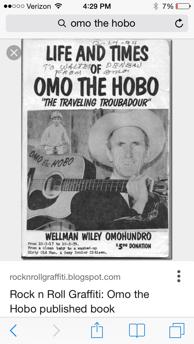

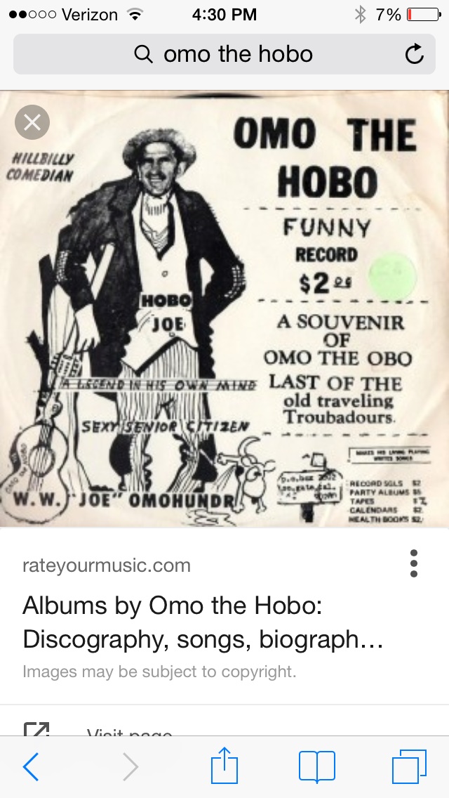

    Just a side note here, but when I saw those timing tags and your G-Pa's name it triggered an old memory from the 80's when I used to play in a cl***ic rock band. We had a regular gig at some bar down somewhere in LA Co, I don't recall where it was. But there was this guy that would come in all the time, he was one of those 1 man band things, played guitar, harmonica, had a drum strapped to him and cymbals and he would come in and play a few songs for "drinks and tips". We loved him. He called himself, "Omo the Hobo", even had business cards. His last name was Omohundro. Like I said, we loved the guy, and we always welcomed him in and gave him some time to do his thing and had drinks and laughs with him. We even wrote a song about him, "Omo the Hobo", I don't recall any of the words except the hook line "Omohundro he's our man". The main riff in the song was something along the lines of Welcome To The Jungle, but was many years before GnR came along. We'd always get a big smile on our faces when playing that song, nobody knew what the hell it was about, but we did.
    Anyone in your family play guitar and sing? It's not a common name.

    LOL, that's awesome that you've even heard of him! The name of the band was Rockslide, of the 4 members I lost track of the drummer, the other guitarist Matt died unexpectedly last year, and b*** player Keith is still alive and kicking. He's also a car guy, but not traditional hot rods, he's got an MGA w/ blown SBC, very nicely done and win's a lot of "best of show" awards, but not HAMB friendly.
  11. Thaeion village in Downey. Is where rick played with Jim seal. He says omo was more of a comedy gig then playing real good music. Same as you say he was fun to hang out with. Says he was real nasty with his jokes. I'm talking to rick about him right now as we work with each other on Thursdays.

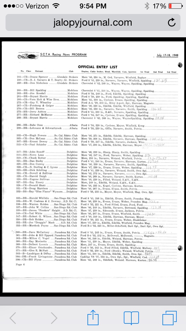

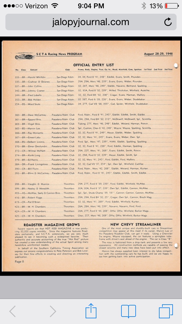

  14. image.jpg image.jpg Ok now we can get back to some hot rodding. We got alittle out there woooo it's easy to get lost. Check out these programs. You can see with in one month he built a hole new motor and went out and ran it.in July he ran a 1936 motor at 242 cubic inches with ford filled heads edelbrock intake Winfield cam and a Mallory ignition. Then just one month later he had a 41 ford motor at 238 cubic inches with ford heads edelbrock intake Harmon cam and Spaulding ignition.
    kidcampbell71 likes this.
  15. Then he went to a 42 merc motor than a 46 merc motor. Pretty neat I sur hope we can find more programs to tell us more about him. Fingers crossed

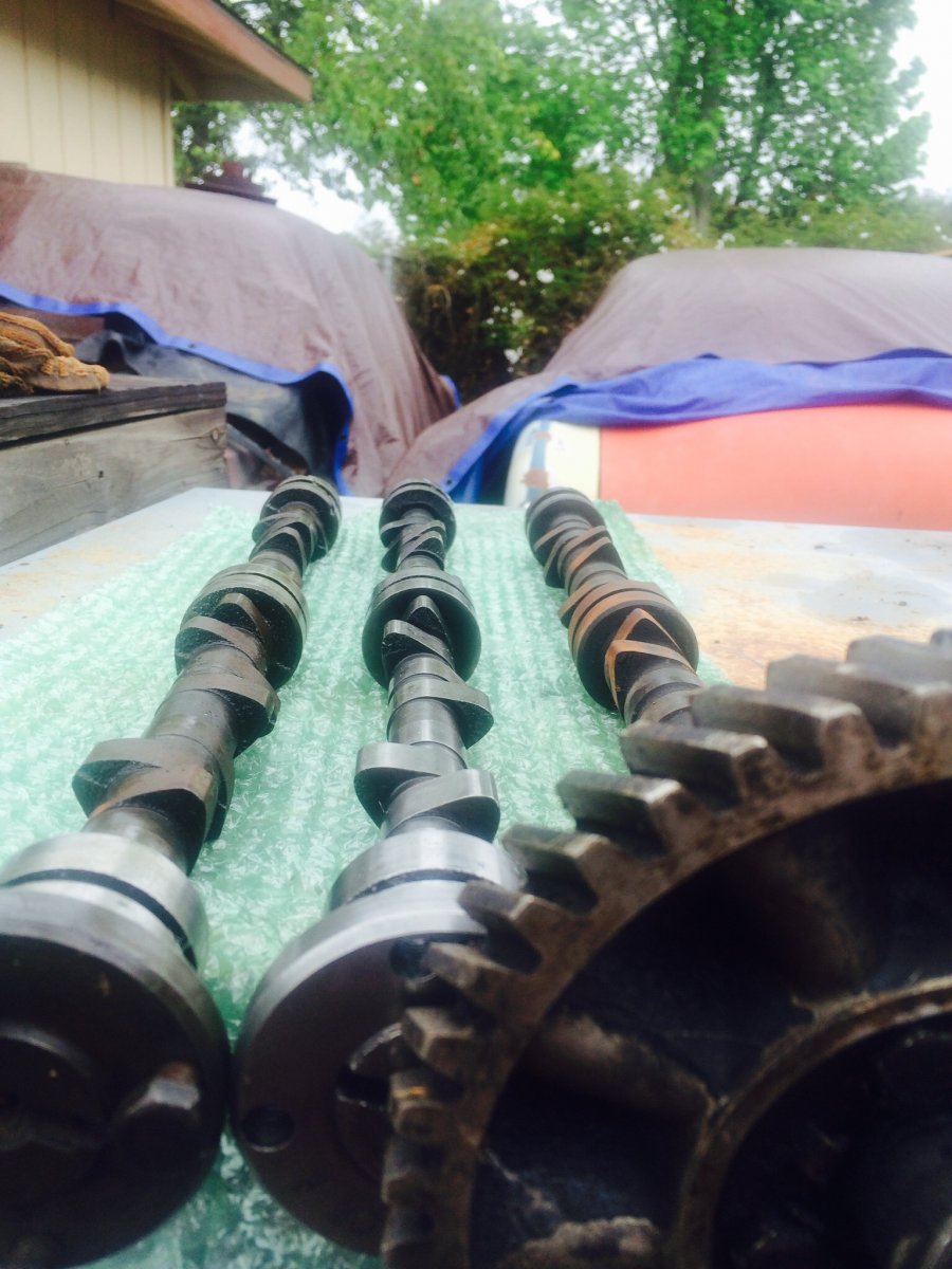

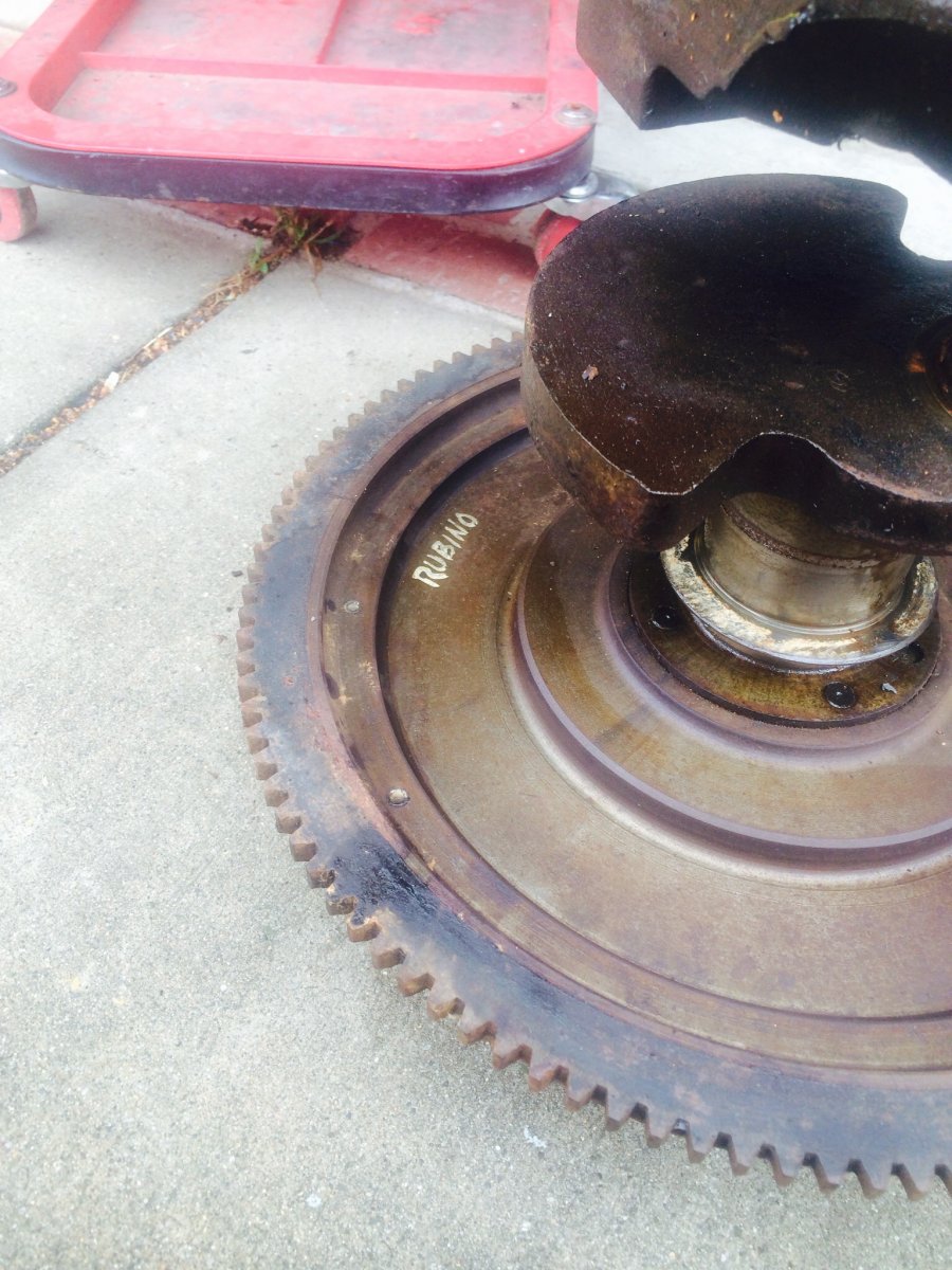

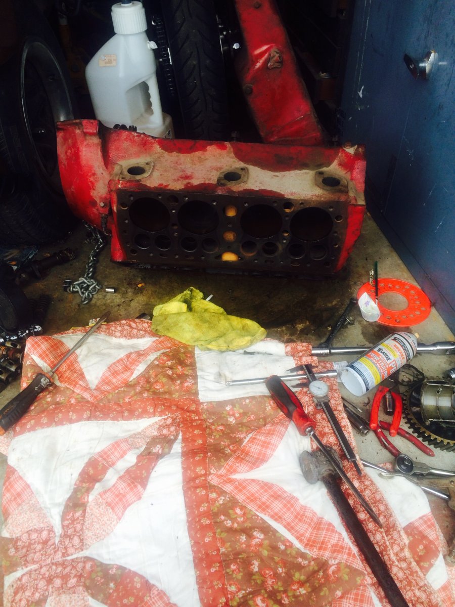

  20. image.jpg image.jpg image.jpg So the motor I bought last weekend looks like someone built a nice motor. The flywheel looks to be lightin and the cam looks like a stock cam that has been custom ground. I could not find anything wrong with it bearings and so forth. It was missing one valve and spring but still had all the adjustable lifters. One spring was weak so I'm thinkin maybe the springs couldent hold the pressure and got weak so they took it out. I bought it from a 76 year ol lady who's husband had pasted away a year ago so her and her son have no idea about the motor. I wish I could of looked around for the heads and other missin parts but she didn't think there was any. He was an ol hotrodder so I'm sure the rest is their but I didn't want to presure her into letting me look. I'm gonna call her when I hear back from the machine shop and see if I can talk to her son so we will see. So the cam in the left is the one from the motor. The middle cam is a Howard f10 and the one on the left is stock. You can see the left cam is ground flatter than the others.

  23. image.jpg Here's my custom engine tear down bench. I custom made it out if a old garage floor.:D:D

    Look at the tops of the lobes!
    Crazy duration at peak'ish lift. I want to hear that run.
  25. That's what I'm talking about and it's bored to 3-3/8. I bet It crackels like hell plus the lite flywheel. I think they stretched the springs so they pulled the motor as I can't see anything else wrong but machine shop will tell. It's getting cleaned mag'ed and sonic tested. I'm gonna run it if there's at least .100 wall thickness. And if the bores just need a quick hone job. I could save a lot of money if this motor is just a clean and rebuild as to a full machining job. Clean it up new bearing and rings. It's a 3-3/4 stroke and I do have a 4" merc crank so... Do I want 268 cubes or 286 cubes. It also has silvolite pistons with 3 rings. Maybe I'm just lucky or the hotrod gods know it's my time so they just keep throwing good stuff at me.

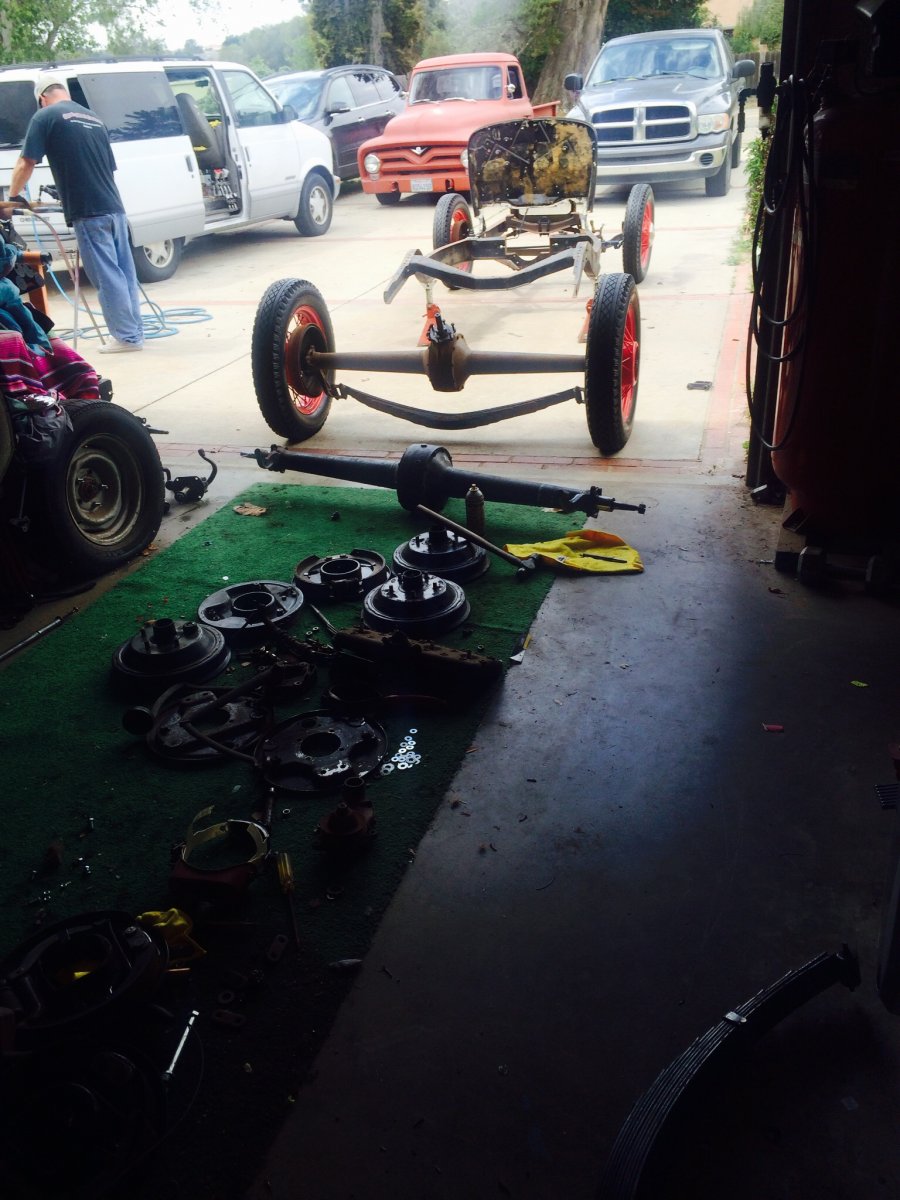

  29. image.jpg Hard at it. Putting the good ready to run rearend in and brakes painting all of it black lacquer of course. Got a good buddy over to help.
