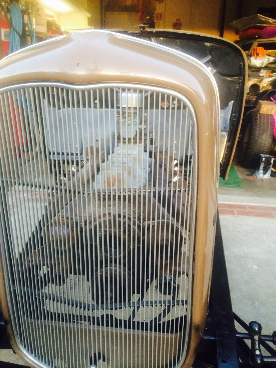

  2. image.jpg image.jpg image.jpg image.jpg image.jpg So I got a few more things DONE!!!! My youngest hotrodders wire brushed the front end then painted it. We didn't sand just cleaned it up and shot the black lacquer over all the old paint so you can still see all the old chips and scratches. Had a friend over on sat and put in a full days of work too. He rolled over in his 55 f1 then put down a nice burnout on the way out thanks for all your help mark. Those are grandpas great grand kids putting in work there. Also finished up the brake/clutch box new bushings and all gas welded back up gonna finish the cuts on k member tonight so the trans will fit with pedal box in also got all the new brake lines to run so hopefully I will get the front done tonight too. I called brookville today and the deadline to order for the Lars is end of next week. So I'm going to go up Monday and check on the real Henry body. Maybe a fairy tale but we will see. If it turns out to be a bad leed then brookville here we come. I will bring the ch***is to Lars if I can't get the real body so be ready to help put the body on if your there. Gonna need some help lifting it up and on. Also gonna have grandpa there to hopefully.

  5. So I'm thinking about the exhaust now. What's the common size for flatheads. I'm gonna do the same as grandpa did with dumps under doors and run the pipes and mufflers all the way back. Wondering what size tubing I should use. Like 1-3/4 or 2" ect.??? ThAnks

    Again I don't want to hog up your thread. I've been thinking about your exhaust for days but didn't want to bother ya. I ***umed you were doing it like Gramps cause his was so *****in under the frame rails.
    I was thinking you should talk to @383duece about this one. He offered me a 35-36 style drive shaft to finish my lake style drive shaft exhaust pipes cause it requires two to make it back behind the rear doors on my longer ch***is. I just needed to pay him shipping(there are great people on the HAMB). TonyMartino just sent me some cut up pieces that match my pipes "patina" well and mine will be complete and still look like they came out of my wife's grandfathers barn.
    So instead of me paying shipping to have Dennis ship to me then I ship to you, just talk to him.
    As for 1.750 or 2.0 out the back? Hell I don't know.

    They were 1-3/4".
  9. No worries shine. Say what ya gotta say.:)
  10. Thanks mike. I figured they weren't using anything bigger than 2 inch

  21. image.jpg Damn I got two many holes and not enough carburators. No one want to help with a early dual edelbrock so maybe I will just punch my motor at the machine shop a 4-1/8 stroke and keep the 3-3/8 bore and run this 4 carb set up. Jet the carbs down alittle and run it. I put this one in for now so I can finish up the brakes. I got a steering coloum coming from a hamber hotcoupe. So I will be able to finish up steering as well. Can all you hoaders help a brother out. Stop just staring at it in your garages. It's going to a good home.:D:D:D Also gonna get the exhaust done too. How about my under firewall oil pressure gauge... image.jpg image.jpg image.jpg image.jpg

    You will need to run 81's if you try to run 4 carbs.....

    Im running four 81s on a evans intake on a stock 59ab with strait linkage and had to upjet about 4 to 5 steps, runs out really good too, so when i put my big motor (only a 296) i will probably switch out to 4 97s. itll take downjetted 97s with progressive linkage probably just find....in my opinion
