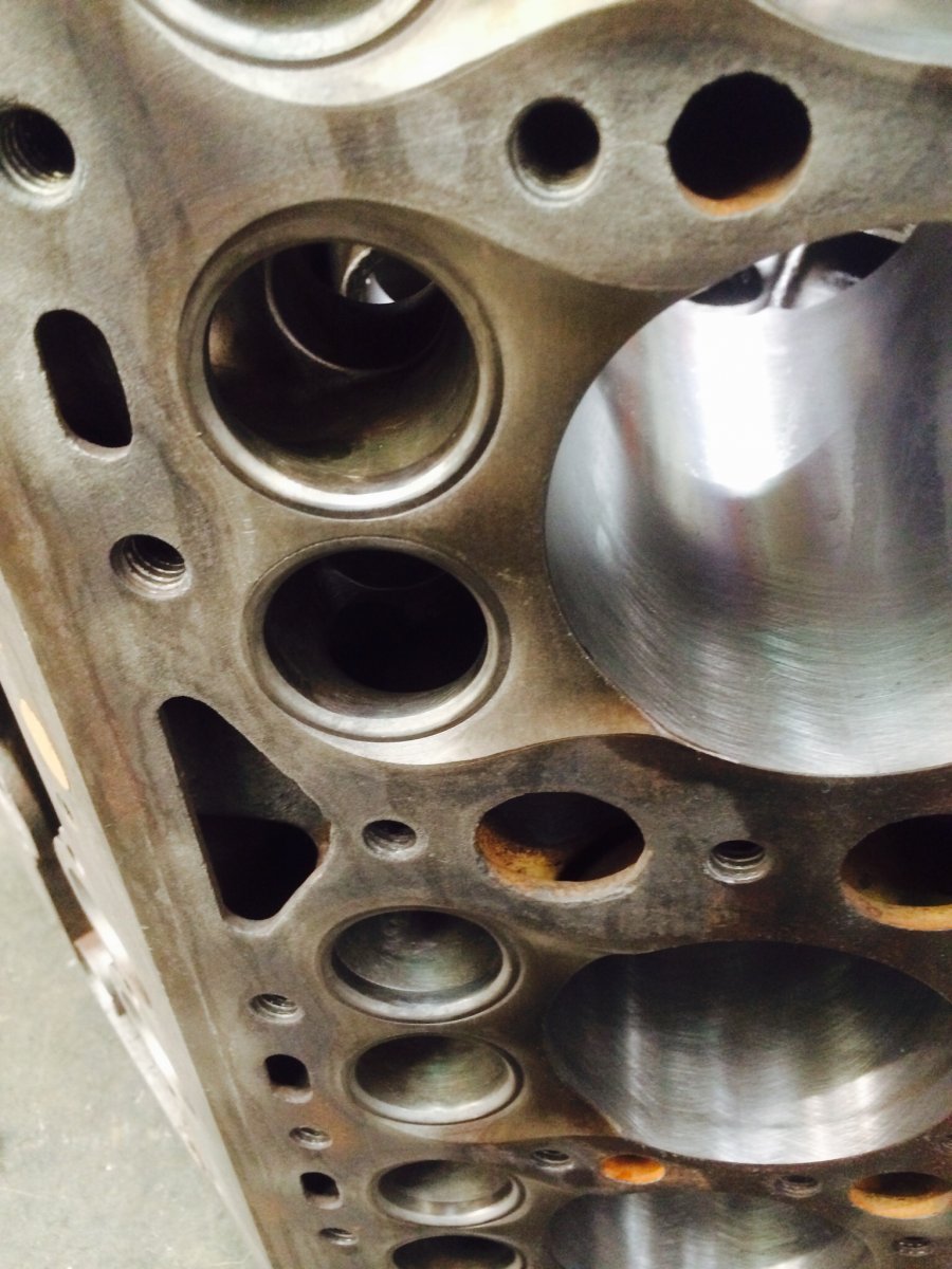

  13. image.jpg image.jpg image.jpg Just got back from machine shop. It's the nicest block they ever seen. It's been balanced ported relived and the 3-3/8 bore cleaned right up. Average wall thickness from sonic test was 132 thousands. So lucky duck I am. Someone spent a lot of time building this motor. I got it for 200 and saved a ton on machine work. One little crack in between the head stud and water jacket. Just one. That's normal though.

  15. woodiemike
    Joined: Jun 19, 2010
    Posts: 383
    woodiemike
    Hello Bruce;
    Awesome news on the block. That will defiantly save ya some coin! You have mentioned the books by Don Montgomery. My advise would be to get them if you can. They are well worth the money. Wealth of information in all of them. I have a couple, but have not seen a picture of your Grandpa's car yet. On that note though, I have scanned a page out of Don's book "OLD HOT RODS S****BOOK". In the top right hand corner is my Dad [#430] with what I believe to be your Grandpa standing there talking to him? Maybe the next time you see him you can confirm that. As always, take care, and keep up the great work.

    Nice score on the block. Lucky duck you are.

  19. This hole build has been of luck. Did find one of the piston ring grooves broke off. So that might be why it was torn down. So I got to buy new pistons. Anyone got any 3-3/8 bore pistons. If I got one silvolite I could still use them and save money as long as it was the same part number. I might just buy a set of Ross. Don't know if I need forged pistons though.

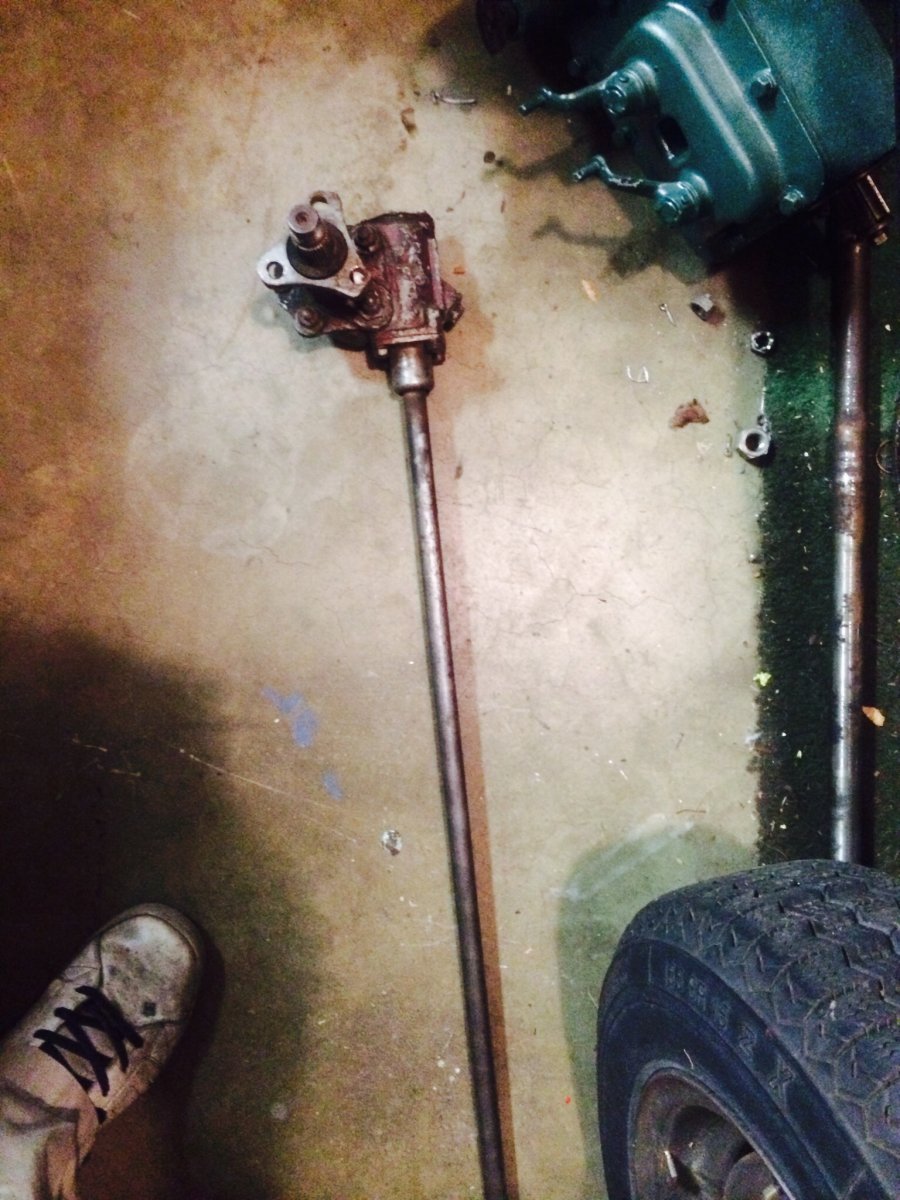

  20. image.jpg Got a 32 steering box today from a fellow hamb member. Thanks tom. Also missed a call from the guy with the body. He asked to call him in morning so pray for me...
