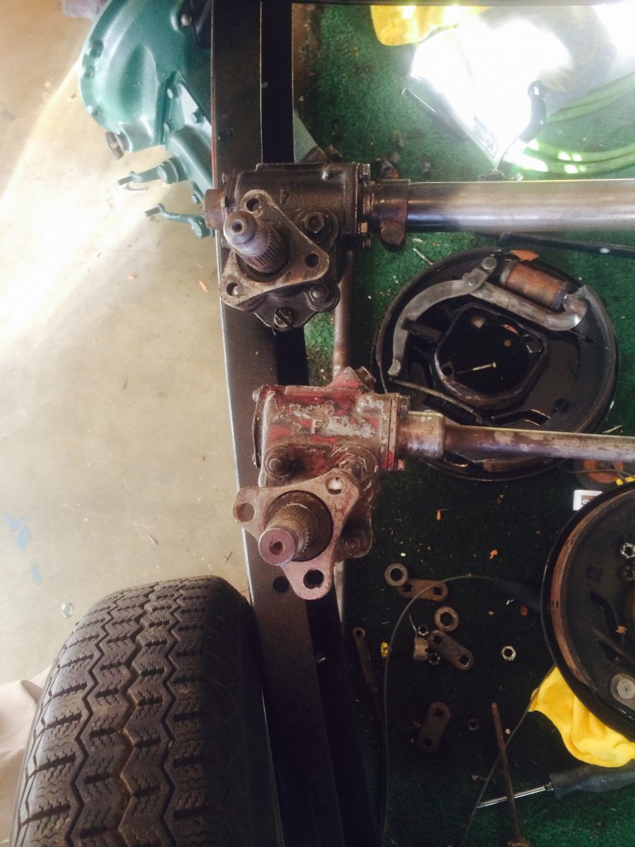

  1. image.jpg So here's a question. I now have a 32 steering box and have had a 34. I know the 34 steers better. Can I just change the flanges that bolt to the frame. The pit arm shaft looks the same length. I will measure it all up tomorrow if nobody chimes in

    Everything I have read says that you can just swap the flange over from one to the other. The '34 should be 15:1 ratio, which is why they steer better than the 32 box which is 13:1.

    Joined: Jun 20, 2010
    Posts: 1,458
    KKrod
    I like the '32 with 13:1 fine in my car.

    The sector housings (part of the housing with the triangle flange) will interchange but then you will find out that the '34 steering shaft is too long. To do it properly the '34 worm gear must be put onto the '32 shaft.
    Here is my tutorial on '32-'4 steering gears. Starts about half way down the page.
    http://www.jalopyjournal.com/forum/threads/1932-pickup-rebuild-thread-updated-1-11-16.970252/page-10

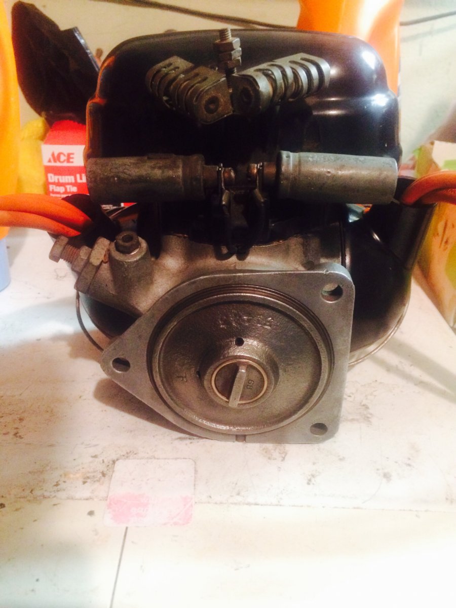

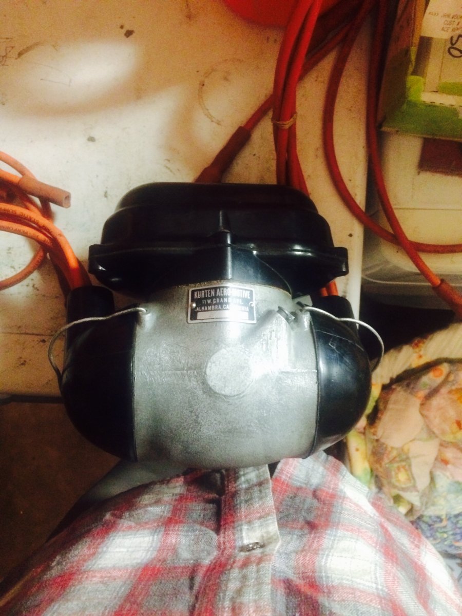

  24. image.jpg image.jpg Well I got this in the mail today. It's not a Spaulding but Jim kurten was the first one to convert the LZ v12 to a ford v8. Then he taught the Spaulding brothers every thing he knew about ignitions and they were even in business together. So the Spaulding models are basically the same thing. I could just put a Spaulding tag on it but the kurten is a rare piece. I need to change the plug wires to a more era correct huh...

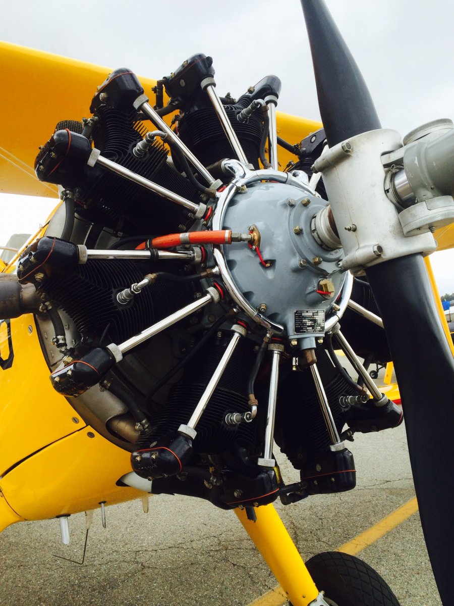

  25. Went down and picked up grandpa for a fun day at the chino air show. Planes of fame air show. He has donated a few bucks to the museum over the years and has been lucky enough to fly in some of the planes there. He has been in the p38, p51, I think he said he's been in 8 or 12 maybe . The p 38 is his favorite one of all. Here's Ggpa pushing his great grand baby's around the air show. Plus a real hot rod motor. image.jpg image.jpg image.jpg

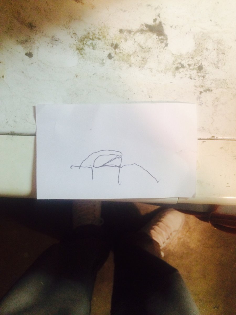

  27. image.jpg image.jpg image.jpg At dinner I showed him this picture from jimmy b. it's a *****in 32 with a cool top and windows. I asked him if he had windows like this and he said no. He said his top was a hard canvas top that did not fold up. He said he had like wind deflectors made out of canvas but would not keep the rain out. I didn't understand so he drew this picture to show me. Says they were triangle pieces made from the same canvas as the top. They snapped to the windshield frame and to the doors. He said they were like wing windows. But ou of canvas. I didn't think about it then but now wondering how he seen out of the car.
