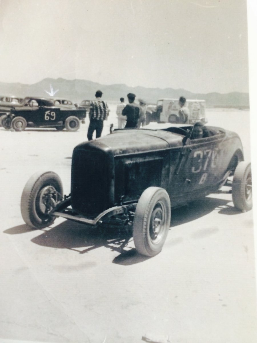

  1. Thanks for all the help guys. Now I wish I didn't post this. Now they will be popping up everywhere before I get mine done. It's ok I guess at least I can say that's what my gramps had. And what I will have as well....................................-/- I would love to see some side views. That would be killer. This is the only picture so far of his car with the top on and he did have them on this day. image.jpg

    Wow grill shell is peeked, has antenna, plus a leaned back windshield, and more. Yet it still had the mechanical brakes.

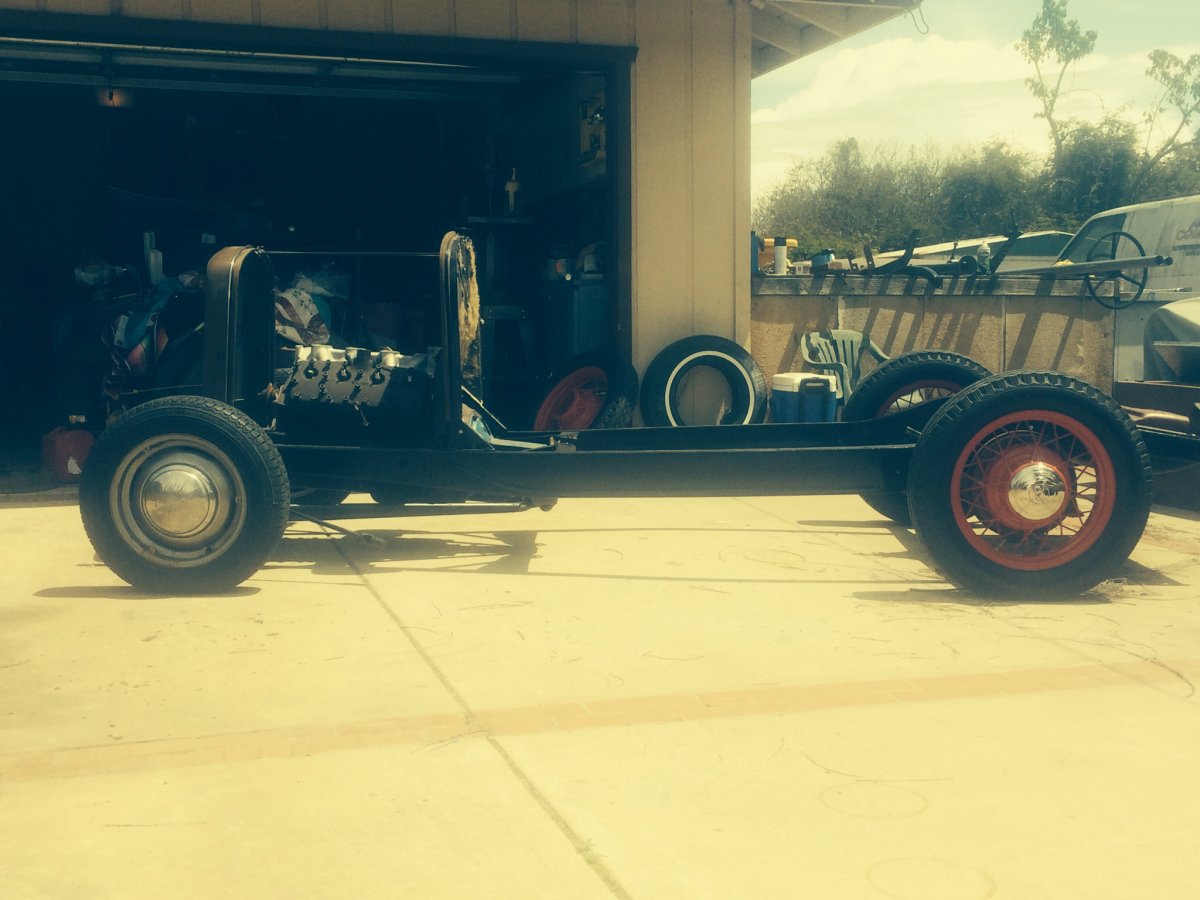

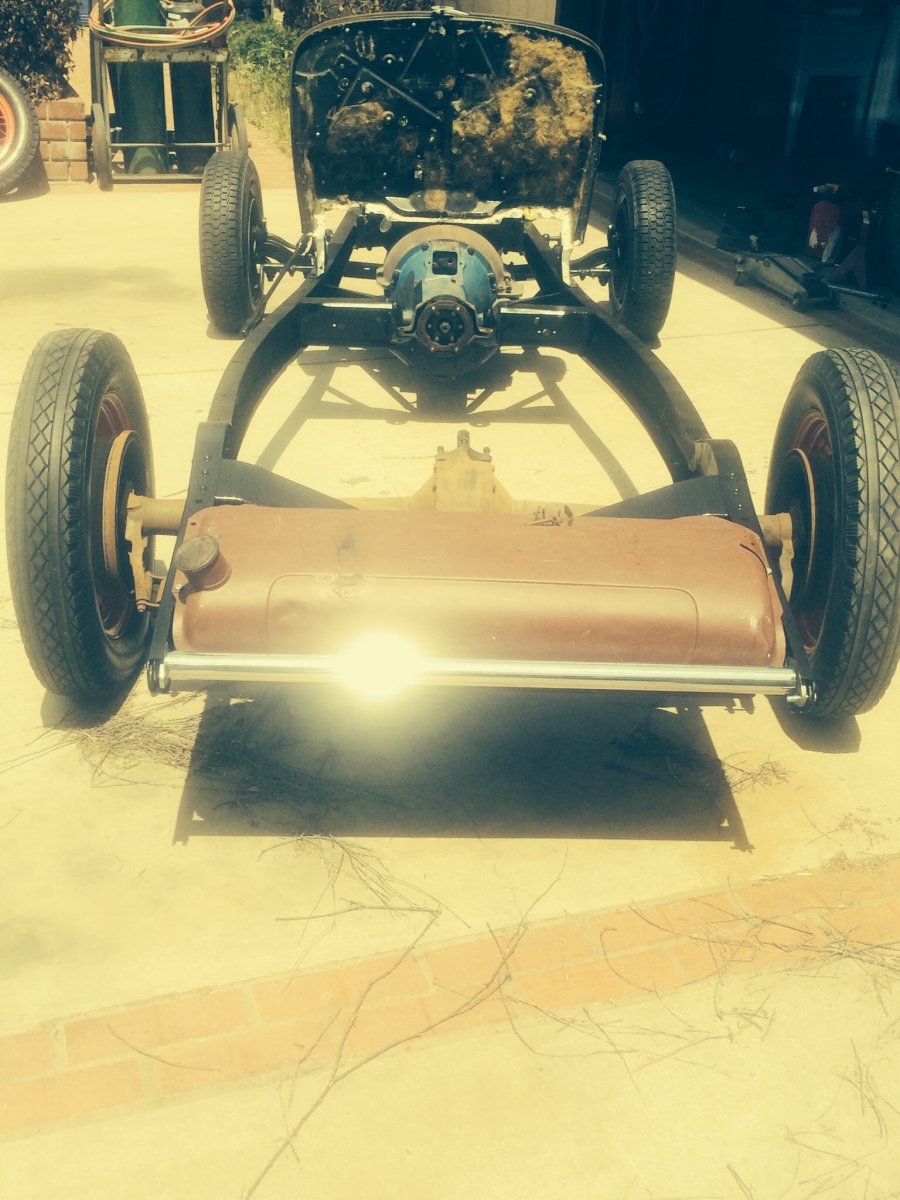

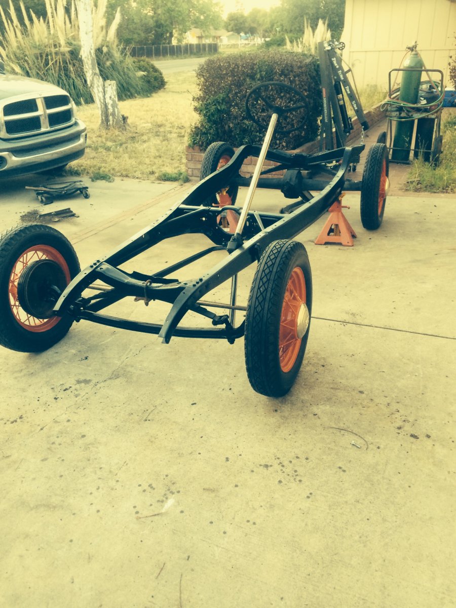

  16. Worked all day yesterday on cleaning up and putting this ch***is together out of all the extra parts iv bought over the 5 years of looking for parts. I got lucky a few months ago and bought a really nice ch***is so now I have this one for sale to help pay for the motor. image.jpg image.jpg

  17. Those f1 steering boxes are big and so is the pitman arm. Not sure I like the looks of them in a early ch***is. I know they steer better but I like the sleek look of the 32-34 box.

    F1 is not big ( nowhere near as big as a F100 steering box) and they fit the earlier pitman arms , so you can play around with final ratios and shapes without resorting to cut and weld or heat and bend.
    http://www.hotrod.com/how-to/ch***is-suspension/1107sr-f1-steering-boxes-for-pre-35-fords/#photo-07
    It is an advantage in some situations is the steering shaft on the bottom as opposed to F100s and others.

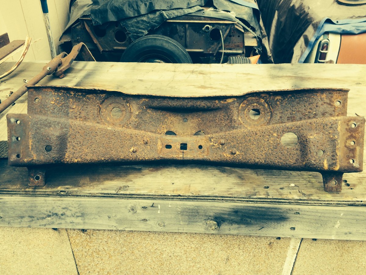

  23. image.jpg Thanks to runnin shine I now have a 32 front crossmember. Now I can use my 32 motor mounts and cut of the ugly side pump mounts on my frame. Gonna look good when I'm done. It's a little pitting up with that east coast acne as cyclone Kev says. But I will smooth it all out and shave some weight off her. Big huge Giant wide enormous King Kong thanks to Wyatt aka runnin shine aka Hubba Hubba aka holy moly.... :rolleyes:;):D

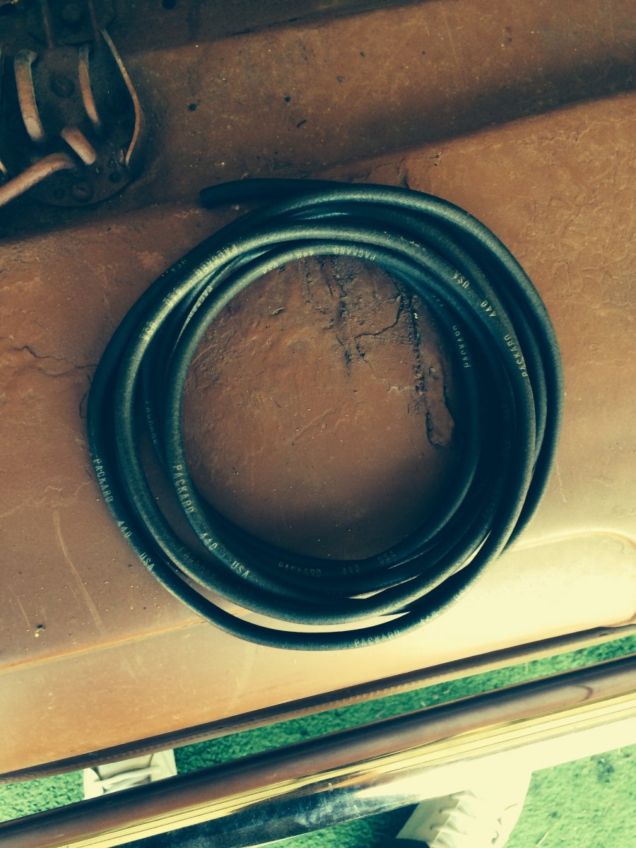

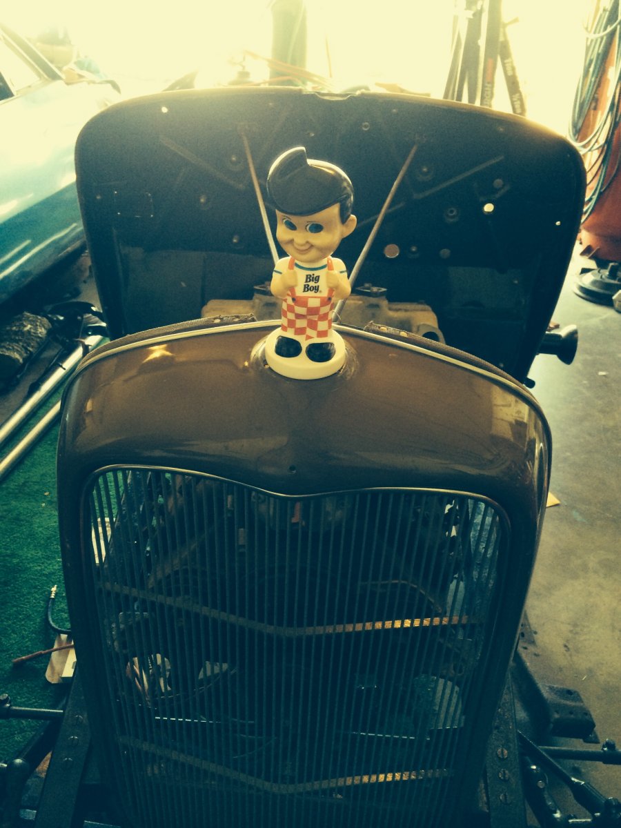

  27. image.jpg :pFinely after 50 years of searching I found the super rare radiator cap. :rolleyes: Bobs big boy Burbank bobble head. Spent the day yesterday with grandpa at my sons soccer tournament in Norco ca. Missed el mirage due to my sons team making the final 8 round of the premier league national cup. Back home today working on the car. Some names are coming back to him like potvin,harman&collans. He said he ran sodium filled valves. I showed him hamb members bored and stroked flatcad engine on the dyno from the pics he posted and grandpa was like wow that thing is huge. Also showed him dales 32 cab video when he takes it out for a drive. He was all :D. He said very few guys running the lakes could afford testing on a dynamometer so It was always drive and tune and repeat till she runs up good. He says boy did he go through ring and pinions. Poppin the clutch and hammering on the pedal. He says he got really good and changing them out.
