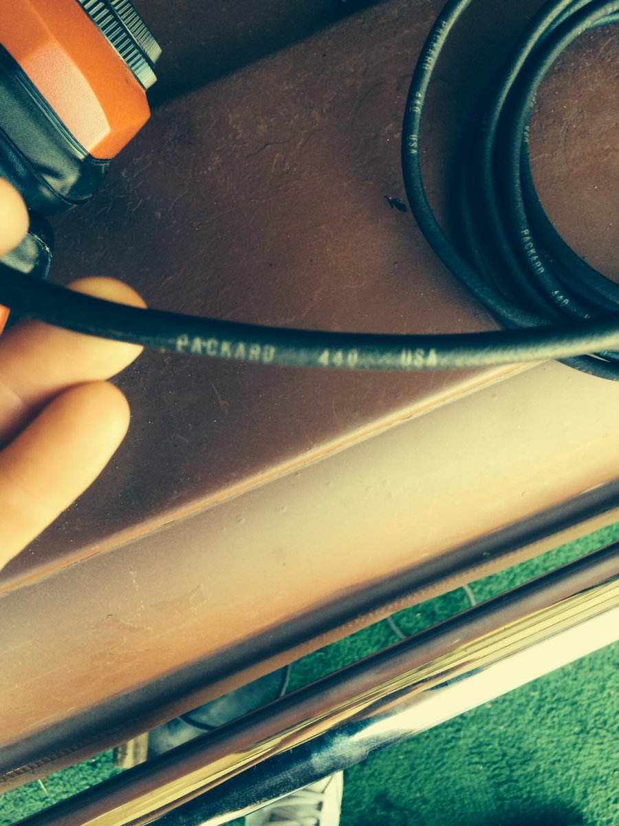

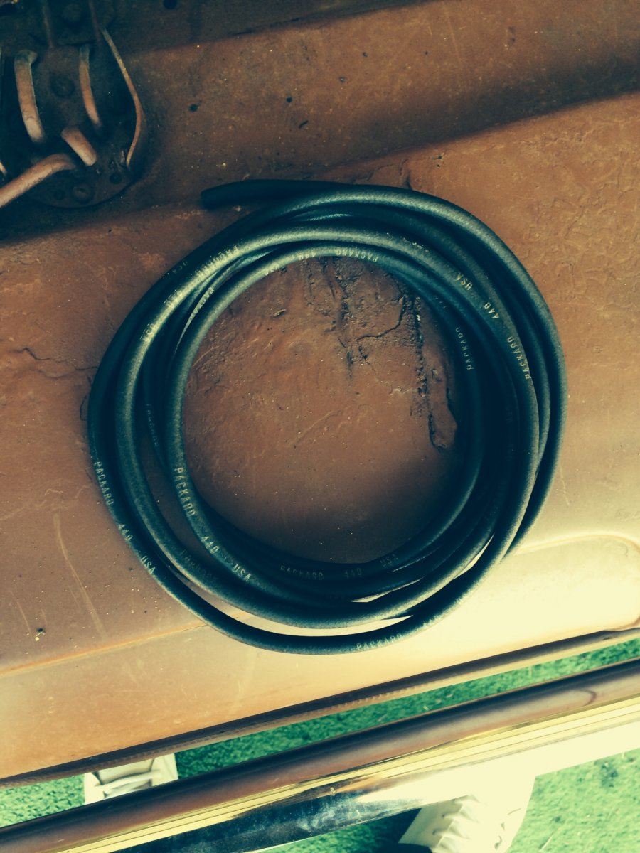

    They still make this stuff, it's not hard to find. Several people sell it:
    https://www.brillman.com/store/conf...ac-delco-spark-plug-wire-sold-by-the-foot-302
    http://enginebarn.myshopify.com/products/7mm-packard-440-spark-plug-wire

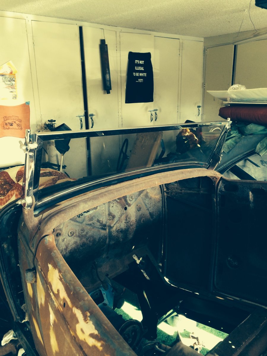

  15. image.jpg image.jpg Ouch looks like it had at one time some 39 ford tail lights

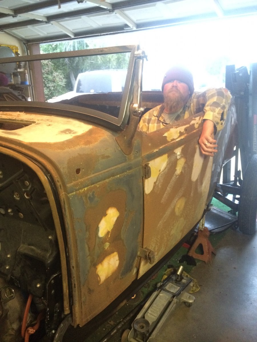

  18. Well I got the old firewall out and got the body to line up. It lines up with every body mount hole exept the two that bolt down in the centers on the firewall feet. Looks as if the cowl is tweaked alittle. So I'm gonna porter power her into shape. This car is gonna kill me since I'm a body and paint guy. I really just want to put it together and drive it but then the painter comes out and says hey do it right. We will see what she looks like after this weekend. I can get a lot done in two full days. image.jpg image.jpg

  26. Before I King Kong on this cowl are there spacers here or does the cowl suppose to sit all the way down on the firewall foot. The top by the cowl vent is sitting on the firewall and there's about 1" space here??

    If you are talking about the bracket that is riveted onto the lower cowl, that is supposed to be up off the ch***is. You tighten it down to pull the cowl tight onto the firewall seal but it should never actually get down to the frame.
    Here's a picture to make it clearer ...
  29. Thanks simon. I was just texted back and forth with cyclone Kevin and before I got it typed out he said there was supposed to be a spring in there and I was thinking back to when I worked at a hotrod shop and I was telling myself maybe there is a tension spring for the gasket before Kevin text me that. The cowl was alittle tweaked and the drivers door was about an
    1-1/2 over lapped so I got out the monkey stick and put her in her place now I got the door lined up. It would open and close if the latches weren't rusted closed. Time for torch and lots of cans of rust buster...
