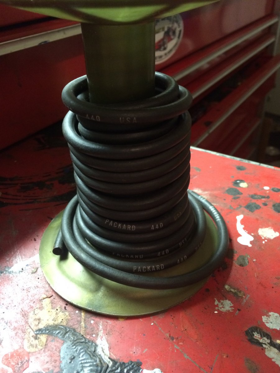

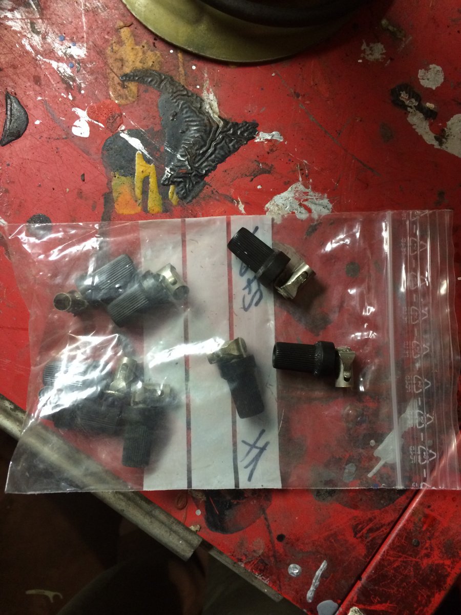

  3. Got a package in the mail yesterday from a hamb member. Enough Packard 440 wire and 8 rajah ends to finish the wires. Thanks MR.VAIL. I'm getting closerrrrrrrrrrrrrr. image.jpg image.jpg

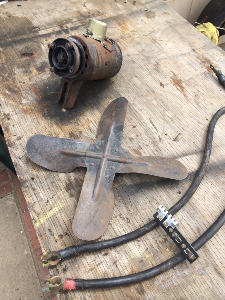

  4. image.jpg image.jpg Here's my off set gen mount and fan mount I just got today. Looks pretty cool for 20 bucks.

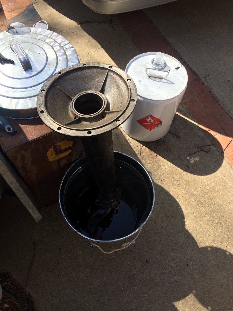

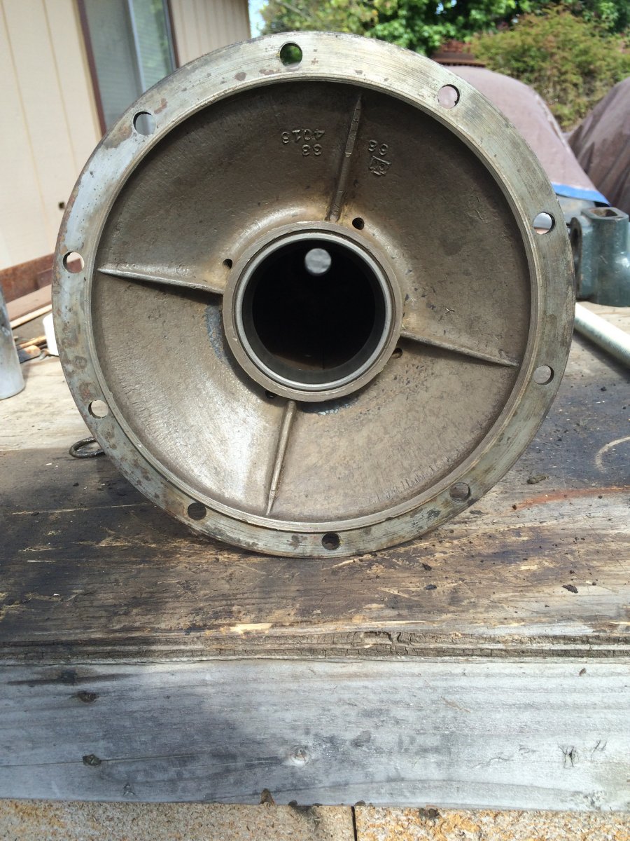

  5. image.jpg image.jpg One down one to go. Cleaned right up with EPA approved cleaner... I don't know why it smells like gas:rolleyes:Now I'm all :confused: I got the old seals out and started to make my new seal insert tool. I have to shut down for the night so tomoorow I will finish the tool and hopefully get it back together and get the brakes on radias rods torque tube so I can put it back on the ground and get it out with the tires on so we can get a side money shot....

  7. image.jpg Picked this up today at a local car swapmeet just wondering if it will work for my car. It came off a 36 five window really nice car but the guy switched to alternator. Is there differences when it comes to these. Can I use it on my 59 series motor???? I hope I can run it I payed 25 bucks so hopefully...

    Yes that will work on your engine, I run a fan mount generator on my 59ab. You will just have to offset it and will loose the ability to run the fan on the generator if you are going to run that 4x2 or a super dual.
    Runnin shine and paintslinger805 like this.
  9. Thanks mike, I just didn't know if there was a difference in years of generators. Or if they are all the same from 32-48. Didn't know if they got better as the years went up, like better housing, or bearings ect ect. I do have the off set setup to run a super duel also.

    cut up that generator and make it a idler for the fan then find a 41-48 2 brush gen and external regulator. ill find a pic of my set up
  11. So they went from one brush to two brushs later on. So they are the better ones I see. I have a couple just might need rebuilt that's why I was hoping to run this one I know the guy and the car it came off of so I will rethink the generator thing. Thanks ***us.

    Rebuild generator is simple do it yourself stuff, clean, check continuity and insulation then paint, replace bushes , bearings, brushes and turn the commutator, easy 12v conversion for flathead hot rod ..... use a late fifties generator and regulator with the front bracket from a 42-48 generator. cut the extra mounting ear off the late generator rear bracket and clean it up to look like it was never there... job done, it's a bolt up.
  14. I like that idea and will use it later down the road, as far as this car I will be keeping it 6 volt. I really want to see and feel the car the way my grandpa did. Or at night time barely see...:D

  24. One thing on the rear - hopefully you kept the old gaskets that came off of it - and know which ones go one one side versus the other. You can then mic their thickness and know which ones of the new kit to use on each side (at least as a starting point). If you're lucky, you won't have to change gaskets to modify the contact pattern.

  25. Ya dale I did mic the pinion shaft backlash before I tore it apart. It was within specs so I just marked the old gaskets and put them aside. I figured that would be ok so I'm glad you said something it's nice to know I'm thinking in the right direction. The backlash was about .007 on the pinion so I was just gonna clean seal and re***emble. The rearend came out of a really nice low mileage car for a Columbia 2 speed so I just wanted to reseal it and check it just to make sure and she's pretty nice inside. The only car I ever had a generator on was my early vw bug. I drove the hell out of it so I did change it to an alternator. As far as these early ford generators I still need to learn alittle more about them. The one I just got looks cool to me and now when you say cut out what does that mean? I see guys put voltage regulators on their firewalls little black ones and the one I have has alittle round housing and I'm guessing that's what you are talking about. Is this one internal regulator or is that round thing it? I hope this is not a lame question. I remember my other grandpa teaching me how to polarize my vw generator but that was about 20 years ago and now I have forgot how to do that. I remember using a piece of wire and jumpin it from one thing to another. Thanks again dale talk to you soon.
