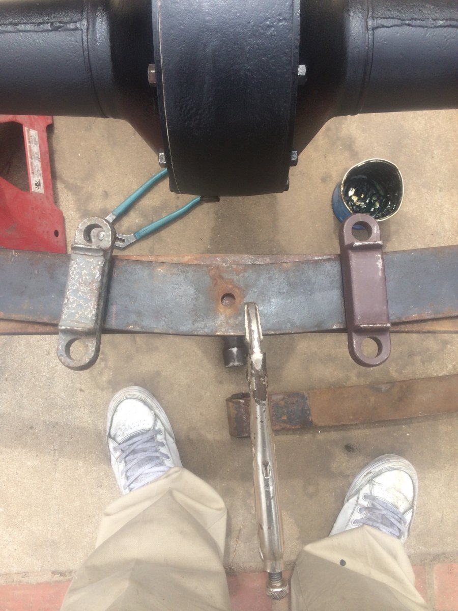

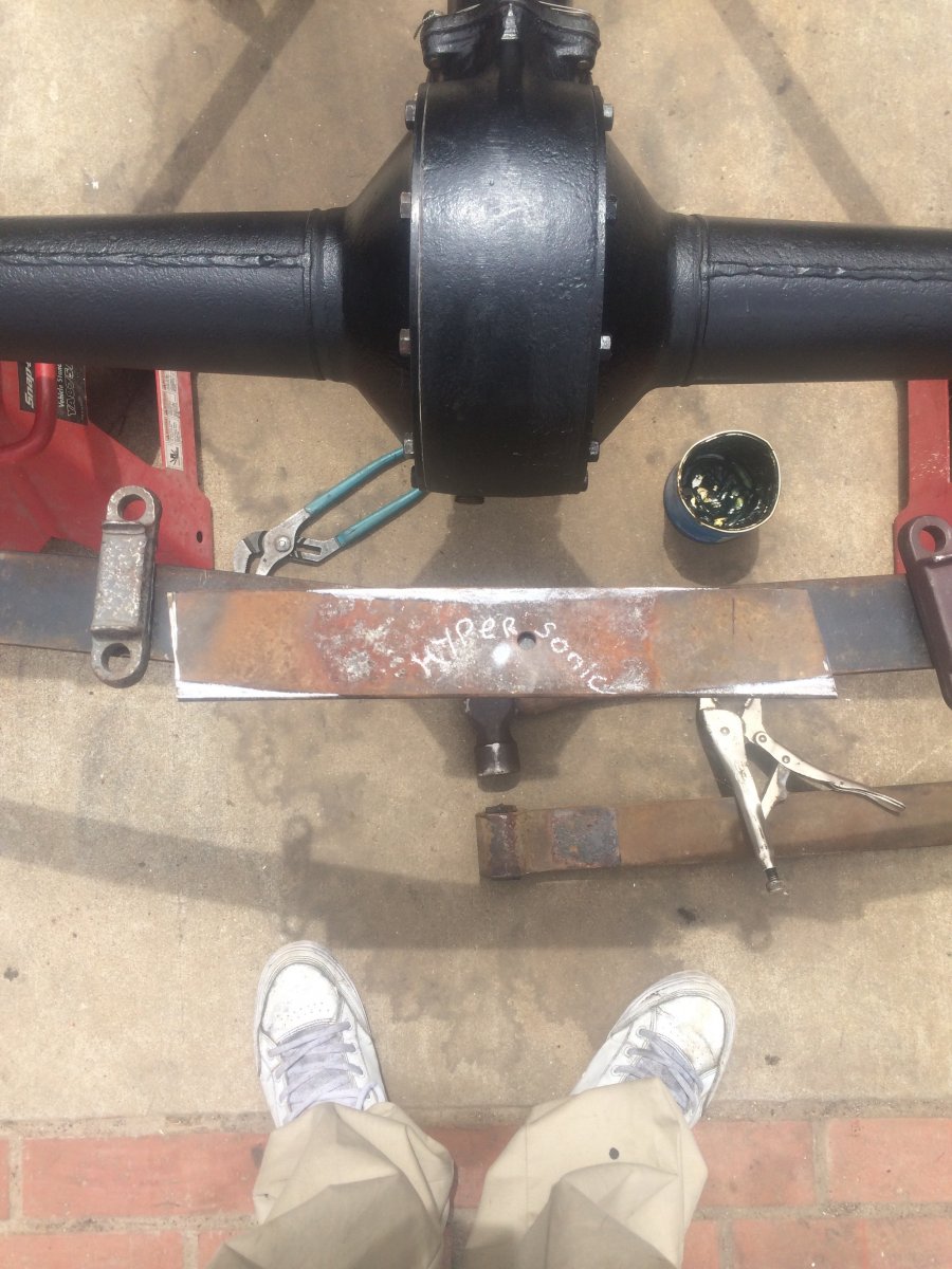

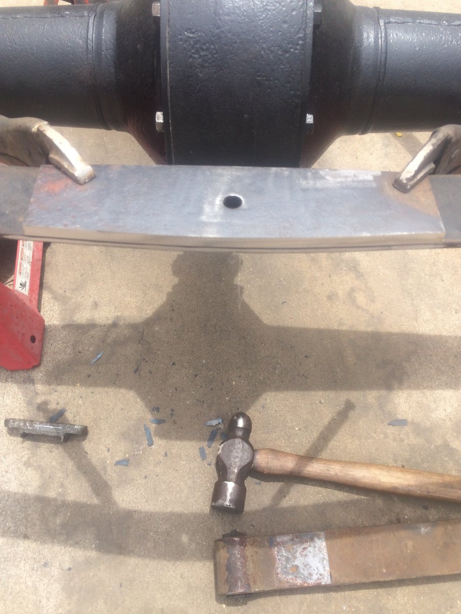

  6. image.jpg image.jpg image.jpg image.jpg So I'm now making a spacer/spring for the bottom of the rear spring. Since it's reversed eye and I only have 9 leafs the bolts and blocks won't tighten up the spring into the perch and I don't want to use those crappy blocks I bought that were made in china. I have a good set of originals so with the spacer I will be able to use all original parts. The spring I'm cutting up to make the spacer came off a ford so ha ha. I will bolt the spacer on the bottom of the spring pack. Almost done so by end of day I will post the money shot pics.
    Jeff34 and volvobrynk like this.

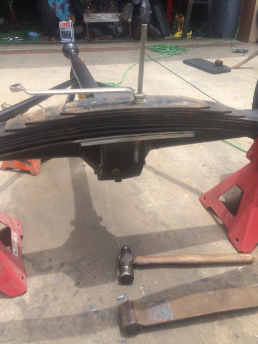

  7. image.jpg image.jpg image.jpg Almost done. After I get the spring pack tight I will clamp the hell out of it to put the bolt in it.
    Jeff34 and Runnin shine like this.

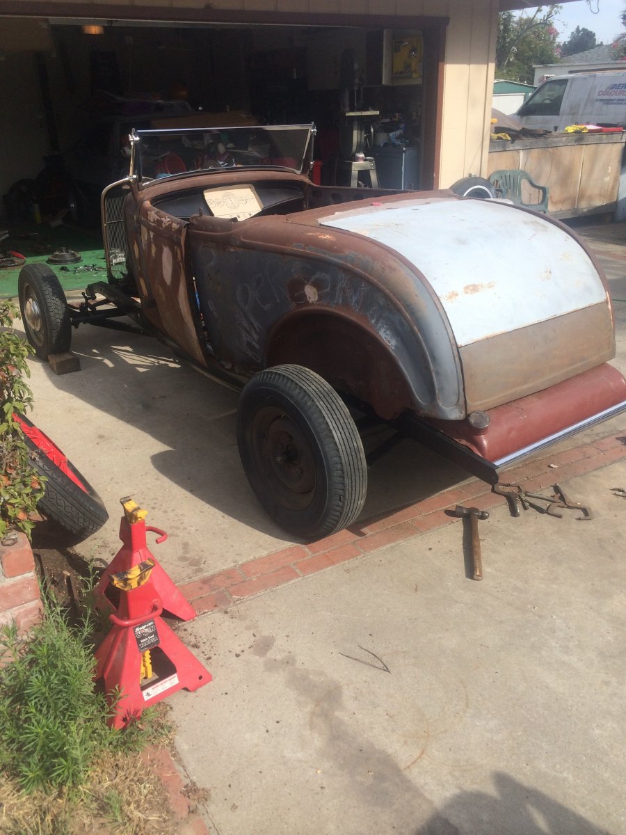

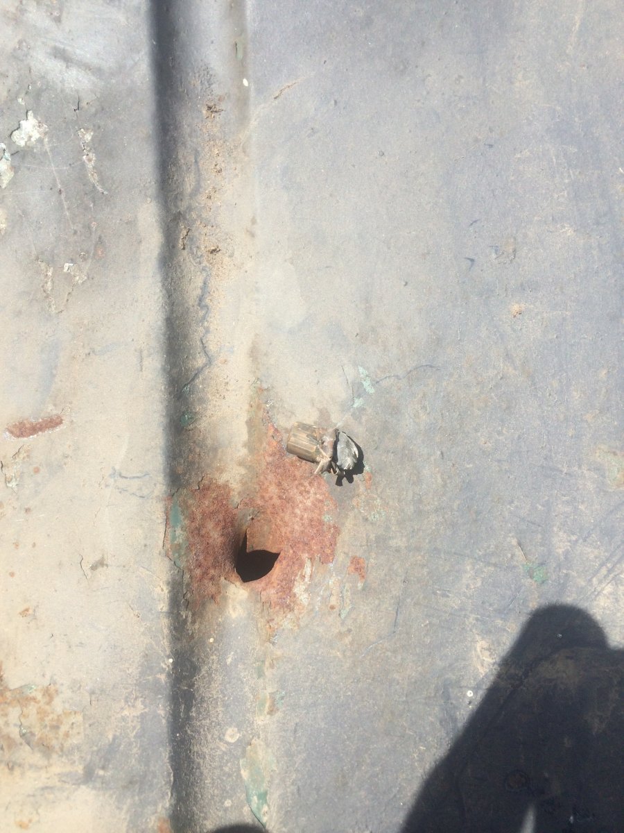

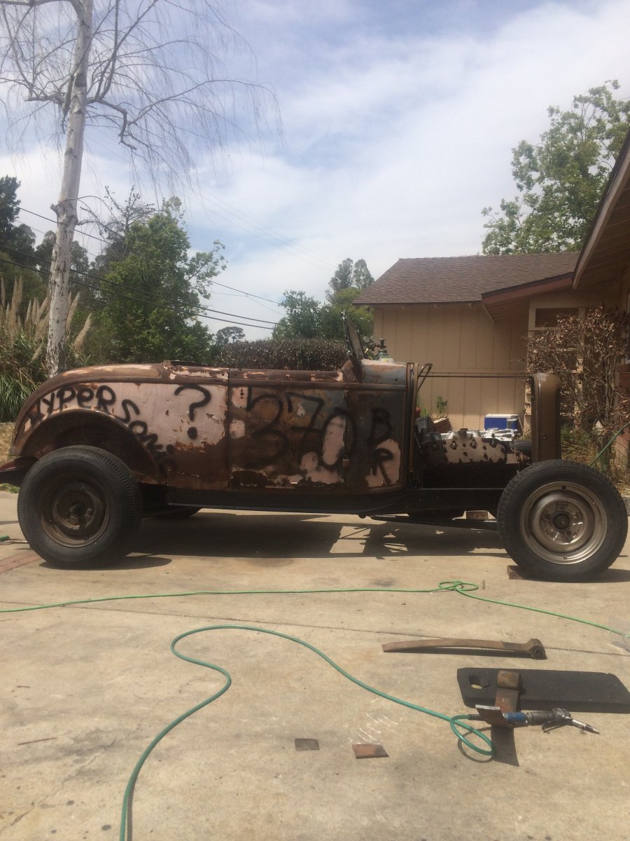

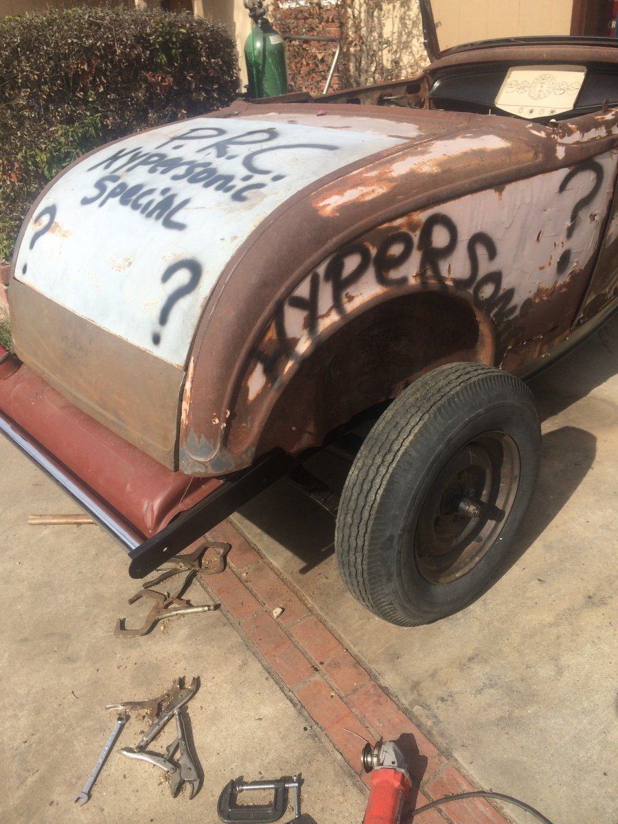

  11. image.jpg Found a bullet hole in the inside of the trunk lid and also found a bullet cleaning the inside of the lid out. I'm now wondering if there's some bondo'ed up holes all over the top of the lid. Hey Wyatt I pinched it till it turned blue.:oops:

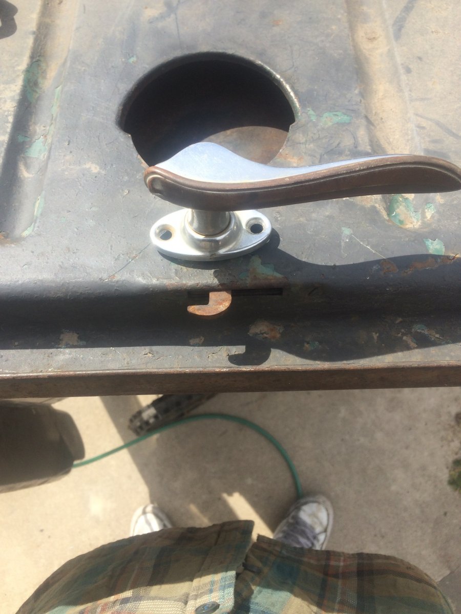

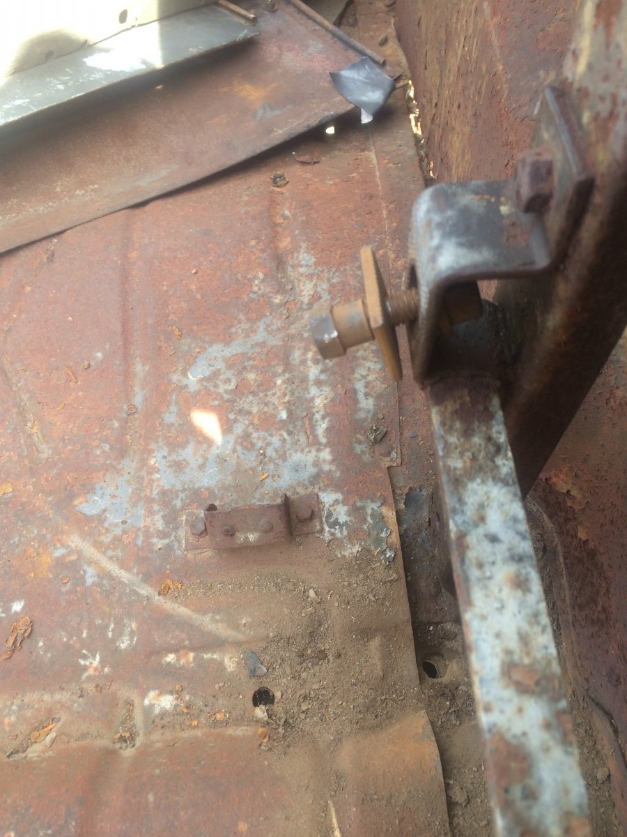

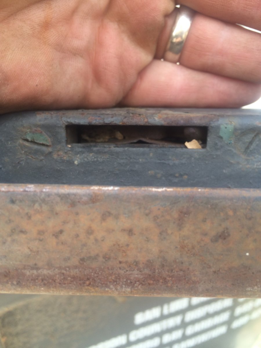

  12. image.jpg image.jpg Got lucky and the rumble bolts were on the car to attach the rumble lid and I also found the latch hiding up in side of the deck lid for the handle. Just need a 32 trunk handle now fellas.... Hint hint I need a trunk handle so go out in your stash grab one and sell it to me please pretty please. I don't want to have a cheap repo handle got to have a real 32 one.
    volvobrynk and kidcampbell71 like this.
  13. image.jpg It just keeps getting better and better. Latch works like a dream...
    bengeltiger, volvobrynk and 3wLarry like this.
  14. image.jpg Looks like I'm gonna have to bust ass on this body and get it in the ol lacquer gray primer. It's got to many colors on it. That's it for today time to clean up and din din...

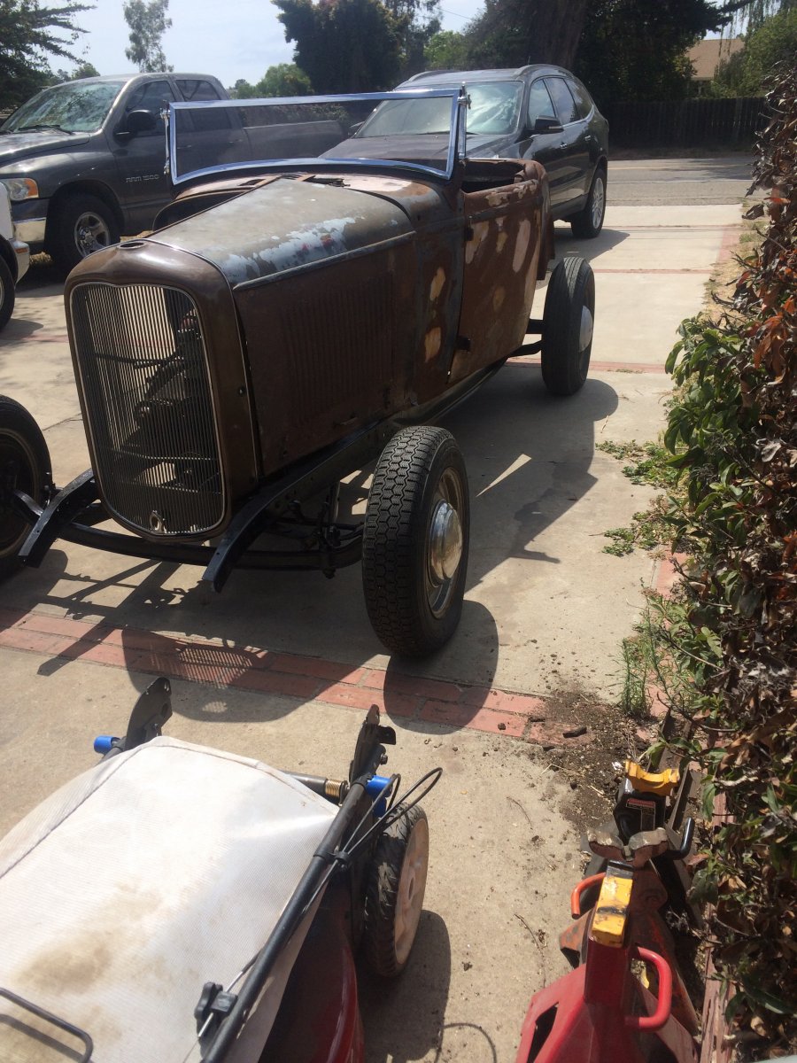

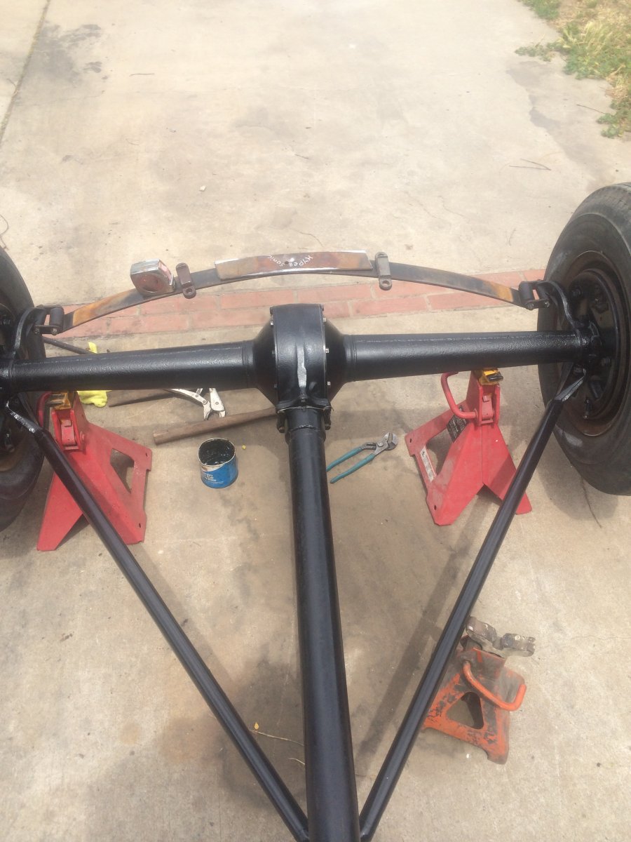

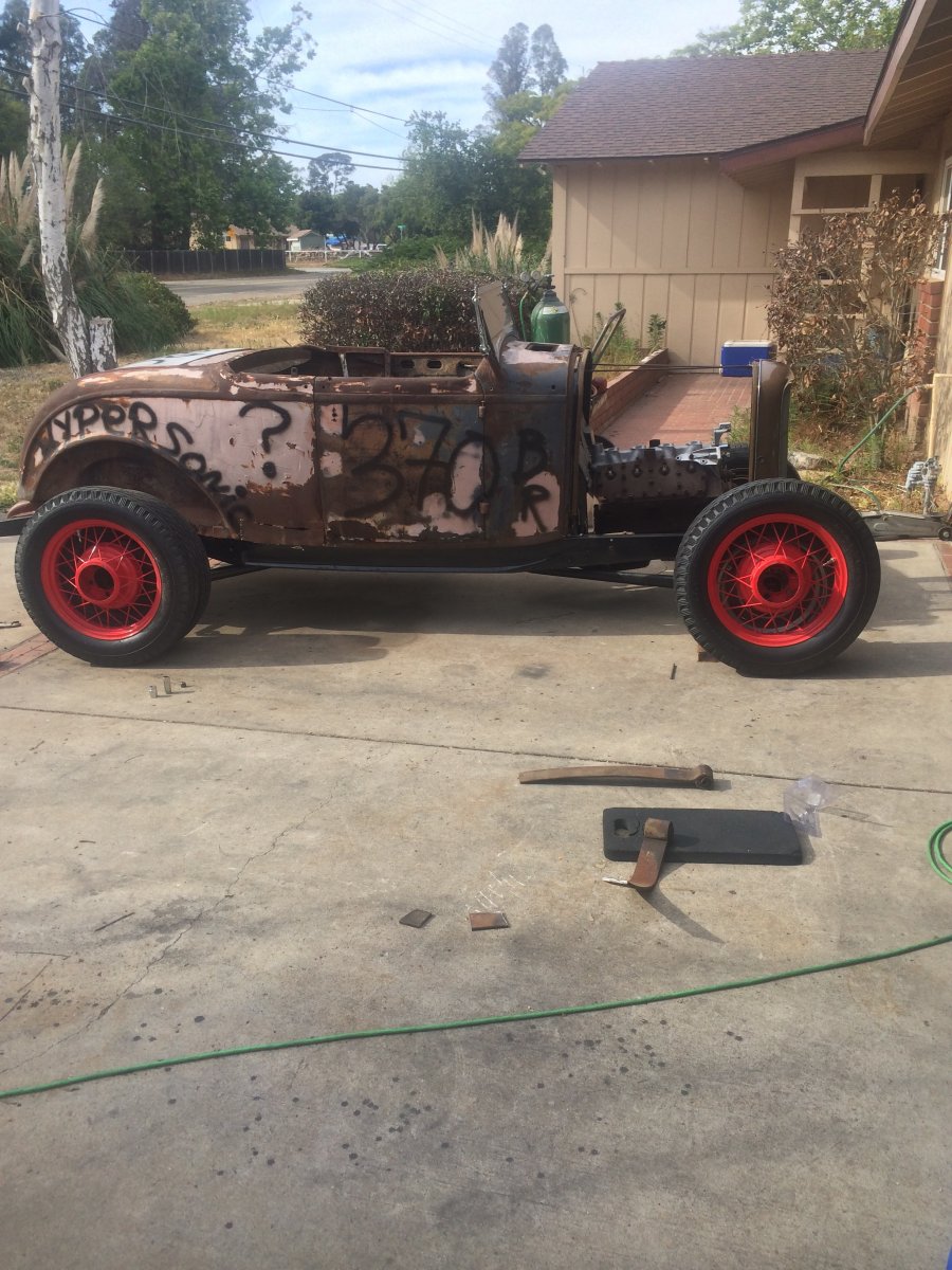

  24. image.jpg image.jpg image.jpg Dennis the hotrod gods will guide you on your journey to the Wild West. Here's a couple more pictures in case you already forgot what she looks like.:D:D:D

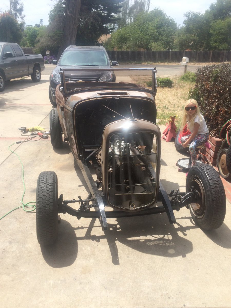

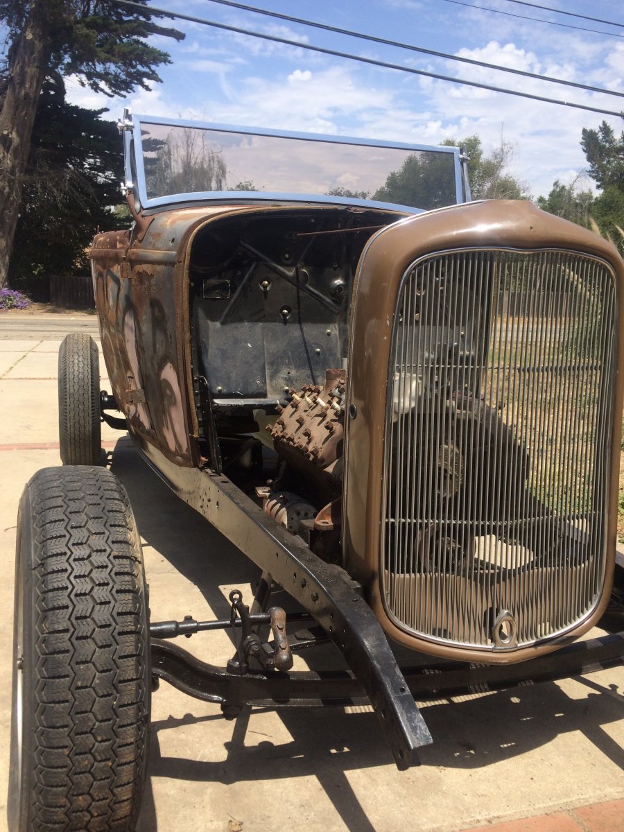

  27. image.jpg image.jpg Just messing around but I love the looks with the hood.
