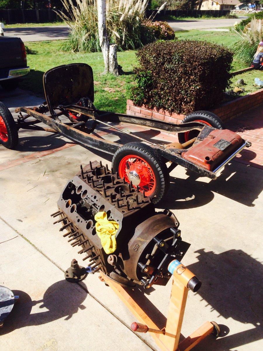

  4. image.jpg image.jpg Off with the old in with the new. Hub puller ✅ image.jpg image.jpg

    Get a front support on that engine stand, or the bell housing will break. I've seen
    this happen more then once.......Just sayin.

  8. It's ok that's a 3-1/16 bore block. It has two pistons melted in the cylinder walls. Just gonna take the valves from the good holes. The heads had so many cracks I don't no how it got that hot to do what it did. It was a free motor. The cam gear is a 4 bolt so I take that too. The block is nice but I don't build motors with sleeves. I will have it x rayed to see if there's enough meat in the walls to bore but I got a good one that's stock 3-3/16. So I build that one.this is not my first rodeo just the most important one.

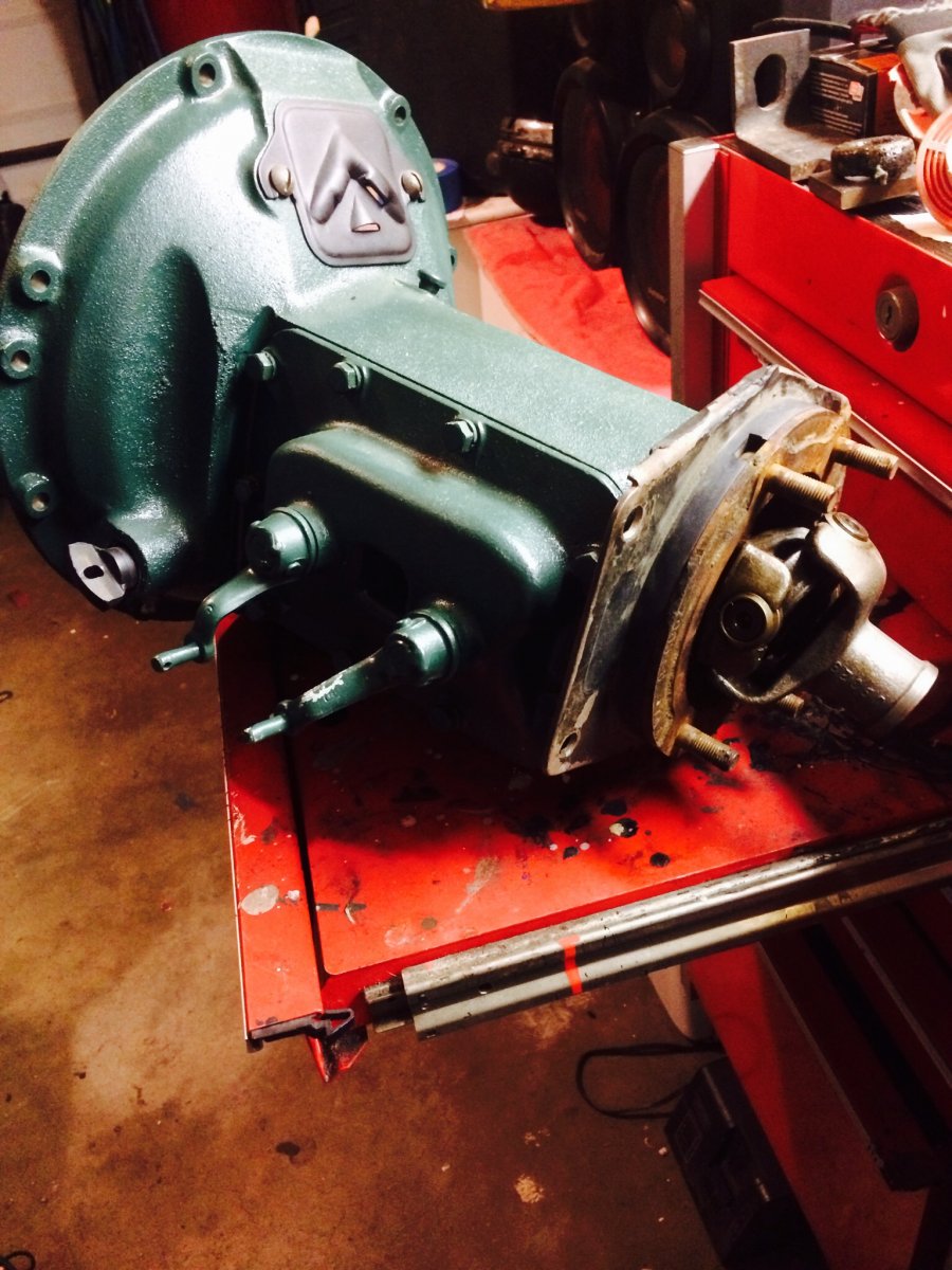

  16. image.jpg Trans is done and ready. One more check✅ I love that you can just throw around an early ford transmission with out bustin a ball.

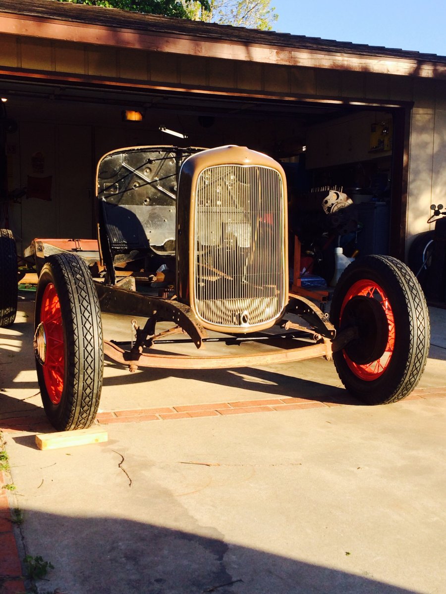

  17. image.jpg image.jpg image.jpg She's pretty all say.! Wish I had a radiator. All in due time.
