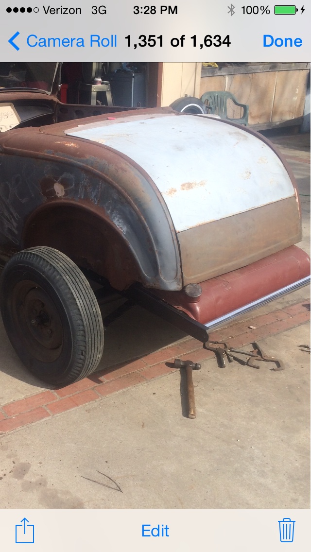

    Wow Bruce, that new rear panel looks great[emoji3]

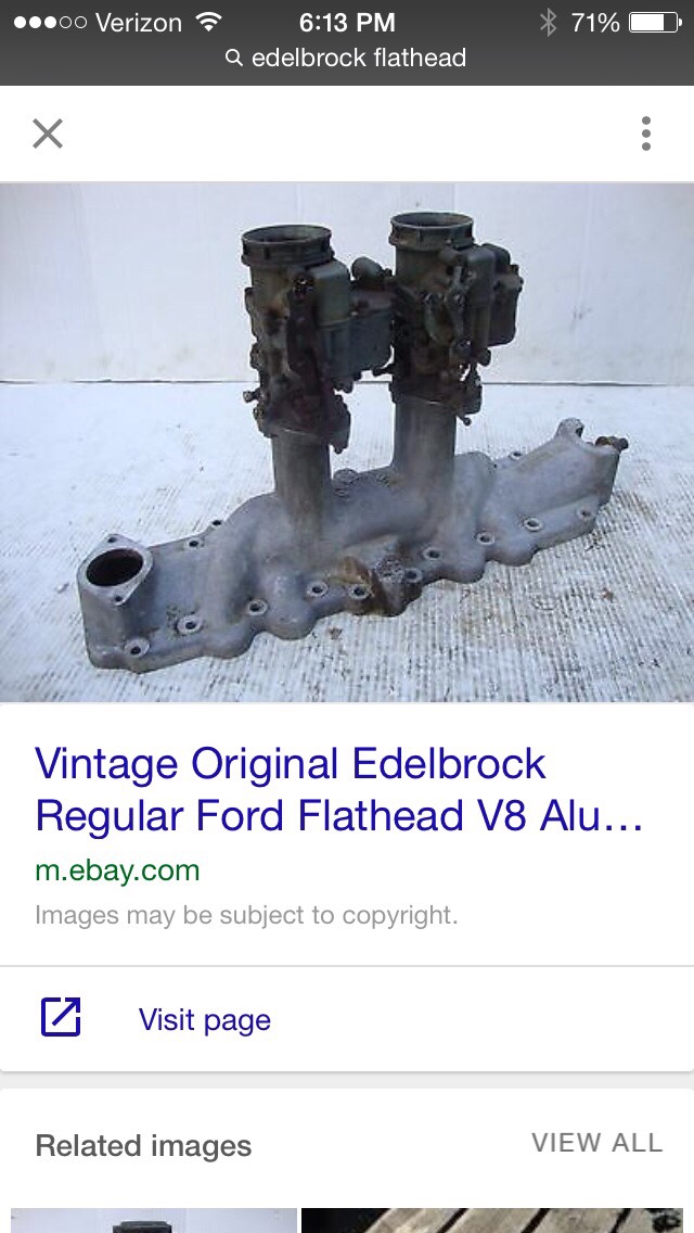

  12. image.png Is this the intake you're looking for?

    No, this is...

    I love the 4 carb setup, but the thickstun edelbrock setup is the right one

  15. Yep I'm looking for a regular or original sling shot. I have a edelbrock 4-2 just like the one cactus posted but it's got two many carbs. I'm gonna end up with a super duel with off set generator because I can't get one of the others. It should be ok till I find one down the long hoarder road. The guy that is building and tuning up a original crab flatty distributor for me for the break in of the motor has one of each but not for sale just wall hangers. Of course...
  16. Also I offered him my four pot set up plus 600 bucks and he still said no. He is going to relist his intake collection on eBay again soon he said. Oh well
