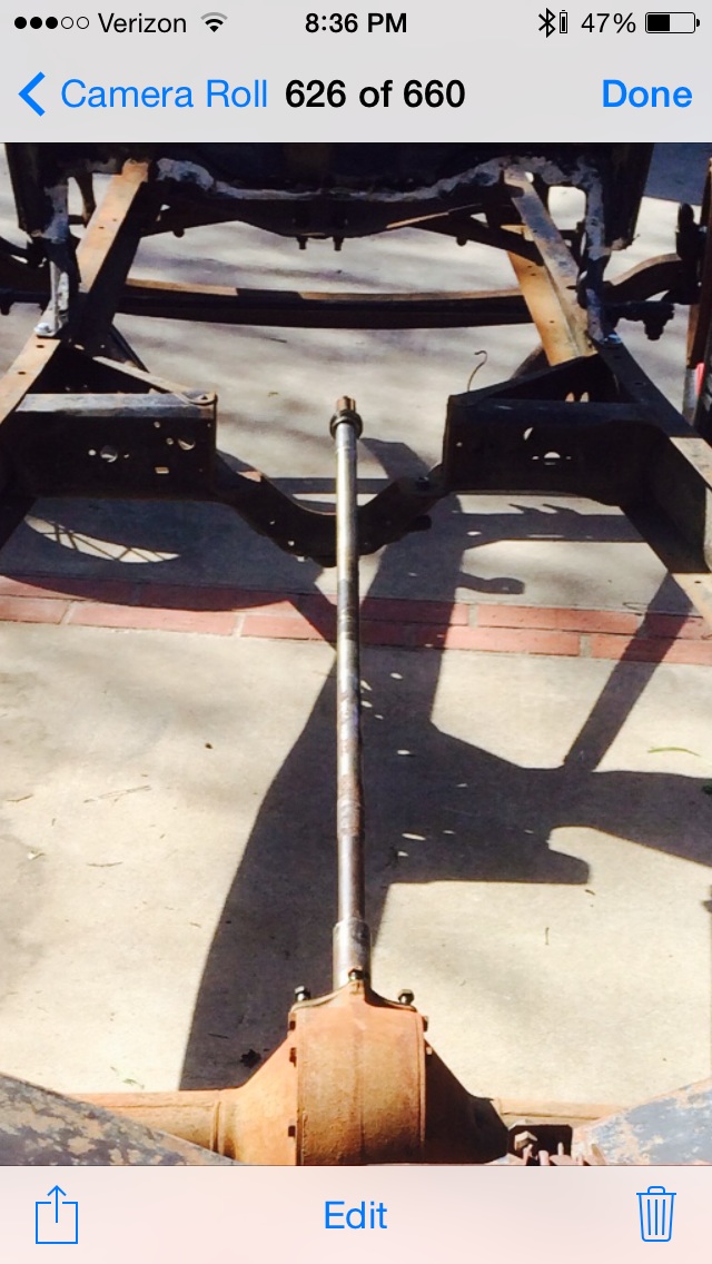

  7. image.jpg image.jpg image.jpg We'll I think I found out why someone cut the top off the k member. A 35-36 trans mount fits perfect. Now do I still cut out k member and replace with my other one or should I just get a 35-36 mount.? Anybody got any ideas as to why someone would do that????

    I've seen a few K members with the tops cut out but most welded ears to the top and then bolted it back in. I thought it helped with motor/trans removal.

    If you use a stock '32 K-member you'll have to pull the engine to remove the trans. If you keep the '36 mount you can pull the trans rearward for removal and leave the engine in place. Ingenious idea. But I'd probably add a bolt-on strap across the top to replace the strength that was removed from the K-member.
  12. Yea will do that. I should of thought about that as iv heard guys talk about doing that before. My mind is in high gear so I'm over thinking the small things. I'm gonna have to pull back on the stick alittle and think before I post. I meant to say hey check out my k member all done and ready for a 35-36 trans mount. Sure makes pullin the trans out easy. thanks guys for the help. I think it will still be era correct huh????

    Not sure what engine they were using. The old Hurst mounts usually had the same spacing as a '38-'48 Ford flathead, and Hurst made those mounts for a few dozen different engines. I think the later flathead's mounts were a touch wider, but I thought the '49 Merc pumps were narrow like the earlies. Could be wrong though. Probably need to measure to make sure the trans mount will be in the correct place for the engine you need to use. Might need to move it a bit forward or back, but it's still a good concept.

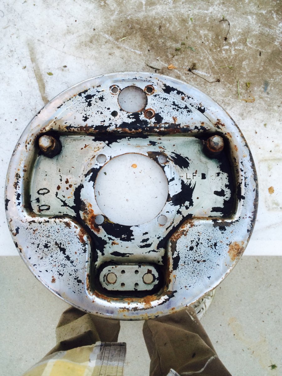

  21. image.jpg Ok need some hamber help. My grandpa chromed his backing plates and front spreader bar. I would like to find some that were chromed long ago to show their age. I have a front left but need a right and front spreader bar. Please pm me if you have and would like to sell them thanks. I would by a matching pair if y'all got em. The one I have must of started rusting and someone blew some black paint in it. Once I get all the paint off it will look good.

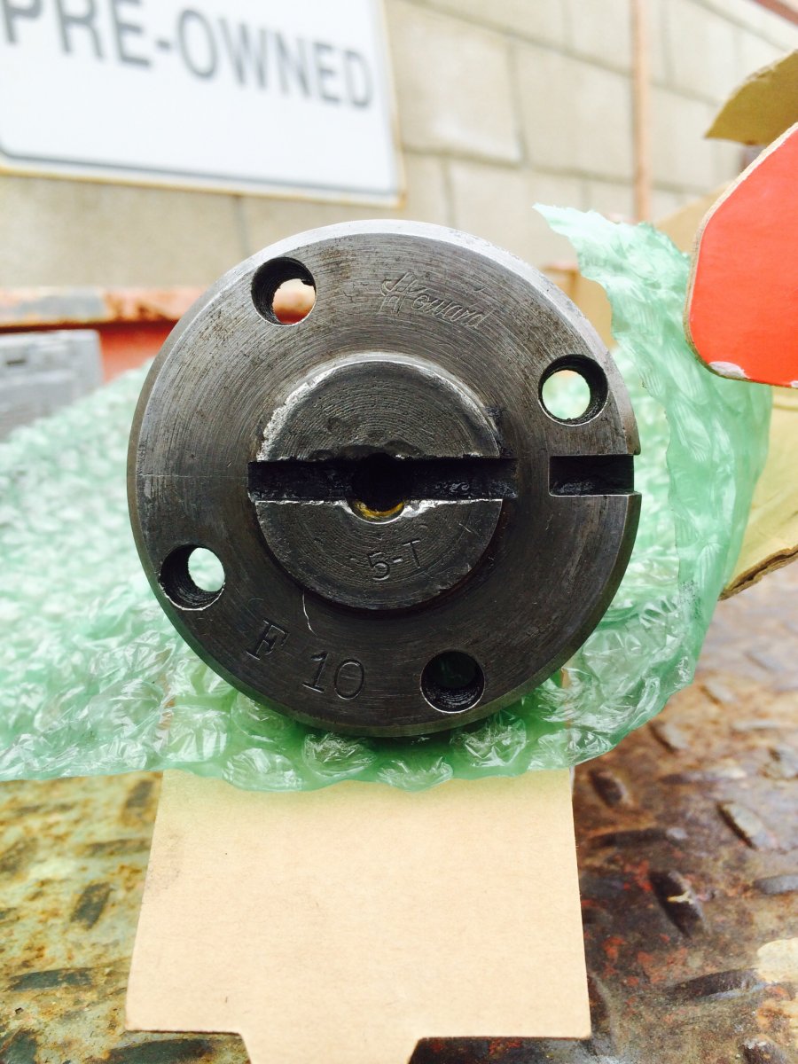

  28. How about a Howard f10 cam. Maybe go 3 3/8 bore pump it up alittle more than what grandpa had. Engine will go to machine shop in two weeks. Was there today and they are busy. Got to sonic test to see what we can do. Grandpa ran a smith cam and I have the specs so I might have this one ground to what he had.
