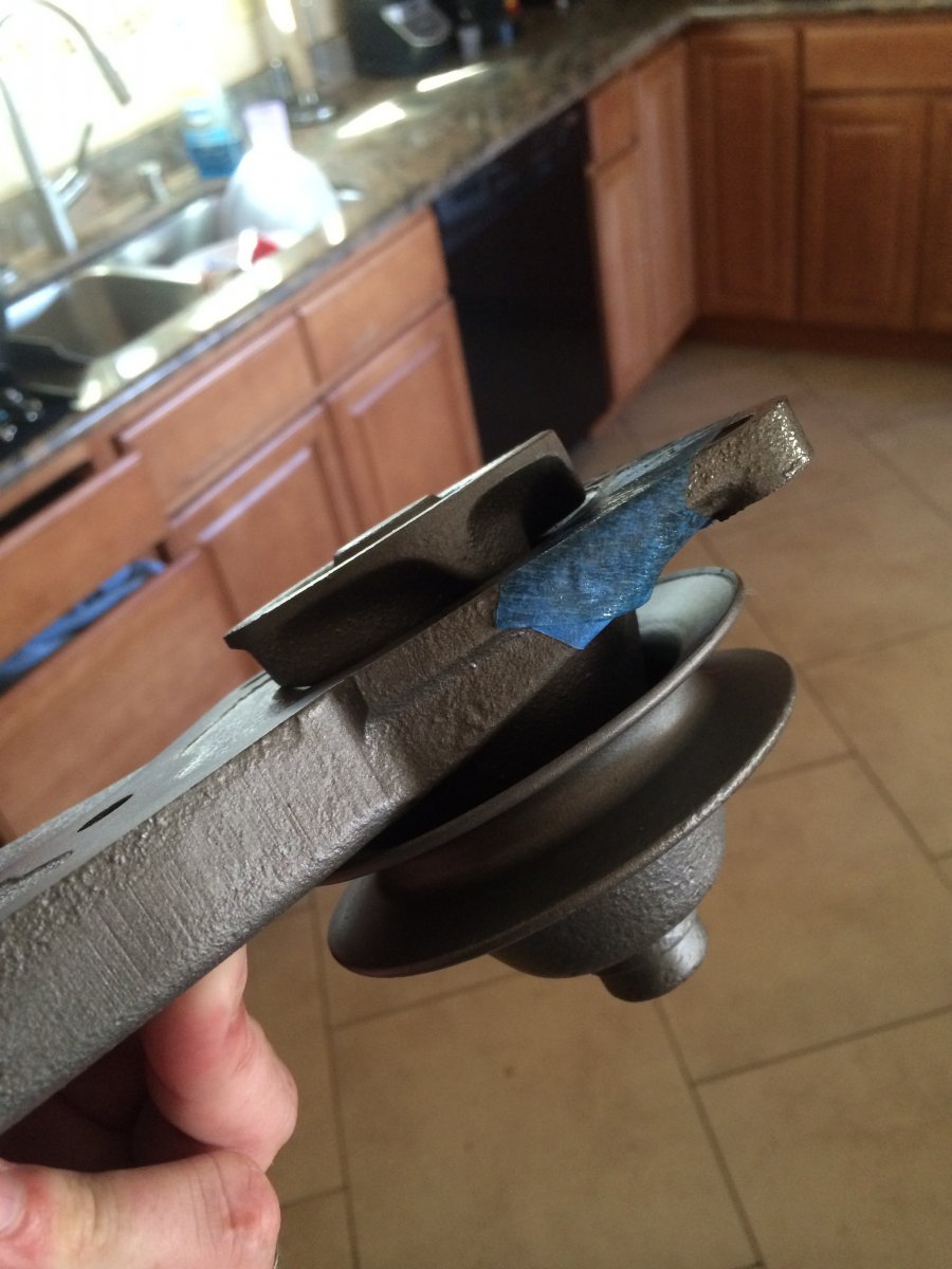

  15. image.jpg image.jpg Well ol skip Haney is a man of his words. He got them last Friday and I got them back today all nice and new with the turbo fans for better cooling. I didn't get my damn rings so they better be here tomorrow. Now just have to trim them up cut off the mounts.

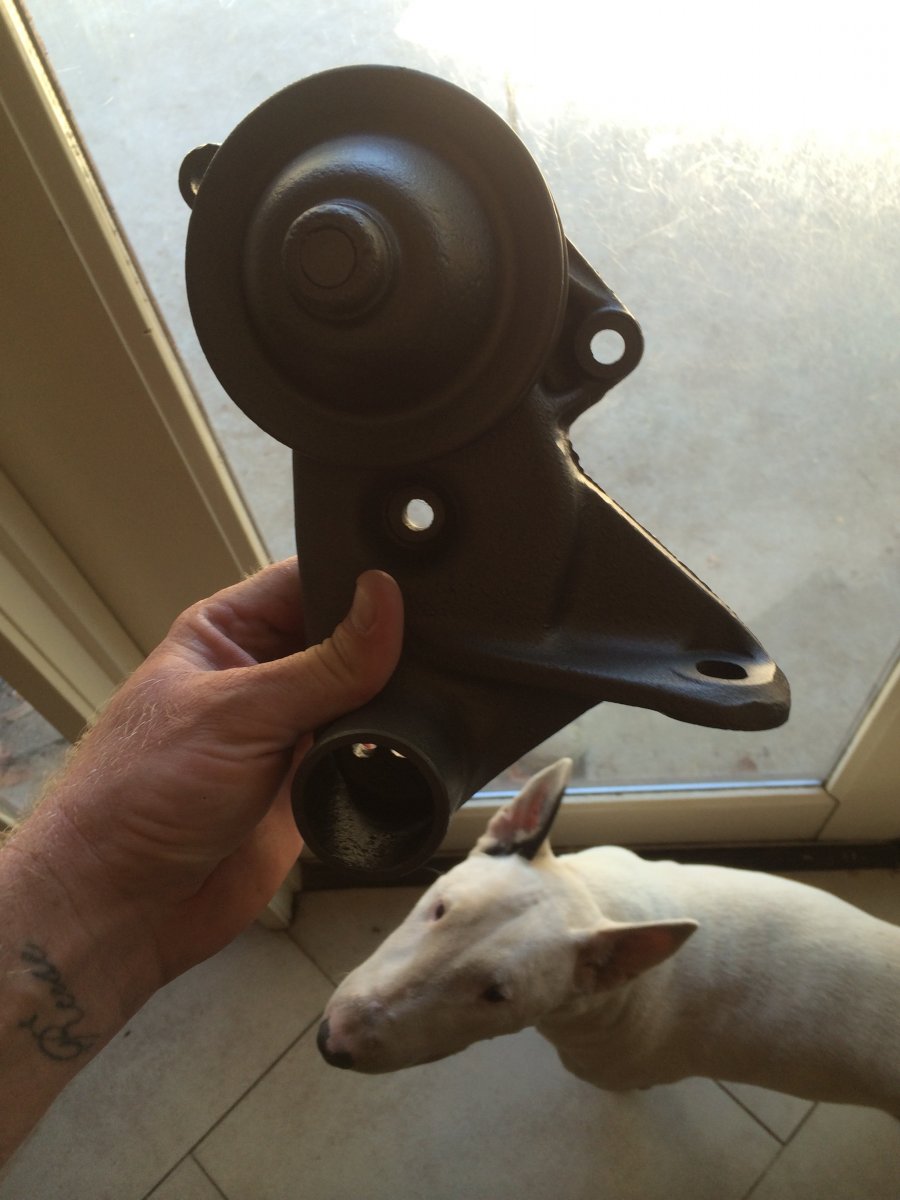

  17. So as me and my happy wife sit here and think about me, grandpa, and this 32 build we think back to when we were kids and how much I always wanted a running flathead and a roadster. Then to find out about my grandpa being one of those crazy kids in the late forties running on the dry lakes, I can't believe I'm days away from a running driving holy grail all original (except a few parts) 32 ford roadster. With the power if the internet IE- H.A.M.B. The hole wide world also knows my story/history. I'm really happy to know all y'all are into the story of my family's history. I'm grate full that you all have found this to be amazing story good enough to follow along. I will be putting a lot of photos on here in the next week to catch you all up on the car. And then hopefully lots of you will see it at trog. Iv been ordering everything I can thing of that I may need to finish it enough to make the trog. Thank you all for the kind words and helping me along.
