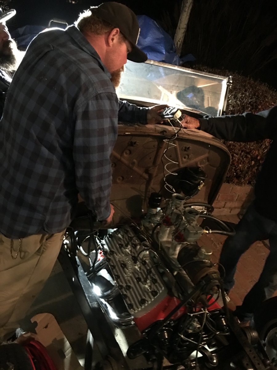

    So we heard it fire tonight,- after about 10:30, I tried to load the video, IDK what's up wit it...
    Any way for an instant it sounded GREAT!!!!!!!
    He's hitting it again in the AM...
    FANTASTIC JOB Bruce, Dennis, Cory and Co. !!!!!
  16. Yep we just bumped it to make sure everything is right and ready to go. The thing is load as hell. Past 10 o'clock. We banged it and it was insane. It died and hit the starter again and it locked up. Seems my 40$ good to go starter has starter some other car a million times. The gear is wore out. So I have another but it's rusty so I'm soaking It over might in that mystery stuff. I will fix it tomorrow and get this baby broke in. We got video but who knows how to post it. Not me that's for sure after I think about it
