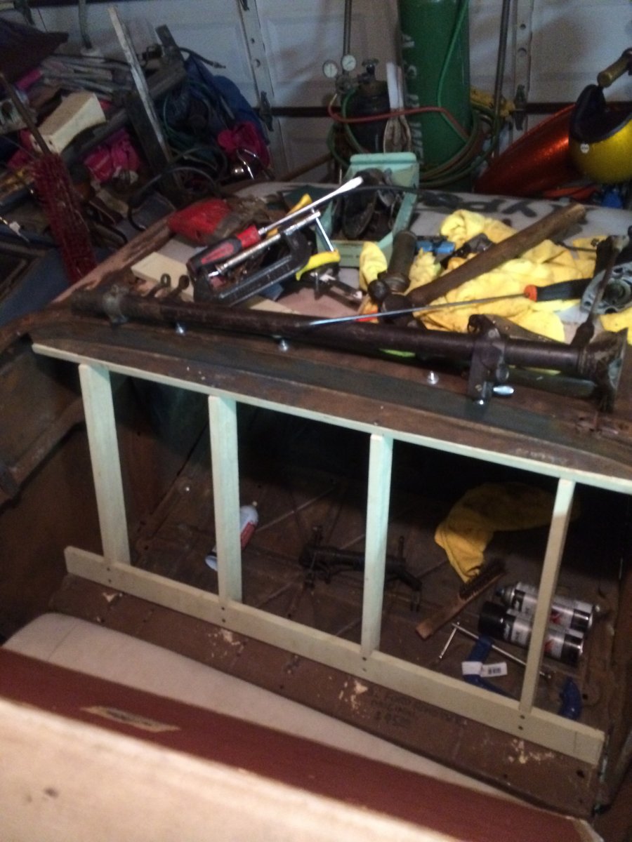

  10. image.jpg image.jpg image.jpg Update...

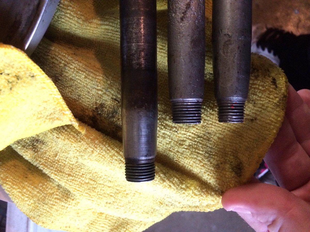

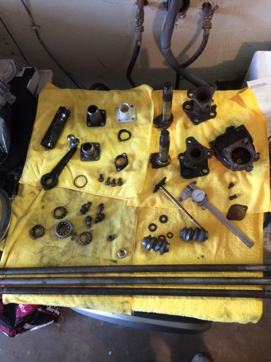

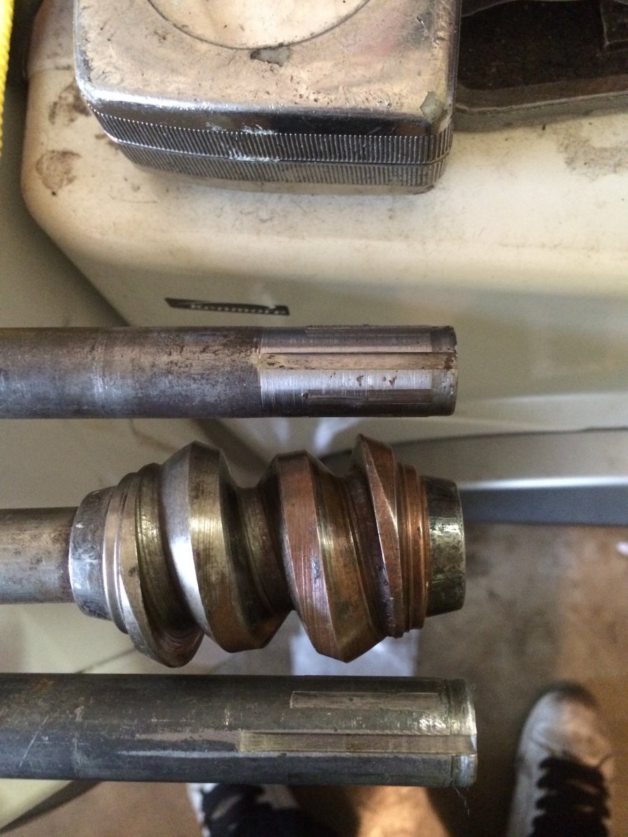

    I'm finely finishing up the steering box and colume. Early on I was going to change to 34 worm and sector gears but I found a big crack in my 34 sector shaft. They are aftermarket and so that made me go back to my 32 gears. I have 2 32 and one cracked 34. One of my 32 is right hand drive so that does me no good. So I'm stuck one just one set of good 32 gears. Later down the road I will change over to 34 if I can find a good Henry set. I'm ALSO going to use the 34 steering shaft. It is one inch longer. That will in theory allow me to pull the steering colume up really tight to the firewall for the side shift trans forks to clear the head. Without having to re design the bottom of the colume. So the steering wheel also be 1 inch closer to the seat. I had it all mocked up and it works really well so now it's time to finish the rebuild on the box and stab it home for good. Just need to finish this and the front brake lines and it's time to run her up and down the street.
  11. So I tried to follow Dennis lacys thread in his steering box rebuild but he used a big puller to pop off the worm gear and then used the same puller to put it back on. I don't have a puller that big so I went ol school and used a hydraulic press to push the gear off then I put it in my lathe and polished off the burrs. I went even more ol school and put the worm gear in the freezer over night and then hit the shaft with some heat and it only took a few taps with the hammer and piece of wood. I didn't heat it up red hot just alittle to tighten up the metal. image.jpg image.jpg image.jpg All done.

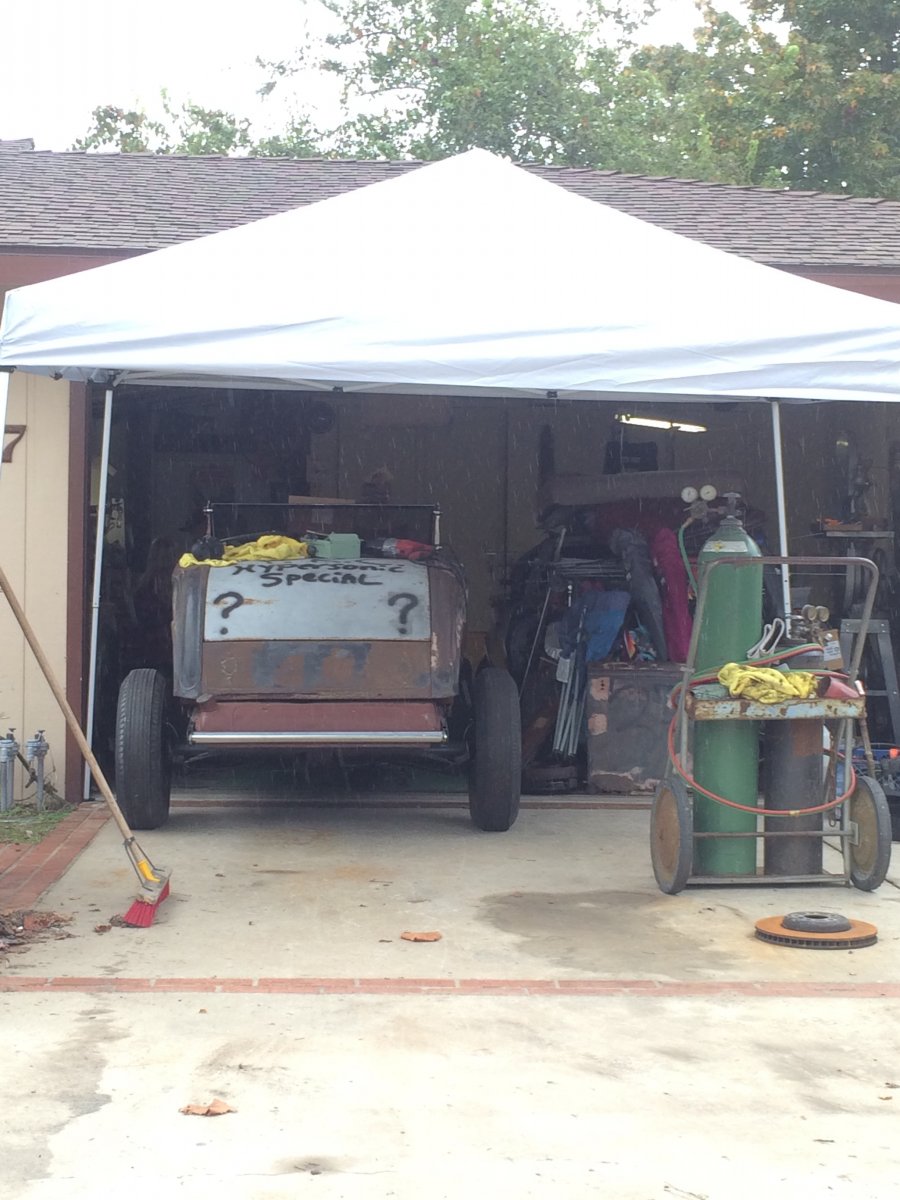

    Me too Dennis. I got Cory over he's finishing the seat frame in wood and all the brackets we are making to original specs. Had to back it out of the garage alittle and put up a pop up because of this weird stuff falling from the air. I thinks it's called rain but it never rains in California. Only one awesome days like trog events.

  14. Hey Bruce - gotta ask, why were you shrinking the worm gear and heating up the shaft? Isn't that b***-akwards? I must be missing something - which is not unusual! LOL
    bengeltiger and Runnin shine like this.
  15. Well the steering shaft wouldn't fit in my freezer. Lol so if figured as long as one hot and ones cold it should work. And it did every well. Not sure. I guess I just like to do things backwards.:D
  16. Normally you want to increase the ID of the worm (so you heat it) and shrink the OD of the shaft - so you cool it.
    But hey . . . sometimes backwards works just fine! LOL (Story of my life in some cases - I entered this world as a 'breech' baby. LOL).
    paintslinger805 likes this.

    I was wondering the same thing, the fact that you got it together makes me worry it is too loose of a fit. is it just the interference fit that holds the pieces together?
  19. No it's super tight. It's a pressed fit. I checked it with a small puller and I could of bent the small puller before it would of came back off. There is also a key way on the shaft. Maybe I just got lucky again...

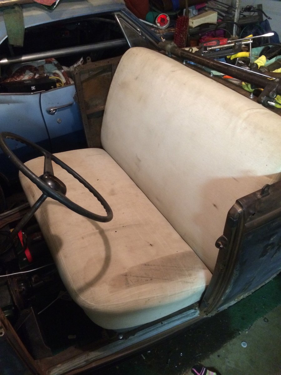

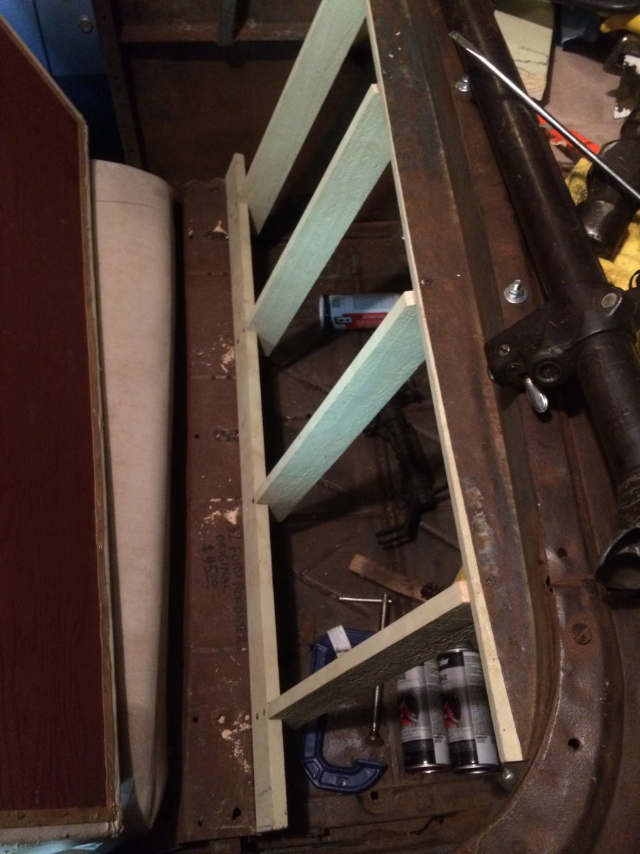

  20. image.jpg image.jpg image.jpg Seat frame is all done thanks to my brother Cory.
