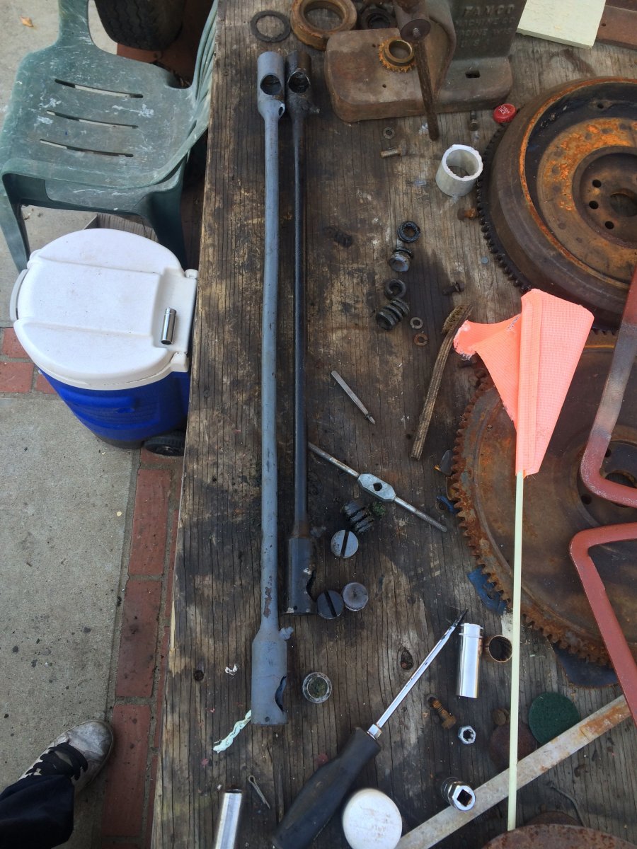

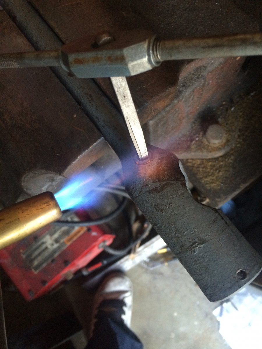

  2. image.jpg image.jpg image.jpg image.jpg Update: just working in finishing up the front end. I just had a 34 drag link and a few weeks ago I got a 32 for 40 bucks. Both springs in the 32 drag link were broke so I took apart the 34 and found really good springs so I got lucky there. I'm cleaning all the old grease out and saving it for my hair as it's probly 50 years olds. Had to get a broken grease Zert out with some heat. Now I paint it and put it back on car and bam! Done. It's got a couple of waves in it but so does the ocean.:D

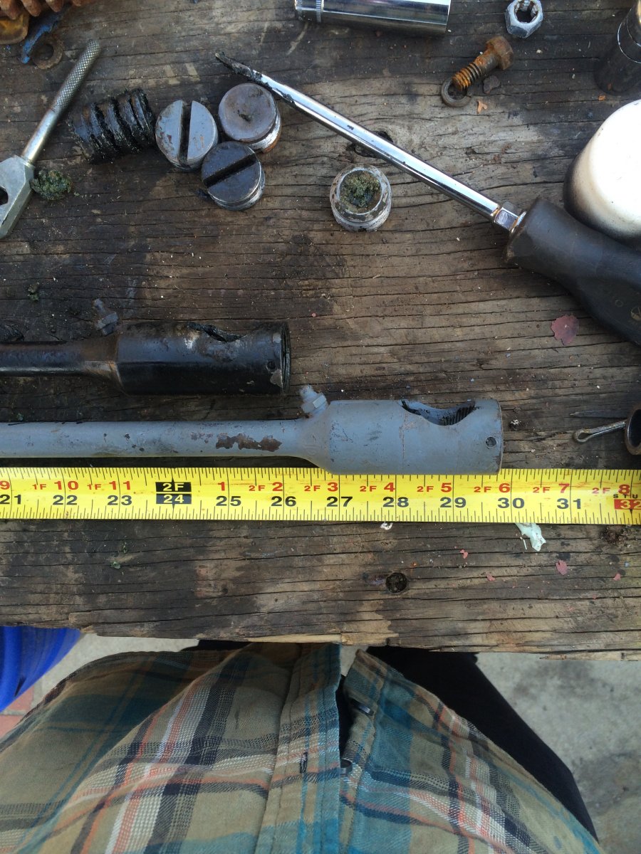

  3. image.jpg Well I take that back looks like this drag link is about 1-1/2 inch to long. It did have a tag that said 32 pickup on it. Maybe some one can measure there's on there car and tell me what it is supposed to be. I got one too short and one too long damn it!!!!!!!!!!!!

  8. Hey Bruce - will go measure mine and also review the clocking on the pitman arm. I can't remember if one can index the pitman arm "wrong" - but worth checking out. Be back to yah . . .
    paintslinger805 likes this.
  9. Thanks dale. It's a real bummer I got two I can't use without cutting and welding on them and we all know that ****s. Once I know exact length I will be on the hunt.

  13. Well cyclone Kev, measured his and it's 29-11/16 like mine but his pitman arm is clocked back alittle and my front axel is bent back on both sides p***ed the perch pins. So I will play around with it. My other is a 34 at 26-1/8".

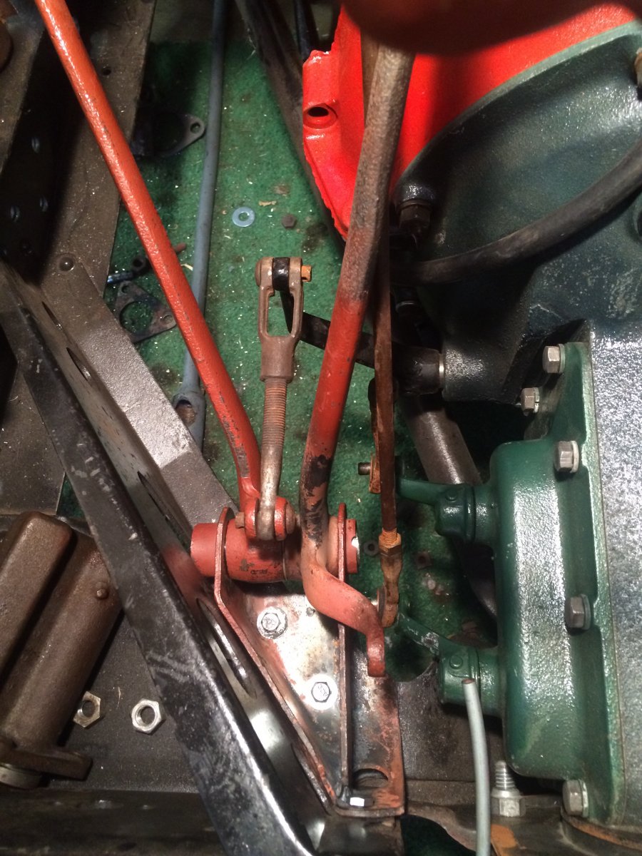

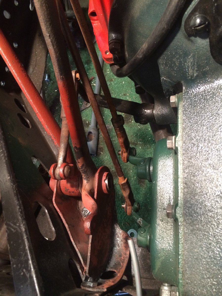

  19. image.jpg image.jpg image.jpg image.jpg image.jpg image.jpg image.jpg image.jpg image.jpg Did alittle r&d today with my brake set up. I kept Henry's mec. Brake set up and re engineered it to work with hydraulic master cylinder. I had to take it completely apart to flip the spring over so it would push back and not pull forward into the master cylinder. I only have one spring so I didn't try and bend it out and off the shaft, seemed to hard and wanted to break if I tried. I put the master cylinder backwards inside the left k-member hole. I did no WELDING to the brake pedal or mec. Brake lever. Only cutting heating up and bending, and grinding and there is NOTHING hanging down under the car like a master cylinder. Look over the pictures. I think it's the best way to do it. There are other KITS out on the market but is rather have Henry ford steel. Welds can and do break and I'm not one to trust welds on brake parts if I can get around it. In the pictures you can see how I took it apart and flipped the shaft and spring over. Then I cut off the ears I'm not using. Also had to heat up the ears I am using and bend them straight as they are bent at an angle for the mec. Brake rods. Tomorrow I should have it all bolted up. I have to get a couple of parts to finish the rods.
    63fdsnr likes this.
  20. image.jpg image.jpg Here you can see the difference in the pin and spring. It's hard to hold with one hand for the picture from the spring pressure.
    63fdsnr, Stogy and Hitchhiker like this.
  21. Looks like it should work to me . . . nice design process and thinking it through. I like the fact that you'll have the cylinder hidden inside the frame and not handing down (that is cool). I'll be using an aftermarket kit - so it will hang down just a bit . . . Argghhhhh.

  23. Yo Bruce - is that a regular 40 Ford type master cyl? Kind of looks like it . . .
    D
  24. Yes dale I have a couple nos master cylinders and a few rebuild kits. I can rebuild for the rest of my life with nos ford kits.
