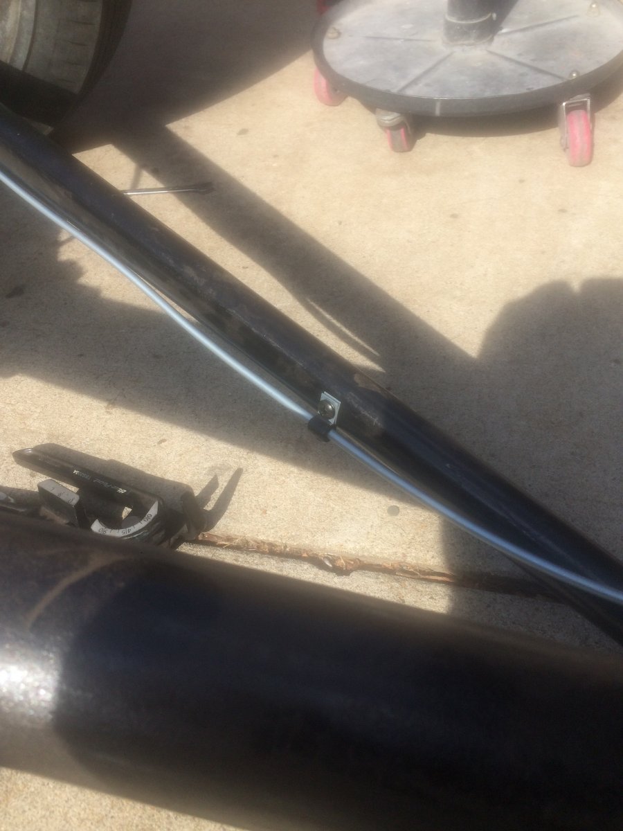

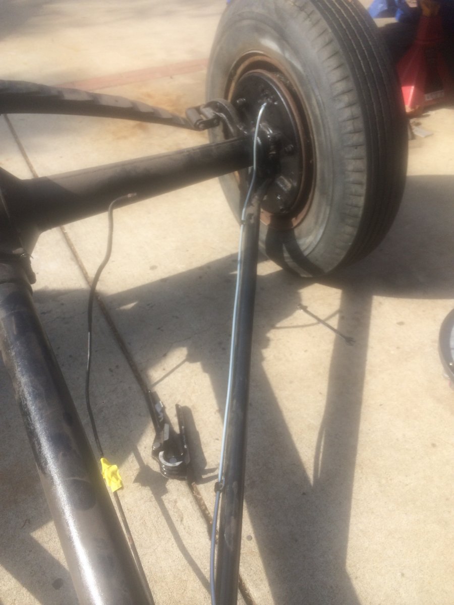

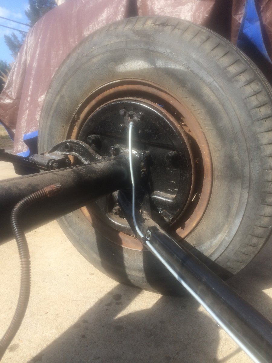

    Great thread - enjoying the journey. But, sorry to be an arse, but the wheel cylinders are in backwards - the big end should be towards the front. The pipe should enter from the rear.
    I made the same mistake myself. It certainly makes a neater installation with the pipe going in from the front though.
    The rule for early ford brakes is big end of cylinder and long shoe to the front.
    Mart.

  19. Thanks mart. Iv seen lots of rearends done the same way at the hotrod shows I go to. Iv asked guys that done it this way and they all say they can tell no different. Even had an old timer that I know real well say he always thought they worked better that way. Kind of like a garden hose the smaller the hole the more pressure. I will give them a go like that and if I can't stop then I will just go faster.... You Gotta to crawl before you walk.....
