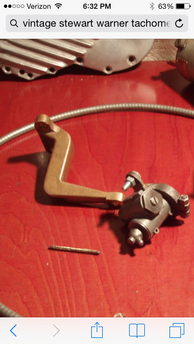

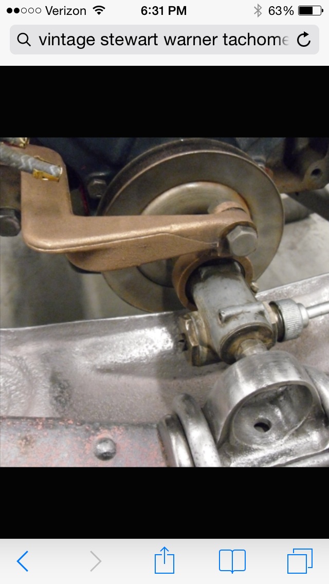

  7. image.jpg image.jpg Well dale did some google ing and looks like I'm missing the bracket to mount it to the crank check it out. I'm gonna call my friend tomoorow and see if he knows about it.
    volvobrynk and timmy2times like this.
  8. There yah go! I'd much rather have a crank mount setup than anything else . . . IF it fits where your engine is mounted and clears the front cross member. (Which it should as you've used stock mounts) :)
