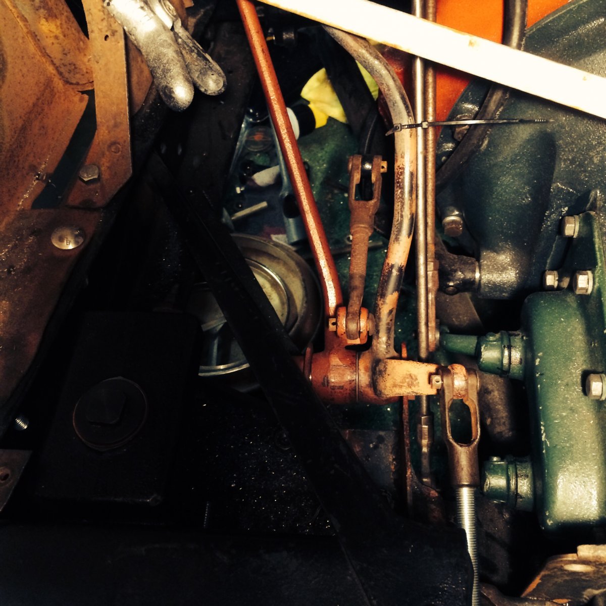

  1. image.jpg image.jpg image.jpg image.jpg Master cylinder done...... Time for some clean up work and build the rest of the motor mount. No rain this weekend so it's gonna be time to hit the streets........................::::::::::::::::::::..:......
    And yes it works like a charm. All the geometry is spot on. I couldn't of done better myself. Wait I did do it myself. Never mind. Carry on.:p:p:p:p:p

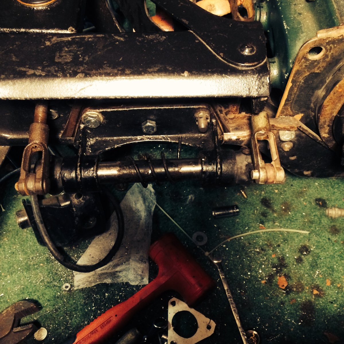

  2. image.jpg Here's the best part nothing hanging down under the frame.ohhhhh

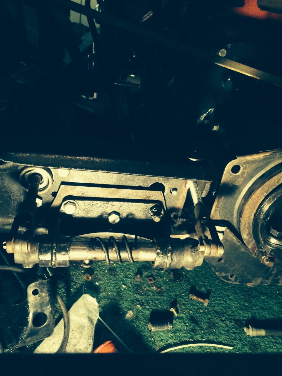

  3. image.jpg Sweet Jesus. I'm un stoppable.
    This will be in her tomorrow. It's all the little things that make it the
    "Holy grail" hotrod....

    You should patent your setup, Bruce. I think I commented earlier on this, but it bears repeating. You have the first such creation yet it will be on lots of rods as time passes, I'll bet. All Ford parts ? Henry would be proud of you. Here we go ! !

  11. I'm happy with everyone here on the hamb seeing the brake set up before I lay down the wood floor. I thought about how to do that for a few months now along with everything else iv done . And once the floor is in it's just another 32 roadster with juice brakes. Guys that are in the know will look it over up and down at shows and wonder how it has juice brakes when they look under the car and don't see anything hangin down. It will make good talking piece. It was a lot of work to make everything fit and get all the geometry right with the pedals, shift rods, and master cylinder set up. If I start seeing people copy me then in my own mind I will know what I did was worth doing kinda like back when my grandpa was playing with his car when someone in the club came up with something new that worked everyone copied it. So copy on y'all. Maybe I put lexan floor in it so everyone can see it.

    PaintSlinger I for one always appreciate the creative genius of mankind. If I was to duplicate what one has done I will give them credit and praise of having great intellect to create or find an adequate solution, robust enough to safely execute it's required purpose. I would also be proud of just replicating with integrity what you or others have done. I would never boast and make false claims...its a form of ethics. Thanks for sharing your ingenuity...and otherwise...;)...oh and throw a vintage plexiglass aviation window in the floor...why not...

    Really nice brake setup, takes away any chance of linkage failure.

  15. Looks like I'm not the first to do it. Great minds think alike. Looks like that set up has no return spring and a billet master cylinder sticking up higher than the floor would be. I used a 40 ford master. I like my idea better. Billet is for street rods.:D Those weren't for sale in 1948.
    I'm not the first nor will I be the last. I can't take any credit for it unless he just built that last night.;)

    No, I'd flick the billet junk as well, I like your setup but I'd probably run a dual circuit master just for peace of mind. Keep going with the build, love it how it's progressing.

    Looks great. Just one thing, put a lock nut or a tack weld on the threaded rod between the brake pedal clevises. That stuff has a tendency to unread itself from vibration.
