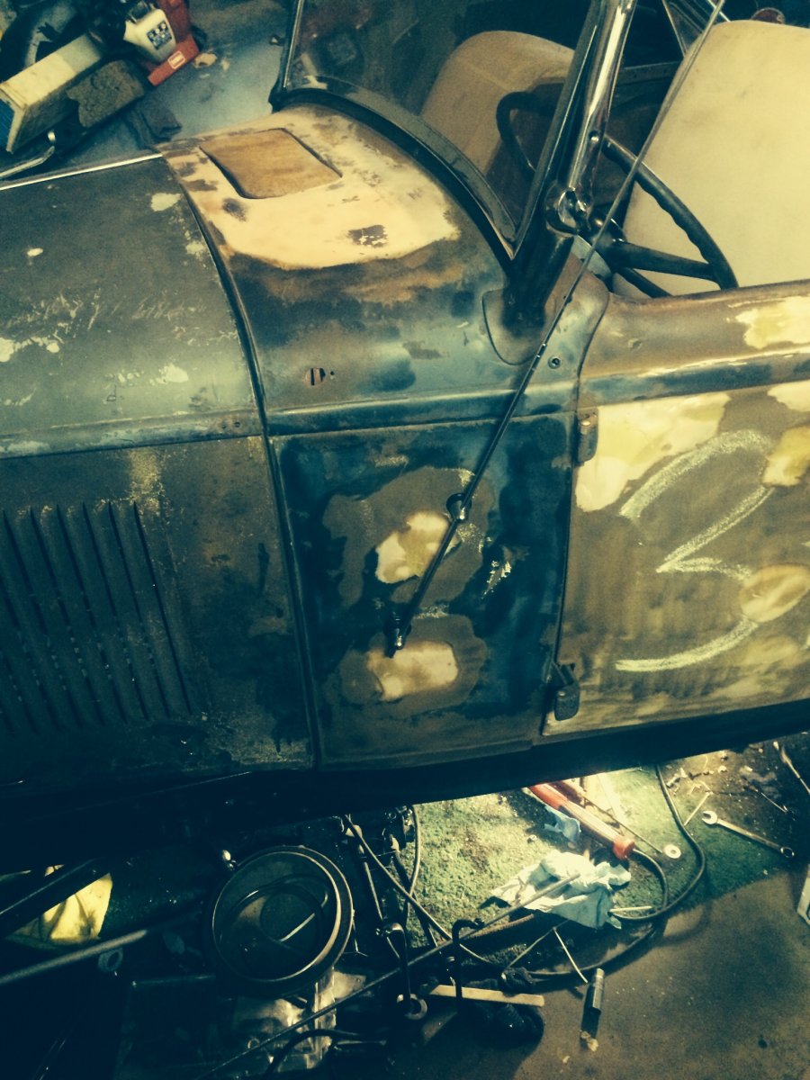

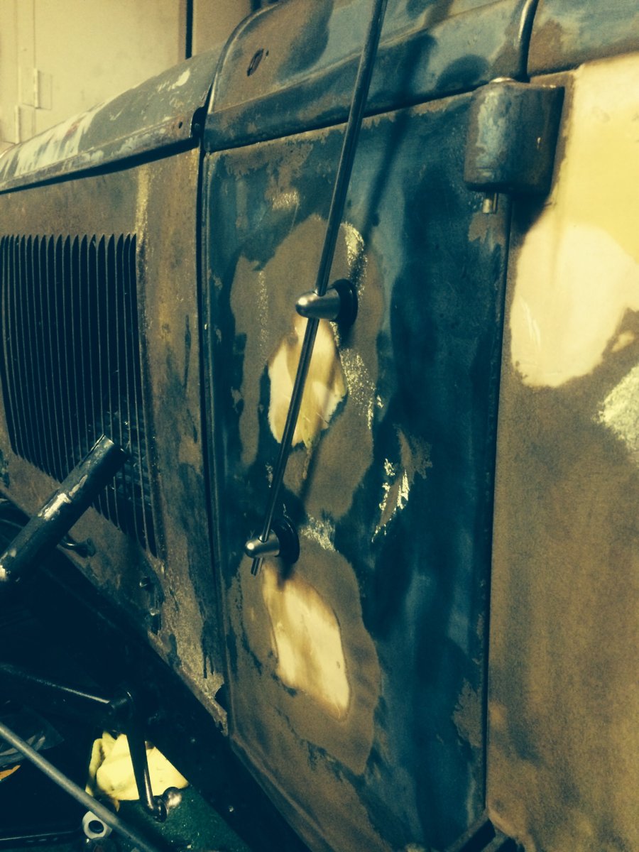

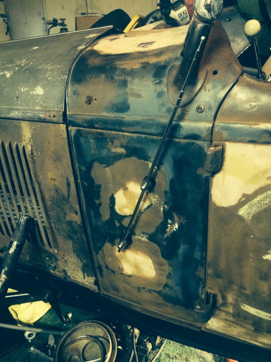

  5. image.jpg image.jpg image.jpg image.jpg image.jpg Here's to you Dennis... It's just like grandpa had. One more time period job well done. Thank you so much Dennis.
    Now I can communicate back to earth when I go HYPERSONICCCCCC....
    Are y'all pickin up what I'm puttin down. Roger that over.......

  7. 383deuce
    Joined: Jul 10, 2009
    Posts: 3,668
    383deuce
    Now how cool is that!!!!!!!!
    Glad ya liked it..and very glad it made it to you...Had me worried as you just don't see them these days.

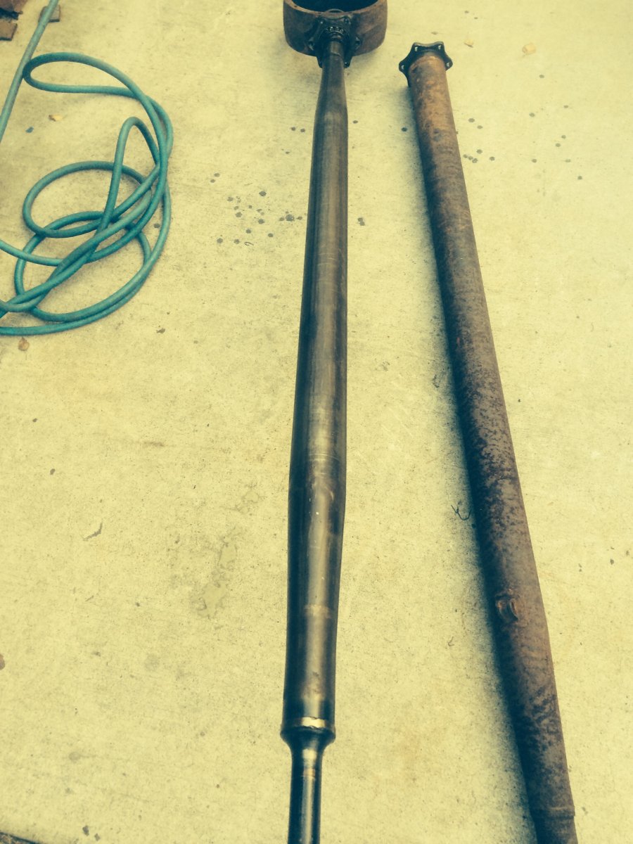

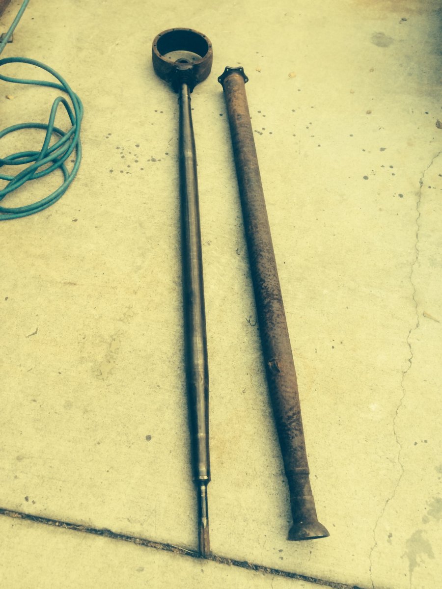

  8. image.jpg image.jpg I got this torque tube a few weeks back and just now tore it apart to get the drive shaft out and it's not a solid one like in the roadster already, it's a tube style. Dammit. Now I have to find another one. I need about 2" longer tube and drive shaft because the one that was in the roller ch***is I got someone cut it too short or they use some other style transmission but with everything I got hooked up the rear wheels are about 2-2-1/2" infront of where they should be. So maybe I will split this tube and turn them into the exhaust tubes everyone goes crazy for.
    Runnin shine likes this.
  9. The pinion gear and bearing is very nice so I will shelf it until I find the right quick change center section.

    Bruce, the drive shaft sounds like something I could find around here easy, but shipping would kill us on it. So I hope you can find one out there.
    I like the idea of the quick change as I am sure Elmer would have had one in Hypersoniccccccc if he could have swung it back in the day. Over & out!
    Dam that antenna is working all the way here in Nebraska...
  11. No worries Dennis the guy I got this one from has one but it's attached to a 354 geared rear end and won't just sell me the drive shaft I have to buy the hole rear end. So I guess having another extra 354 rear end won't hurt.

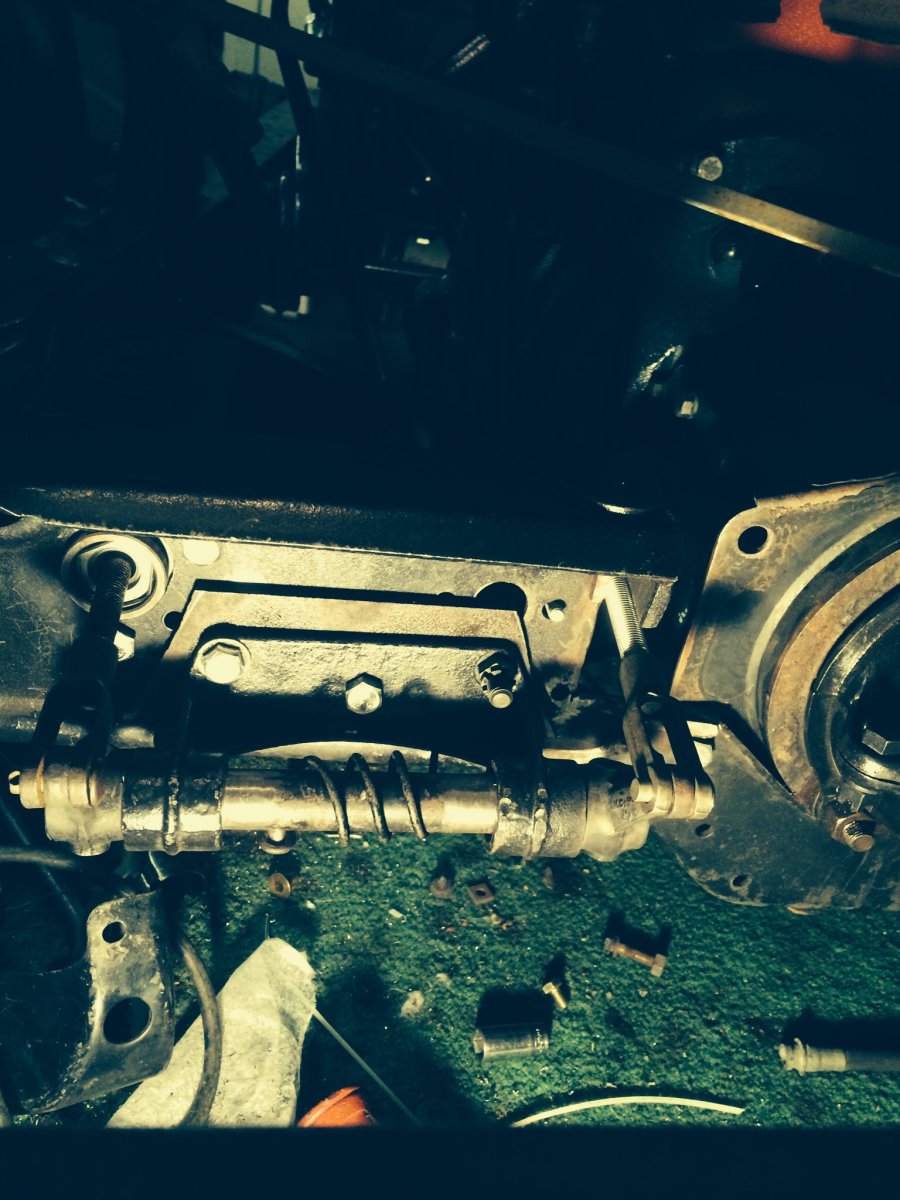

    Tim I'm only using the 32 mechanical brake lever system to connect the brake pedal to the hydraulic master cylinder. From the master cylinder out to the brakes is normal brake tubing with brake fluid in them. I did this so I didn't have to cut and weld the brake pedal and then have a master cylinder hanging down under the car. Check out this picture and you will see the only part of the mec. Brake system that I used. When I push down on the brake pedal it pulls the lever and pushes in on the master cylinder. It's just a lever system. I hope this helps ya out tim.

    Yep, I got it thanks. And a very good idea and use of a part that would ordinarily wind up at a swap meet.

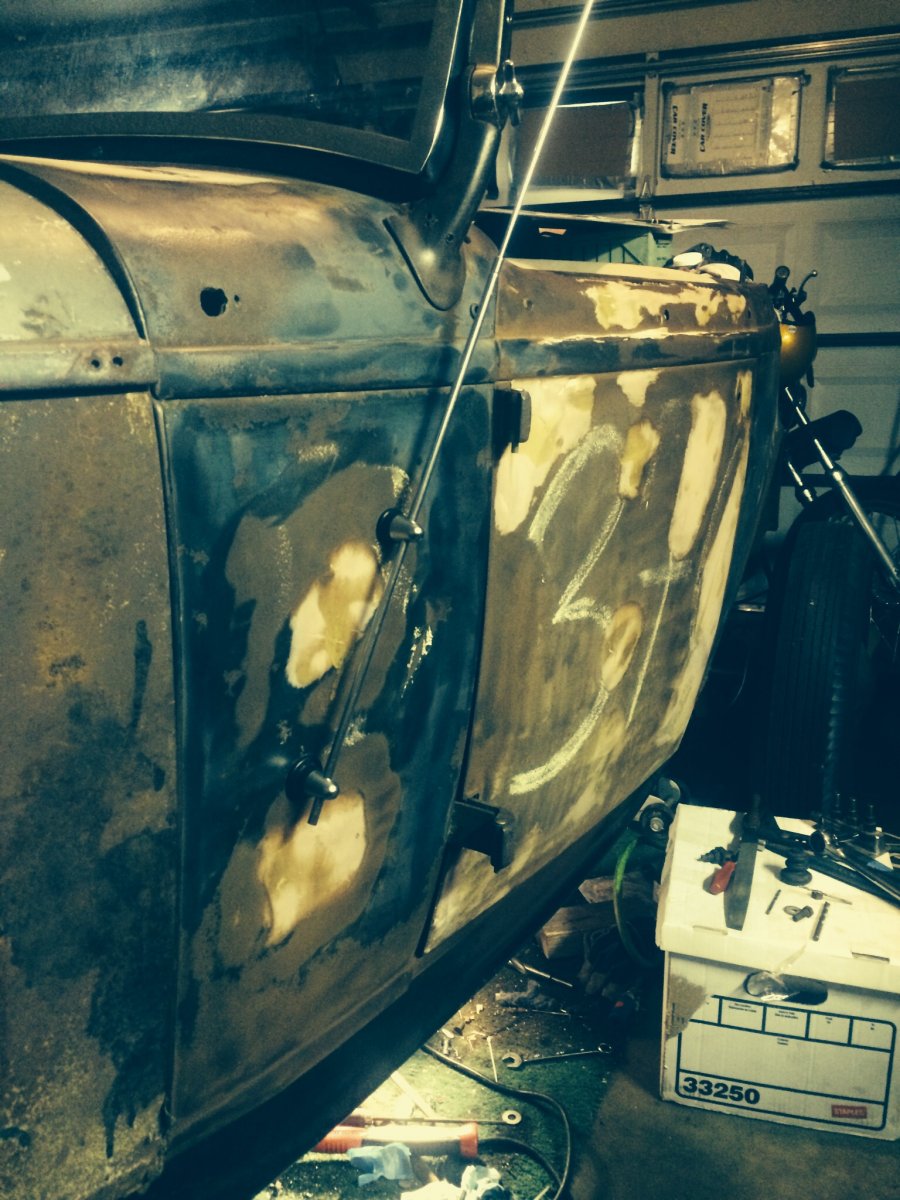

    Looking at he Bob Drake one better shows like a small ball tip at the end and if I recall yours did not have this. You might just have to make one so it will be period correct.
  28. image.jpg Dennis it has the ball on tip just doesn't have the little bullet looking thing on bottom as in the drake cat. Who knows it it ever had one. All I know is it's done and and the car. I say job well done.
