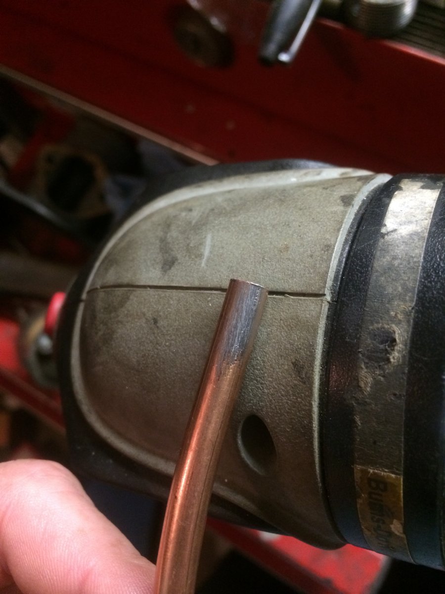

  1. image.jpg Here is a piece of the steel/copper coated line. I scratched off the copper to give y'all some relief.
    Copper lines are ok for the oil system though right????

    I think it was the rigidity of the line going directly from the engine to the bracket on the firewall they were concerned about. As long as there is a flex line going from the engine to the hard line at the firewall bracket I believe they'll be happier. (All hard line would develop a leak soon and nobody wants that!):cool:

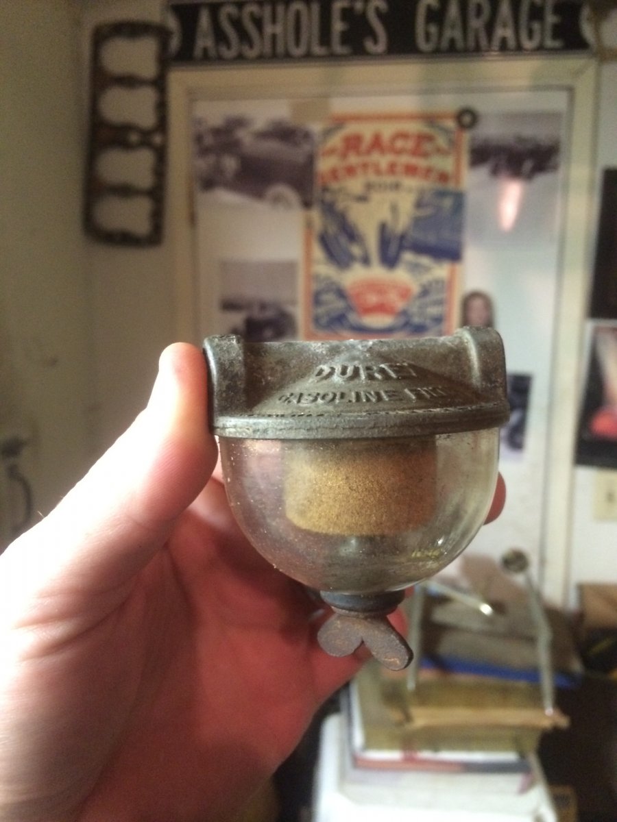

    Durex huh...up this way they don't filter gas...:p Whats in a name...I remember the Lancaster Bomber I worked on had Merlin engines with Maytag rocker covers...during wartime many companies moved from regular production to wartime ***ist production.
    You might want to have a extinguisher mounted incon****uously...myself included.

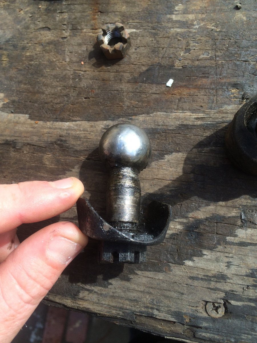

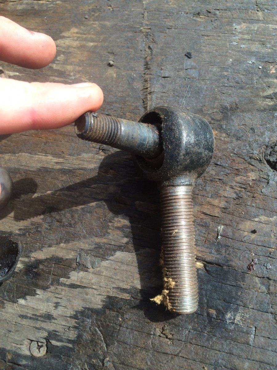

    Question - when it comes to tie rods and drag links, when did the more modern "ball end" come about instead of the original ends like you have pictured on this page?
  12. image.jpg image.jpg I belive picture number 1 "ball end" was used up to 1934. And the other picture number 2 started in 1935 on ford cars. Hope that helps ya out.
