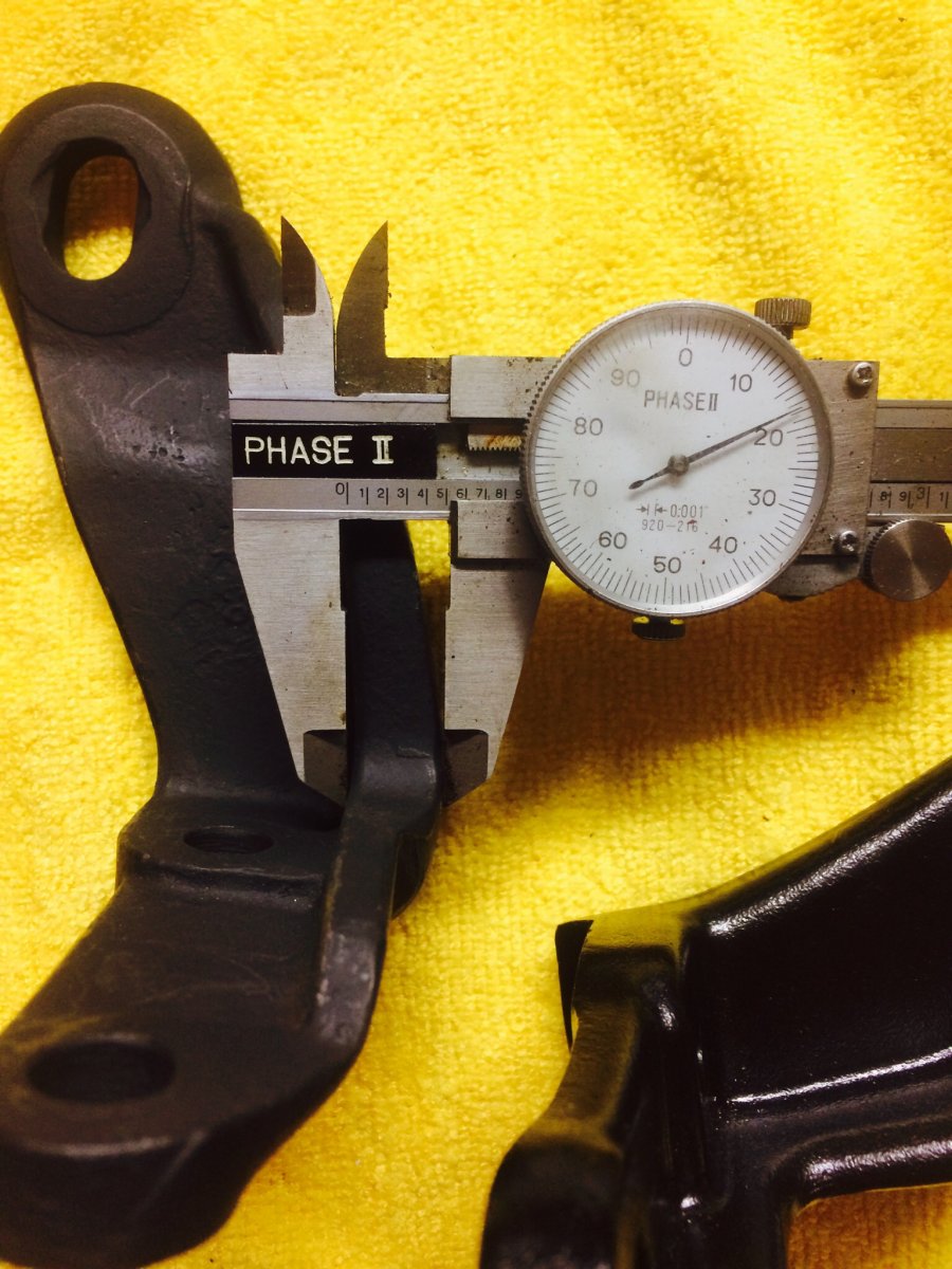

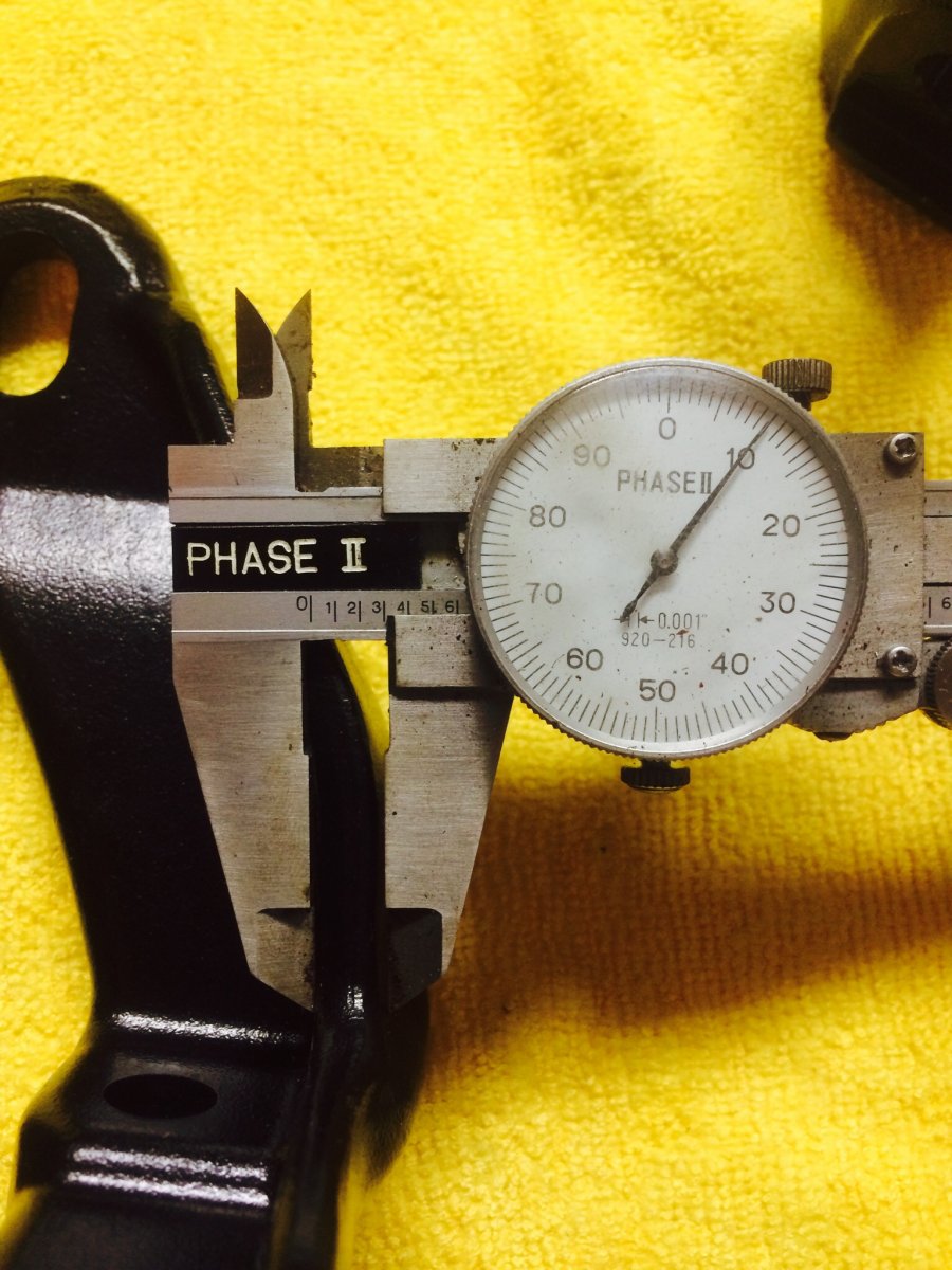

  9. Well hotcoupe you must of seen my mastercylinder in the web. I'm going to make the 32 mechanical brake thingeee that hangs down from the back bottom of kmember work for the linkage. I'm gonna cut it and shorten it so It all works without binding. Iv been studying it for a few weeks and I know it will work. I will post pictures of it when I'm done. And yes I will only use a 32 crossmember with the motor mount cups. I bought bob drake repo motor mounts then got a real Henry set with the new ch***is I bought. It's funny because the repos are about .140 thinner than the real Henry's. I will post pictures of them later tonight when I get home.
  10. Hey hotcoupe here is the difference in thickness between bob drake and Henry ford motor mounts. This is in the gusset area. So what's that about .210 difference. Anybody want to buy these bob drakes. image.jpg image.jpg image.jpg

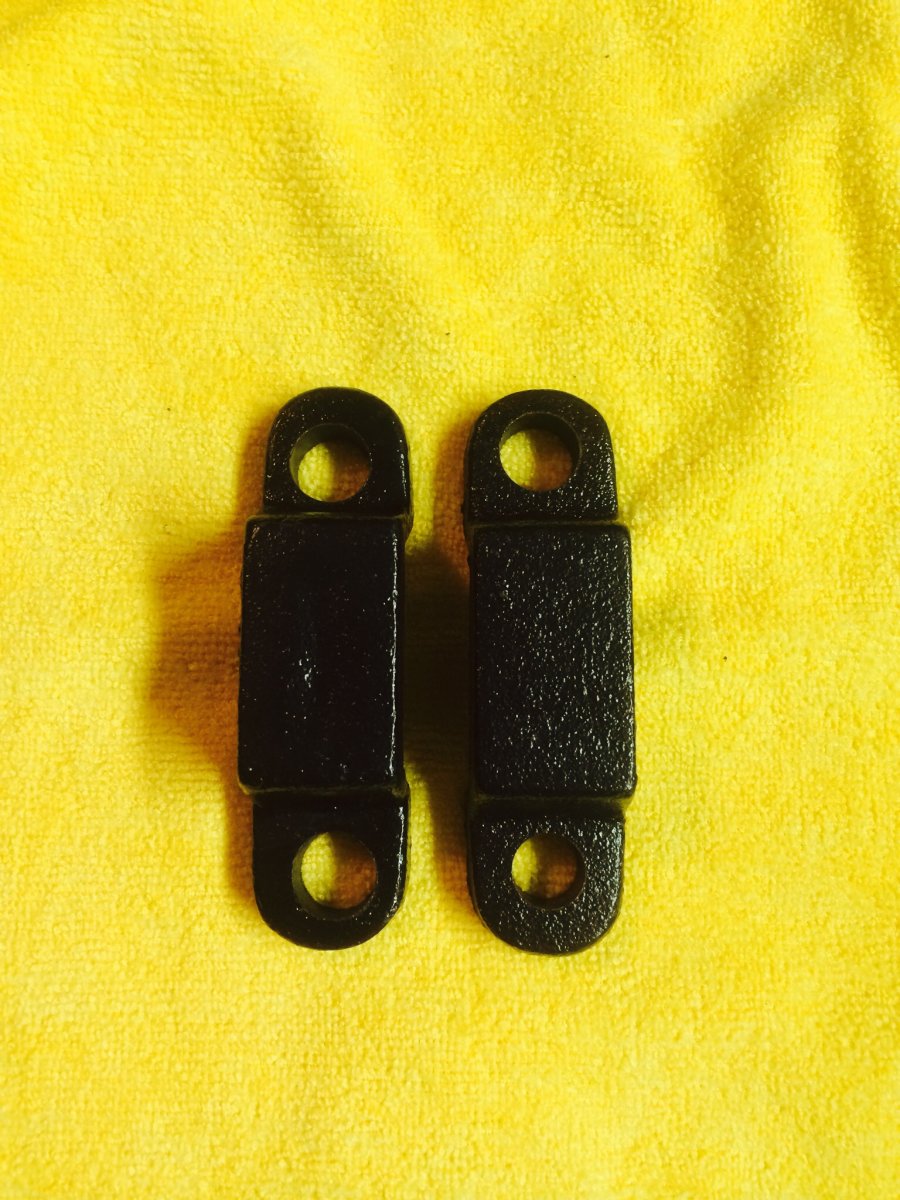

  11. image.jpg Also how about these great china pieces. Bought these at early ford. None of the holes are in the same place and one hole is not even the same size. Just junk I could really use a pair of real Henry ones. These are the rear spring blocks.

    Yeah, we have those too. Seriously, make a shopping list, haha.
    As for the Bob Flake engine brackets, I'm not surprised. Besides having a thinner cross section, who knows what the material quality is like? Flake says they're forged but there's a big difference between forged 2015 China and Forged 1932 USA. Think of the job these little "L" brackets have to perform. You're 100x better off with gennie Ford parts. Even still, many times the Ford brackets have cracks in them. Definitely bead blast or somehow strip them to bare metal and take a close look. The ones I just put in my Deuce Pickup both needed some small cracks V'd out and filled.

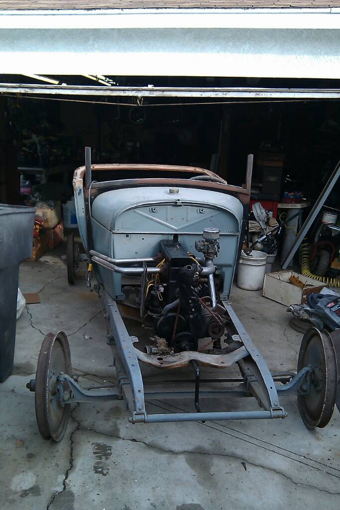

    This is it going into the trailer. Model A front, to go on and 32 wire wheels. That's a 28 Chevy frame and gear. Lots more stuff.
    I have 4 of Don's books, it should be in one. My dad's was.

    It is actually is a 28 someone put the early axle, bet that would be a good story. The brake mechanism is still there, only goes to the rear. Lol A guy rescued from somewhere in middle America and would go around selling to the highest bidder. I have some 25 racing stuff also. Have fun

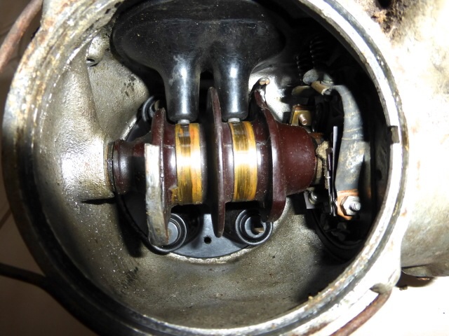

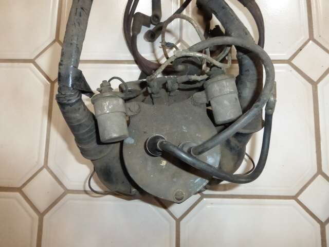

  19. image.jpg image.jpg Here is a picture of a zephyr one look at how the rotor has been modified it has also been modified for external coils. I guess I'm not sure as to this might be a ford converted to a dual coil using a zephyr rotor and coil pickup.

    paintslinger, the distributor you have is lincoln as the coil pad is different from the v8 unit

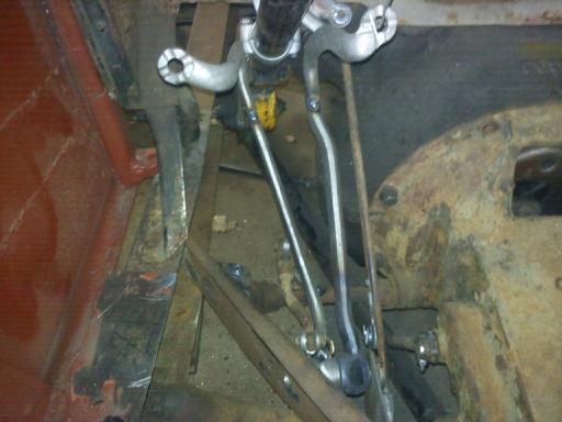

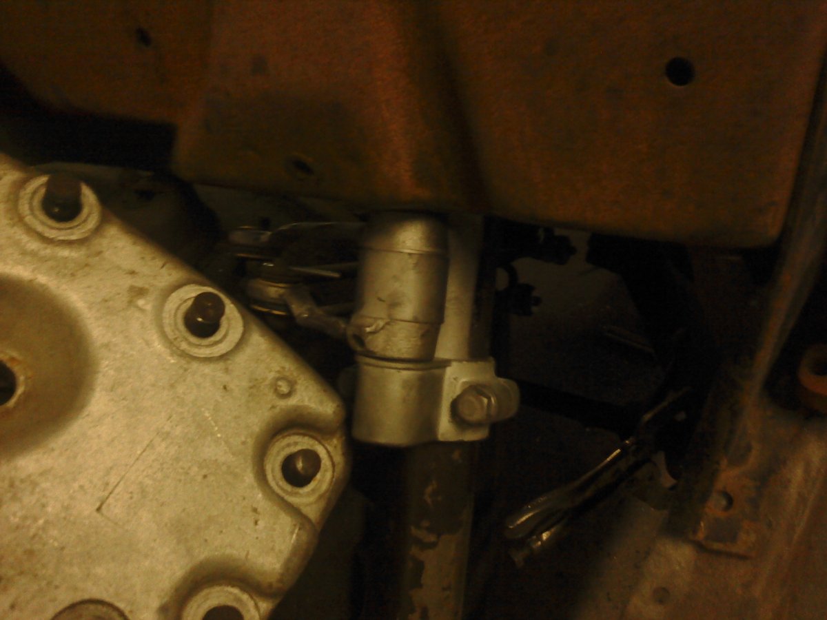

    im also running a side shift trans in my 32, heres a couple of pics of my pedals in the car, everything just clear and its shifts awsome!
    volvobrynk and Runnin shine like this.
  23. Het ***us did you have to notch you kmember at all for the back shift fork?

  25. titus
    Joined: Dec 6, 2003
    Posts: 5,199
    titus
    Yes i did have to notch the K member for the shifter lever, i can try and take a pic tomorrow.
