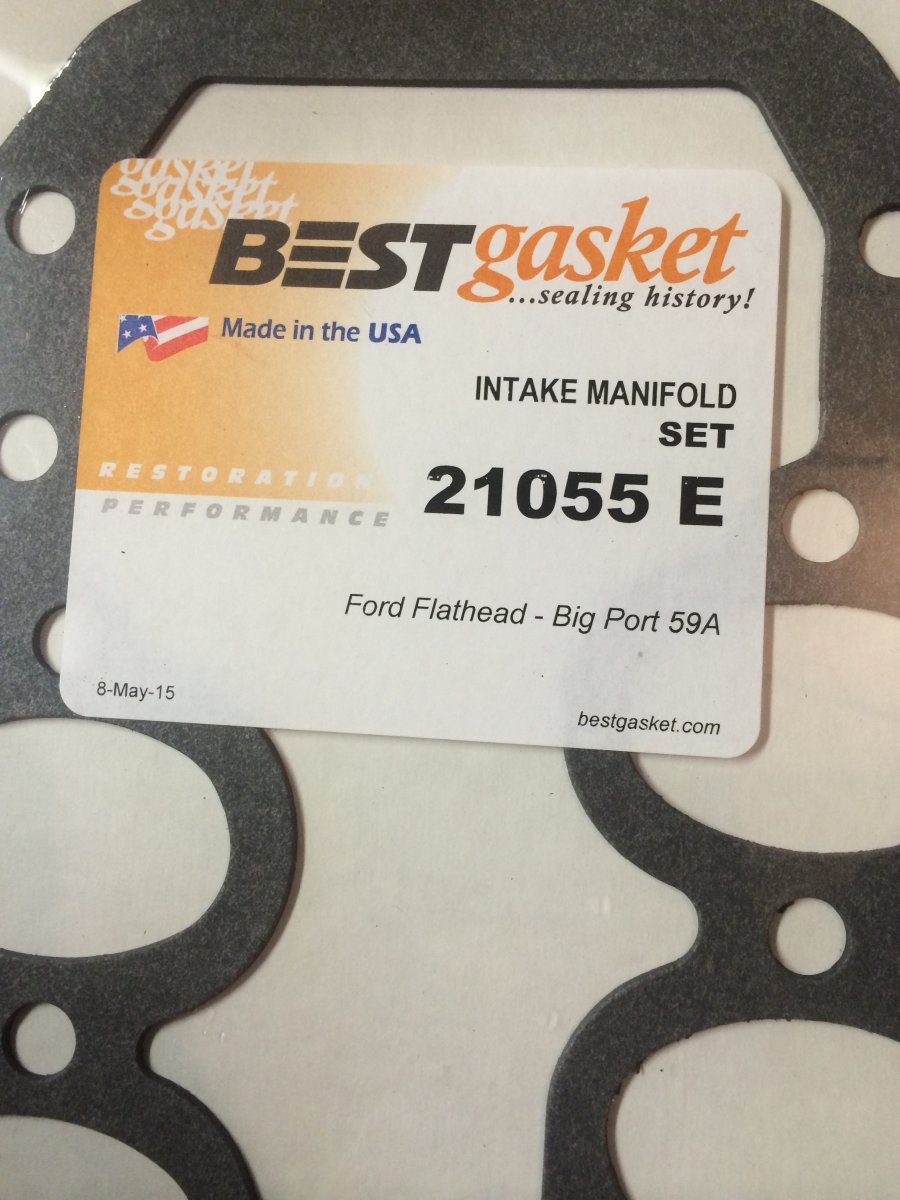

  7. image.jpg And for those if you who don't/didn't know, best gasket company makes a big bore intake runner gasket. This way you don't have to try and cut out bigger intake holes. But maybe some of us want even bigger holes might as well start out with the biggest they make right.

  11. Yes - exactly the one that I use. Then I take 4 short 3/8's NC bolts with flat washers the hold it to the block. Then take an X-acto knife and trim it away to match the block.
    Then, use the gasket to transfer the port shape and size to your manifold base. Then port the manifold base to match the gasket.
    I use carbide aluminum cutters for the major work, then the sandpaper rolls you already have for the rest. Don't go finer than 80 grit - you want the intake surfaces a bit rough. People love to polish the **** out of intake ports and runners - is actually the wrong thing to do.
