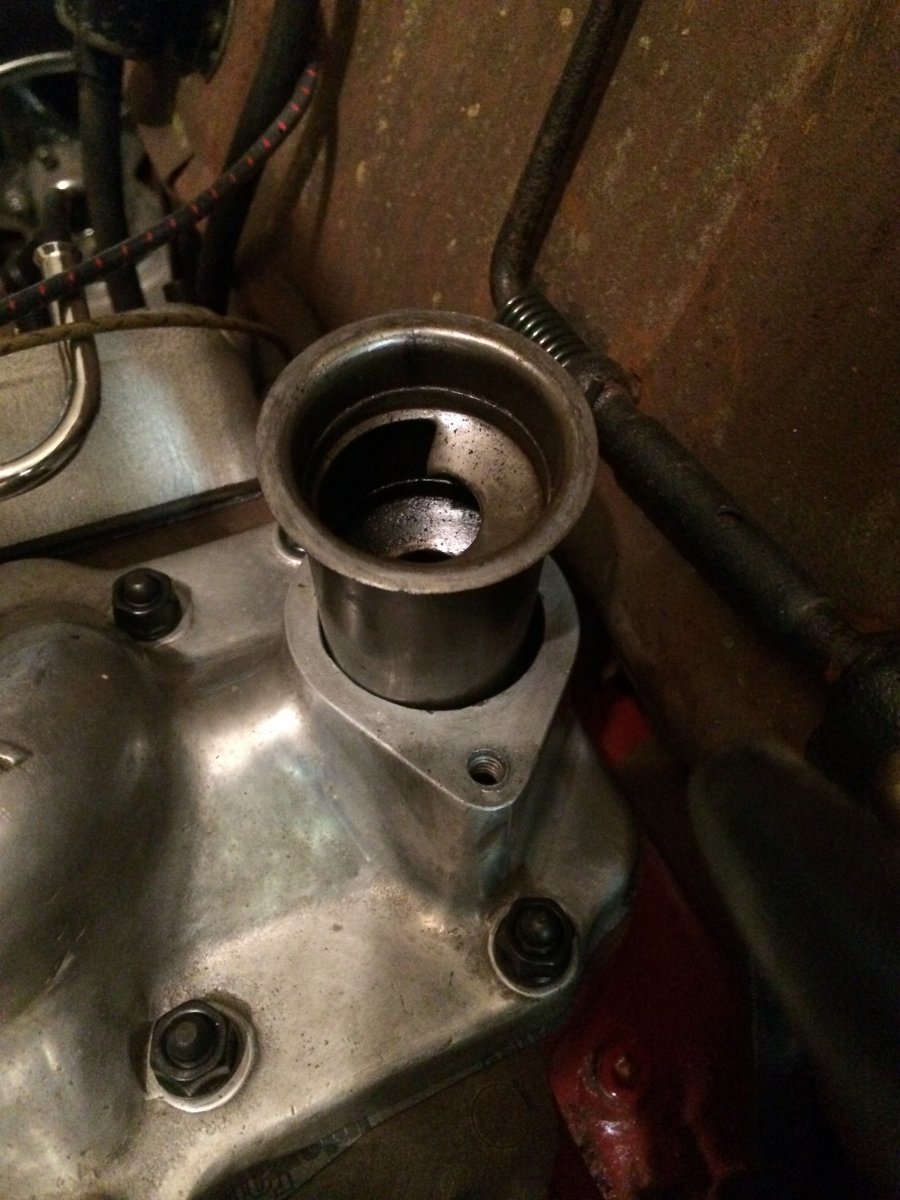

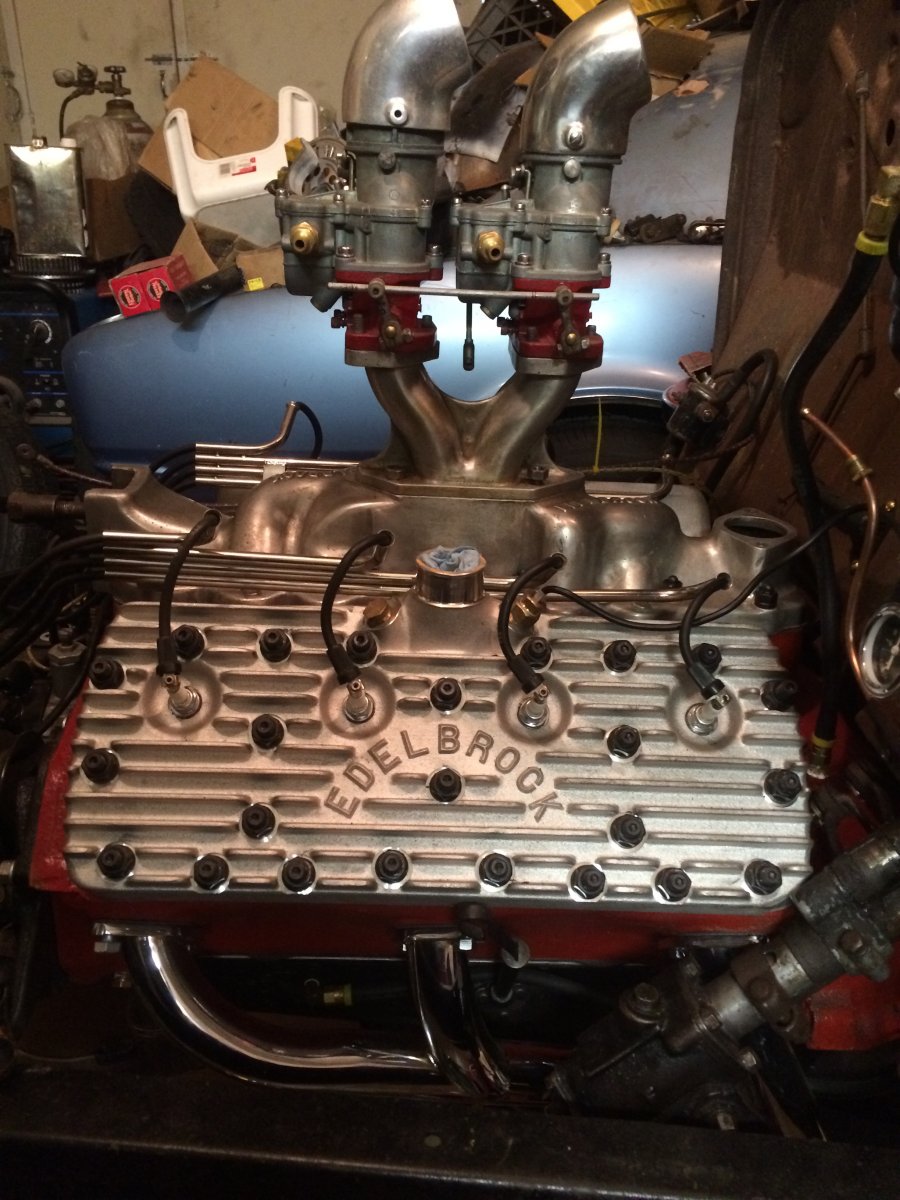

  1. Do you have the rear baffle tube to put down below the fuel pump? It helps to pull the vapors/condensation from the crankcase -- and not just pull it across the valley area. Everybody used to throw them away, but they are important for the fresh air system to work as it should (at least in a 59** series). Here is what I'm talking about:

  3. Make a gasket to go between the top/bottom of your manifold - don't want any vacuum leaks.
    loudbang and paintslinger805 like this.

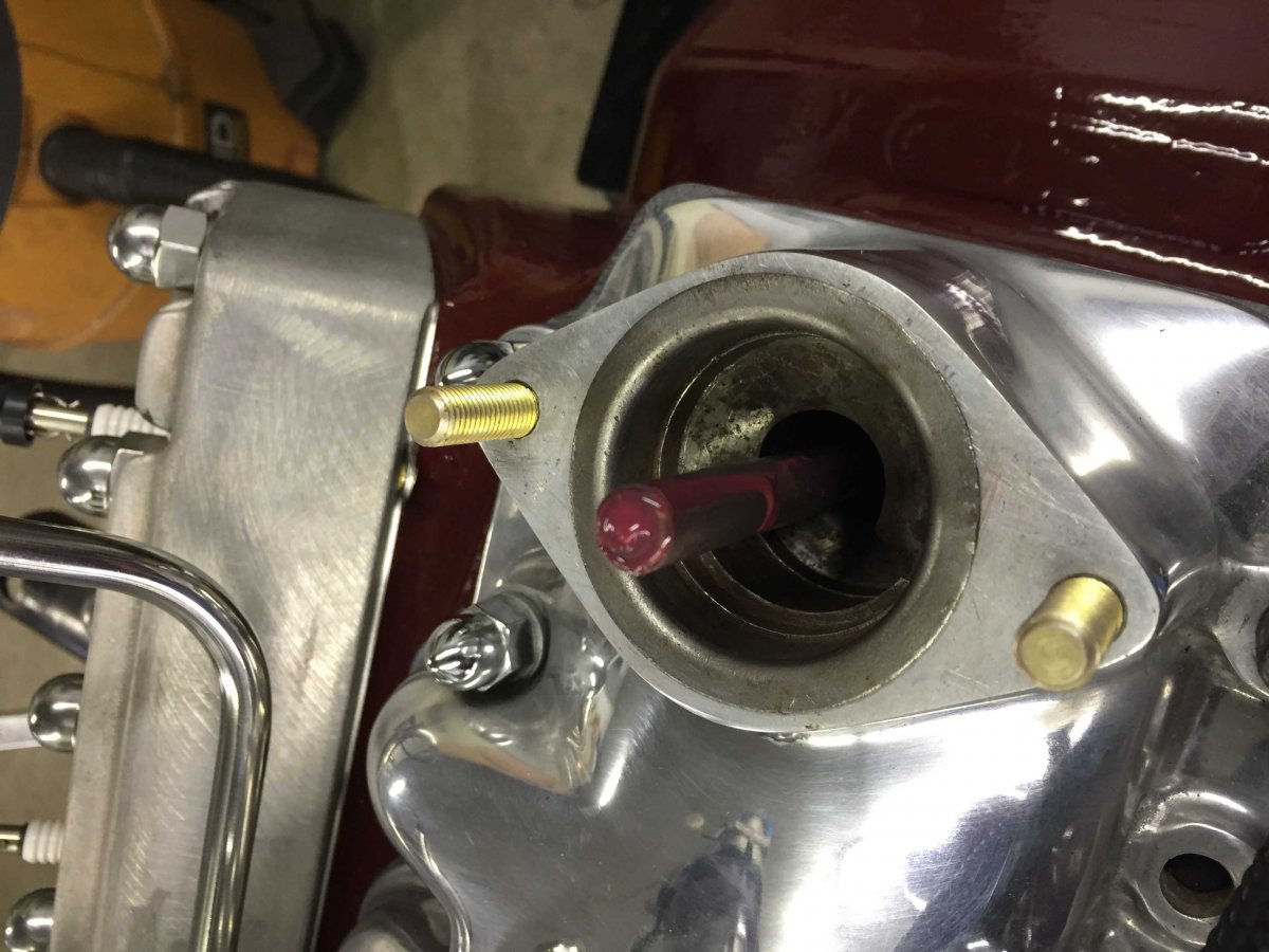

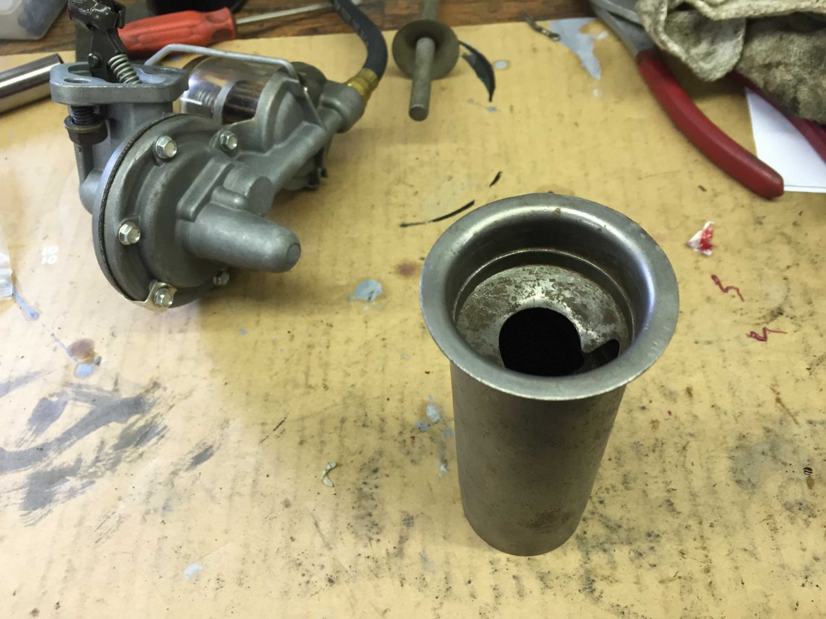

  4. image.jpg Yea dale I got the tube. I just happened to notice my fuel pump rod was bent alittle. I put it in my lathe and spun it and it's out if round. So I have to dive into my nos stuff. I know I have a few of them both sizes. So I'm gonna replace that.
  5. Edelbrock makes that gasket because of the repop slingshot. I ordered one from summit racing. Then I cut it all out to match.
  6. Perfect! Love that intake with your setup - really fits the car and it will run very well.

  7. I also got arp fuel pump studs. Lol 10 bucks for two studs and nuts. Wooh weeee. These flattys are expensive when you do them right.;) Grandpa is going to **** a golden goose when we hit the streets of Pasadena. The motor is so loud. If I could post video I would share a funny one of me saying that the first time we fired it. 383duece Dennis was here with me. I said holy fuc$ that thing is loud.:D

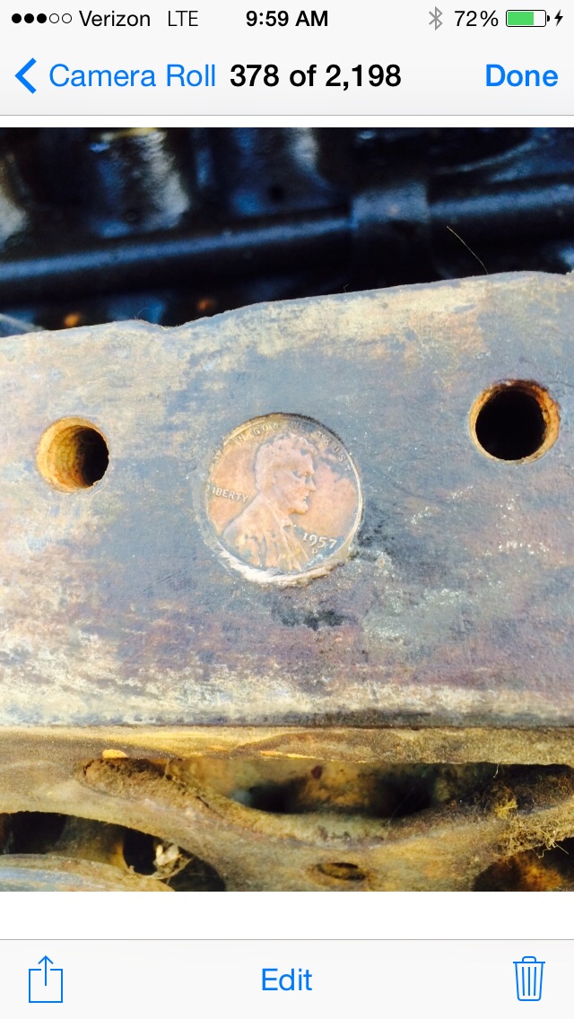

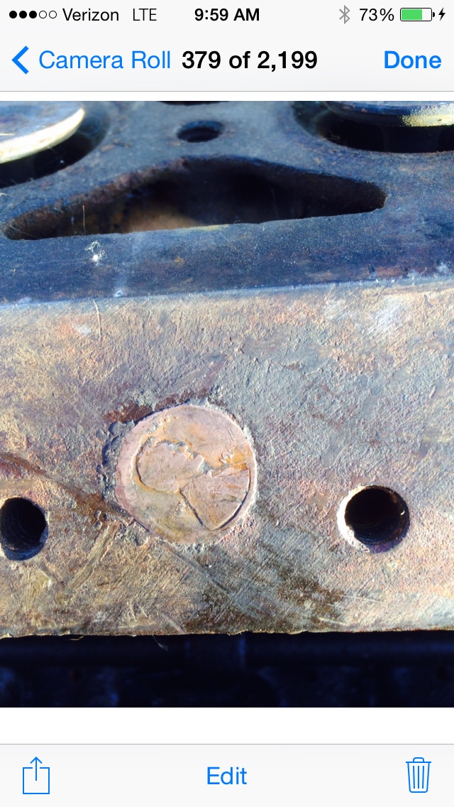

  8. Remember the block all ready had pennies punched into the heat cross over holes. Then the machine shop just decked right over them and made it all flush. So it's extra loud.:D:D Me likeieeeeeeee
  9. The stupid intake studs were 80 bucks. Now I have to go pan handle on the freeway off ramp so my kids can eat some rib eye steak tacos.:):rolleyes:

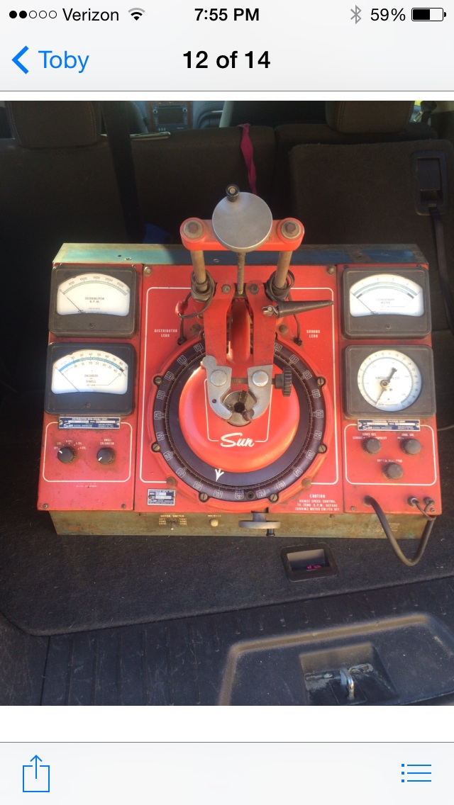

  11. image.jpg Hey dale did you see my sun distributor machine I got? It's a 600 model
  12. Pennies in the cross-over? Don't give out all the old racing tricks - LOL! Did you check the year of them first? I usually leave one of them in - if the manifold has heat risers - gets some heat up into the manifold which is good for cold days.
    If that Sun distributor machine works, you'll find all sorts of uses for it. I use mine to test all my distributors as well as standard output Vertex and Harman Collins mags. It is not strong enough to turn hopped up mags or a MSG Pro-Mag. I also use it to setup all my computer and digital ignition systems for track cars as well as Bonneville -- have a crank trigger setup that I made that mounts on an old distributor -- this fires all my computer systems and is used to test speed sensors. I'm currently making a fixture to turn my 20 Amp Pro Mags in the lathe, then I'll use the Sun as the crank trigger portion -- this will allow me to test them as well. I look like 'Dr. Frankenstein' over here!

  23. If I remember right my pennies were 47 and 51.
  24. image.jpg image.jpg Nope just looked back 57 and 4?
