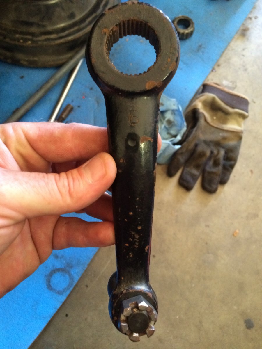

  2. image.jpg image.jpg Also found a nos 32 pitman arm.

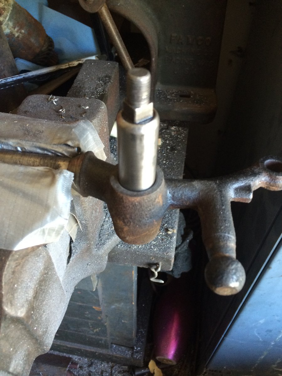

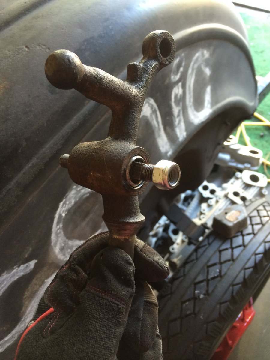

  12. image.jpg image.jpg Bushing were gone. So I'm doing it right. I want a nice tight front end. Reamed the holes and installing the good bushings. More to come later

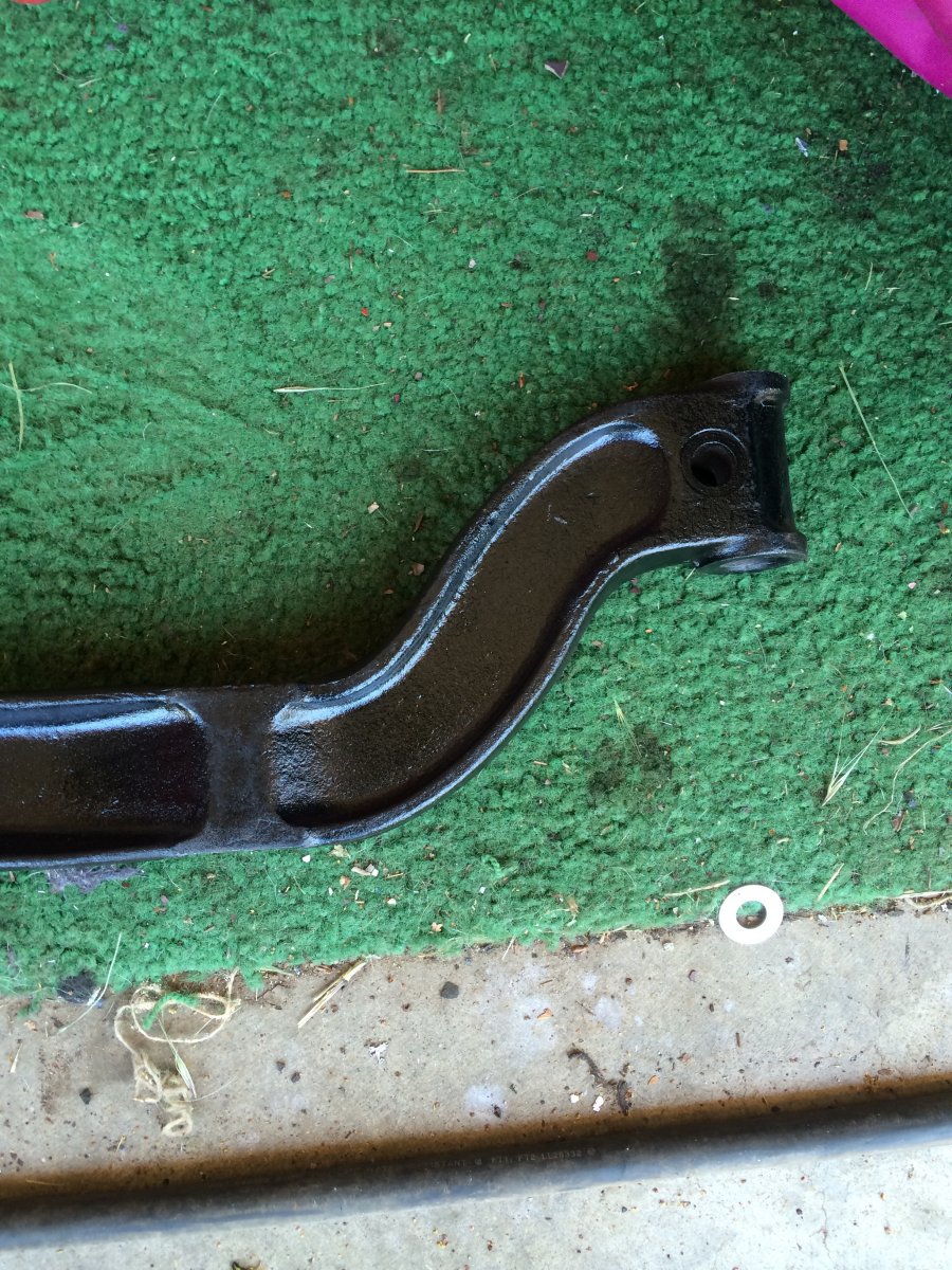

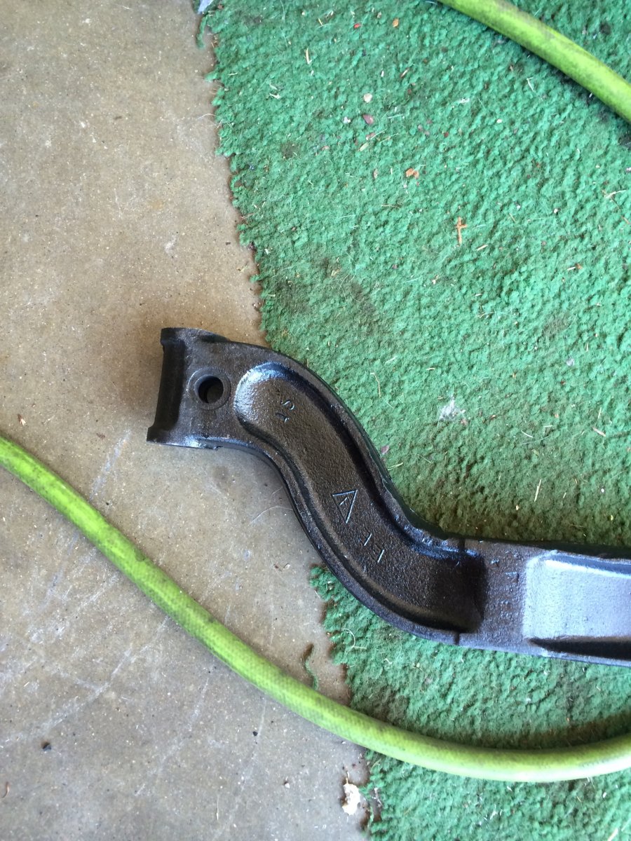

  14. I've never seen those perches with that extra bit of meat in the web? '32 only?
  15. Now that you say that I checked my other sets and none have them. I know this hole front end came off a 32, so maybe only 32? These are perfect too. They never got loose and sloppy. The shafts are perfectly round no out of shaping to them.

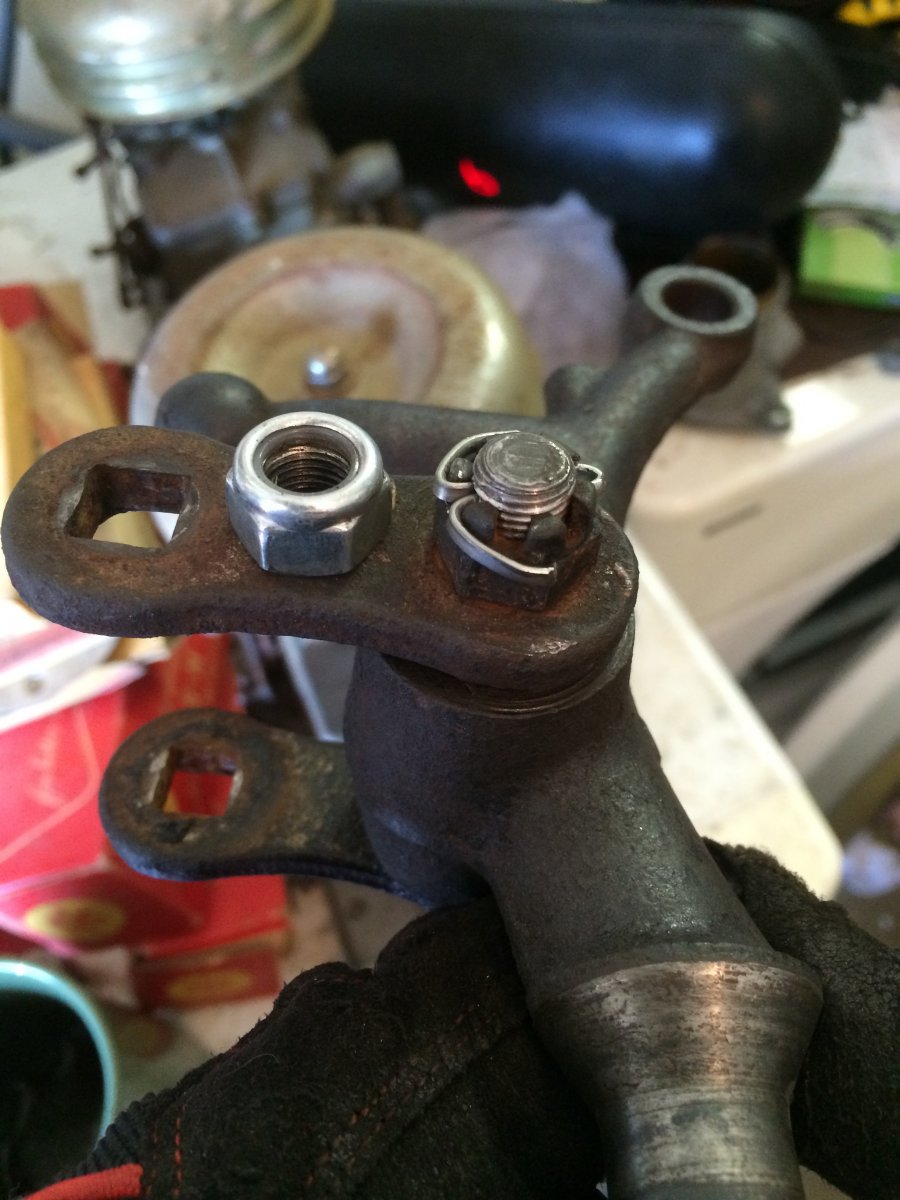

  16. image.jpg When you buy new shackle kits they come with nylon nuts. So now we have to drill them for original castle nuts and cotter pins. Keep it OG.

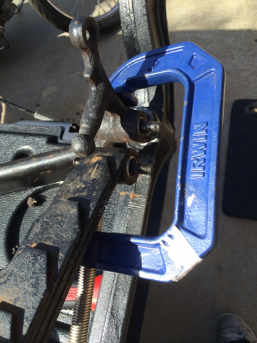

  19. image.jpg Spring spreader.:D
    Stogy likes this.
  20. You think like me! I did exactly the same thing on my first 34 Ford - had a big C-clamp . . . so WTF, worth a try! You're making progress - will be on the road very soon. I took my 32 out this evening - drove to a small town next to me, had a couple beers and a nice dinner - to celebrate the ole' flathead being back on the road. Was a lot of fun . . . exactly what you'll be doing soon. :)
