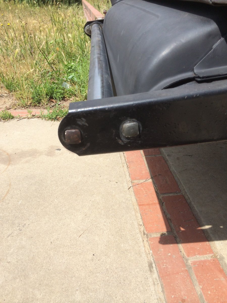

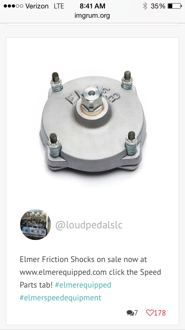

  1. image.jpg Well hell since grandpas name is ELMER maybe I will just have to buy a set of Elmer's fiction shocks...

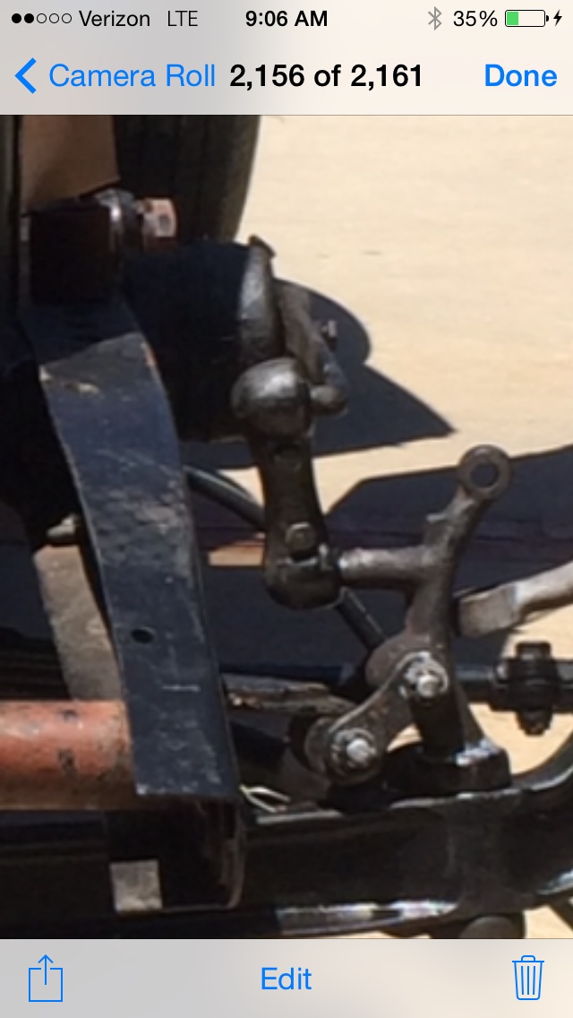

    I used 33/34 arms on early Houdailles. I had to heat the arms and bend them to clear - very easy to do.

    Those are my favorite shocks, had they been available before I bought my rotoflos I would have ran them for sure.

    When the car is on the ground the shock arm are straight with the frame so I'm just gonna hear the arm and bend them back some to get the bones more straight up and down. I also have 32 dog bones and that it why I thought maybe I could just get some 32 arms. I have heard that 31 A model fords are the best shock to use on a 32. Has anyone else heard this???

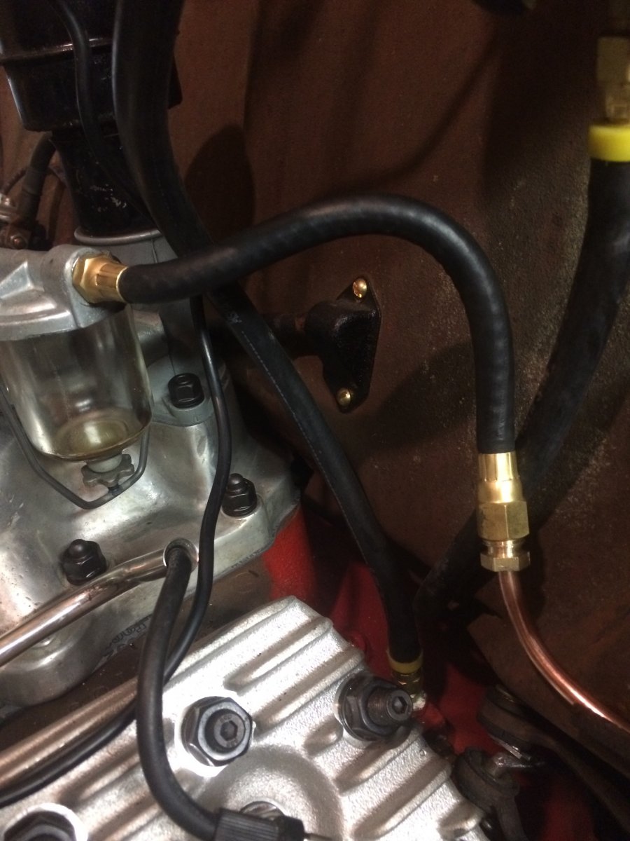

  5. You might consider putting a filter in the gl*** bowl - keeps the **** out of your carbs!
  6. There should be a little screen in there huh? I think I have a old fuel pump with a screen in the bowl. Dale do you have a picture of what one looks like?
  7. It is a little WIX filter and a spring - like this (you can see it in the fuel pump in the background). Lots of guys don't use them, but I like to keep any rust or other **** out of the carbs (as most of these old tanks have some **** in them - even AFTER steam cleaning).

  8. I might have a spare filter - will check in the shop, then I'd have a part number. I believe I got the spring and filter from C&G Ford Parts (I like those guys).

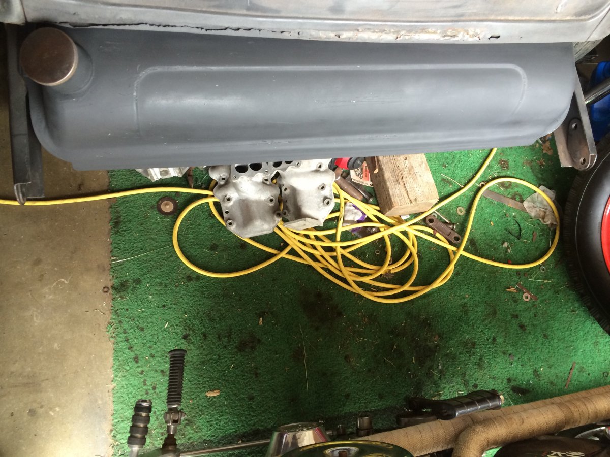

  9. Last time grandpa was up at my house we looked inside the gas tank. We didn't like all the rust inside of it so he bought a brand new gas tank for the car. It's a vintique. Original size and an adaptor to run the stock sending unit pick up. So new tank, new lines. I thought about putting the sock type filter on the pick up inside the tank.

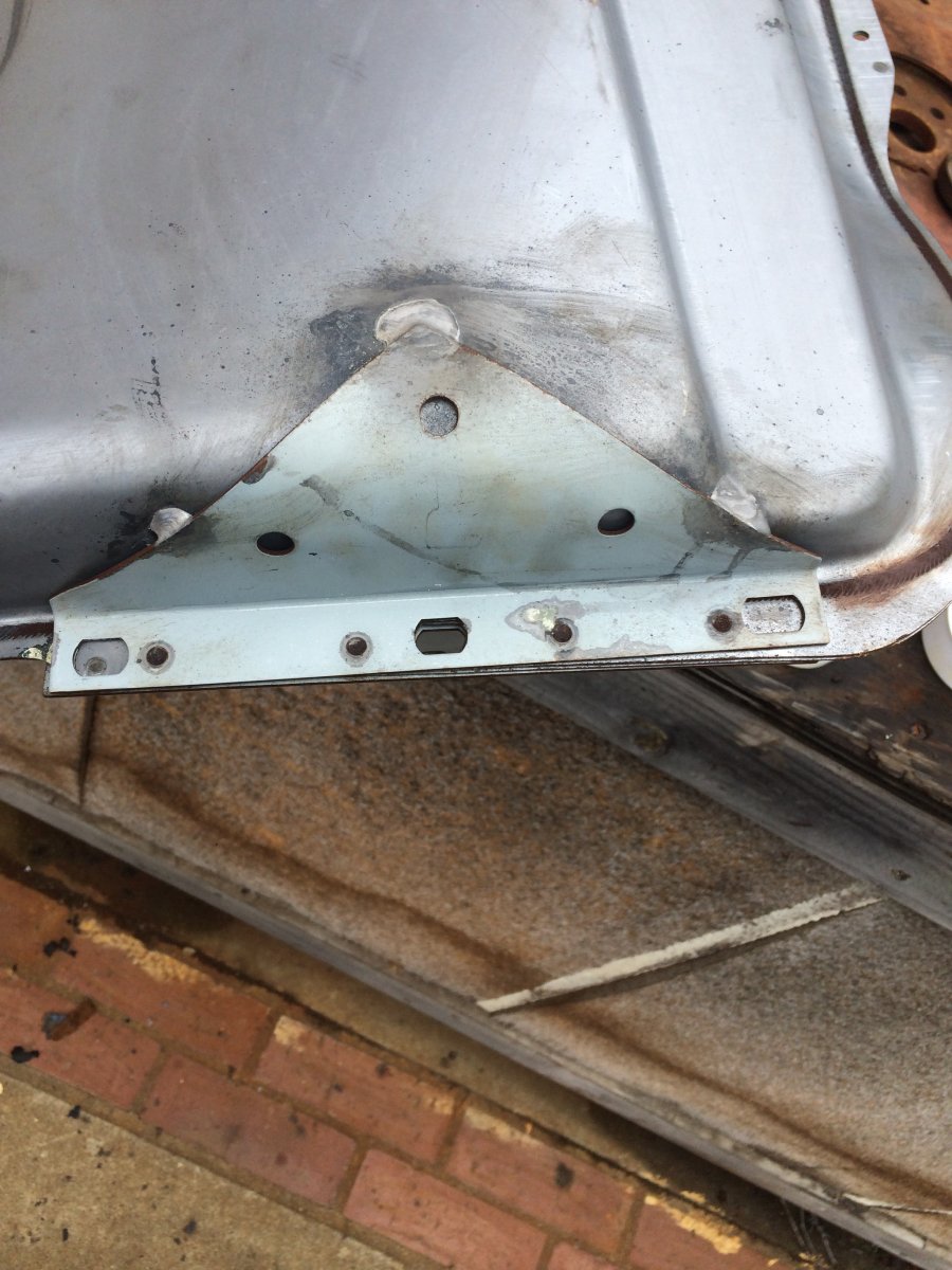

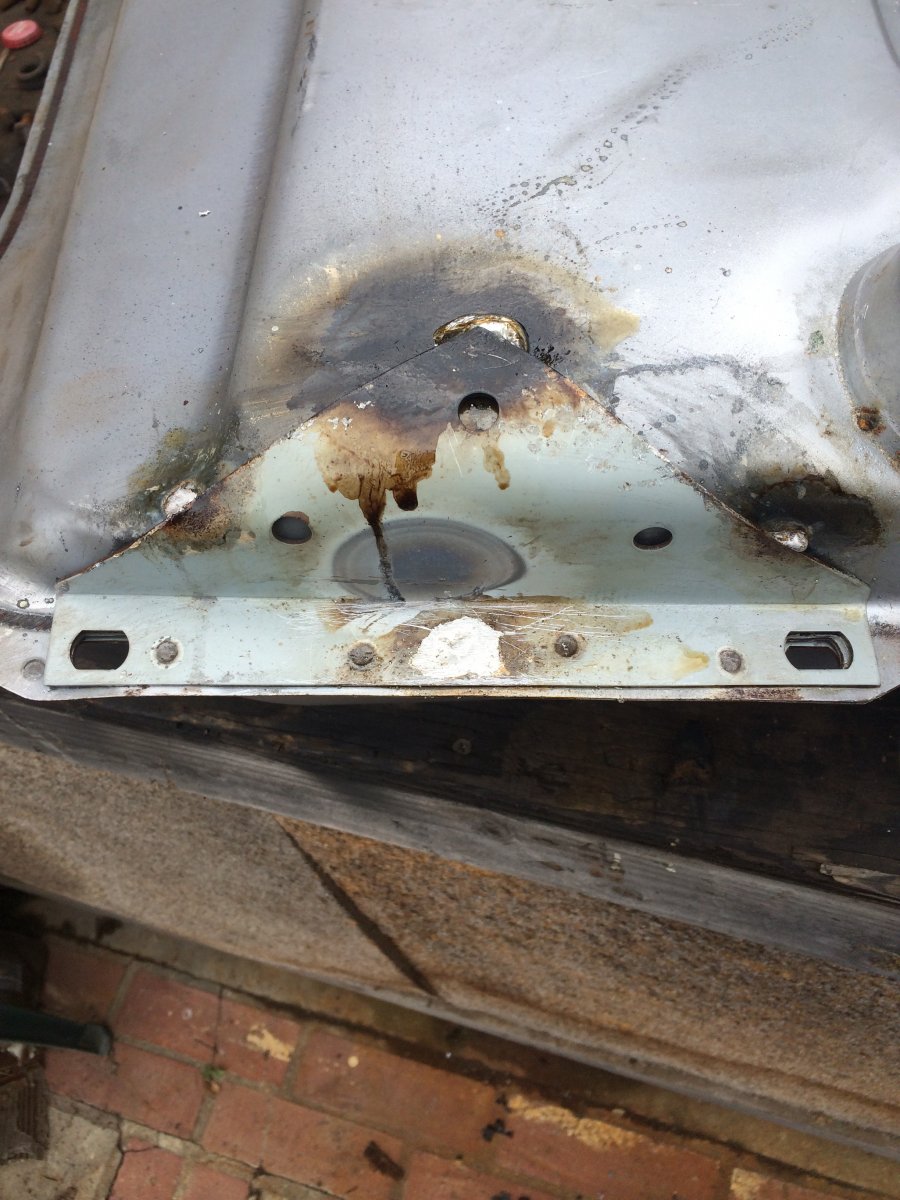

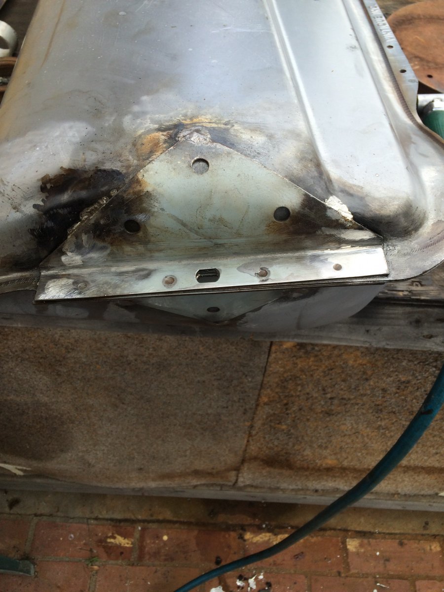

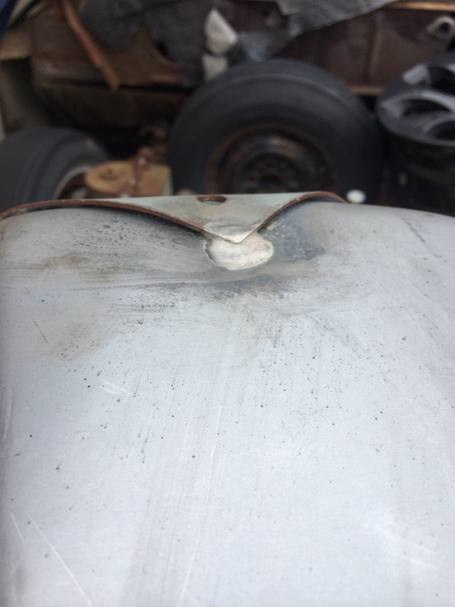

  14. image.jpg image.jpg image.jpg image.jpg So the vintique gas tank has a different look in the sides as an original tank. They must stamp out the side brackets and use one pattern for both sides. That means there's extra holes on bothe sides. Looking at my original tank I see it so I have to fix that. I had to basically redo all there soldier joints, because they were lifted off the tank when they soldiered them. And that made them hit the bottom of the floor of the car. Then I filled in the extra holes so now when anyone looks at the car they can't tell it a repop tank. Unless you read this and know:D:D
