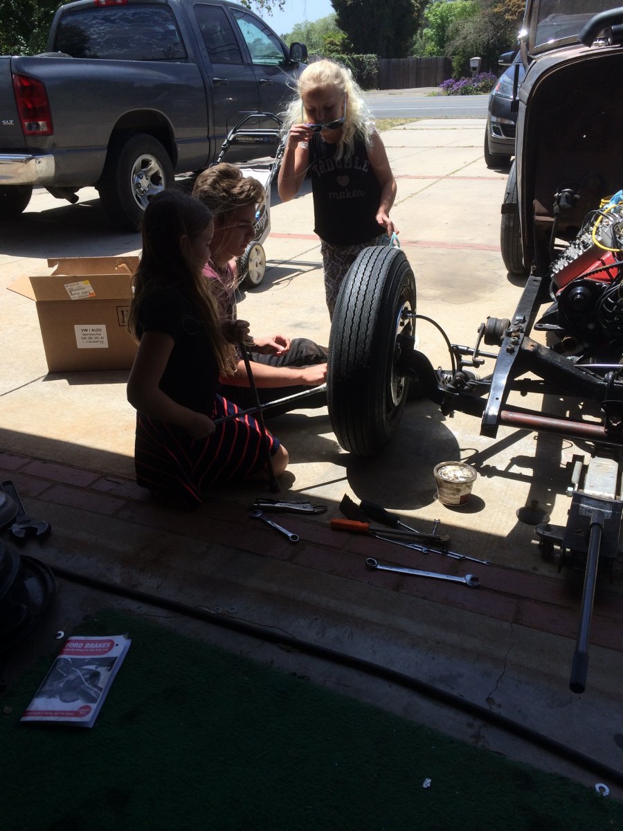

  3. image.jpg Teaching the kids how to install and adjust brakes. And next bleed them.

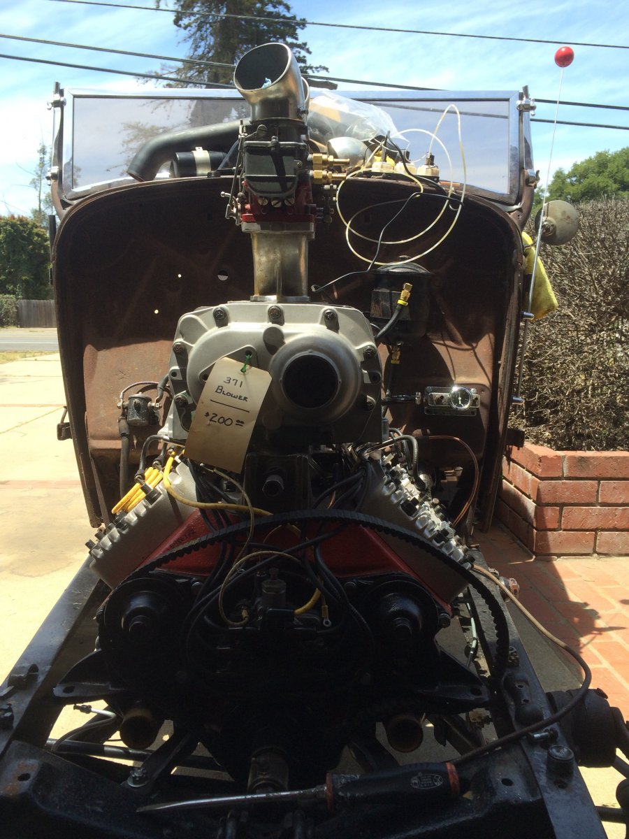

  7. Gary Addcox
    Joined: Aug 28, 2009
    Posts: 2,576
    Gary Addcox
    That slingshot piece perched atop that huffer is the ****s. Love it.

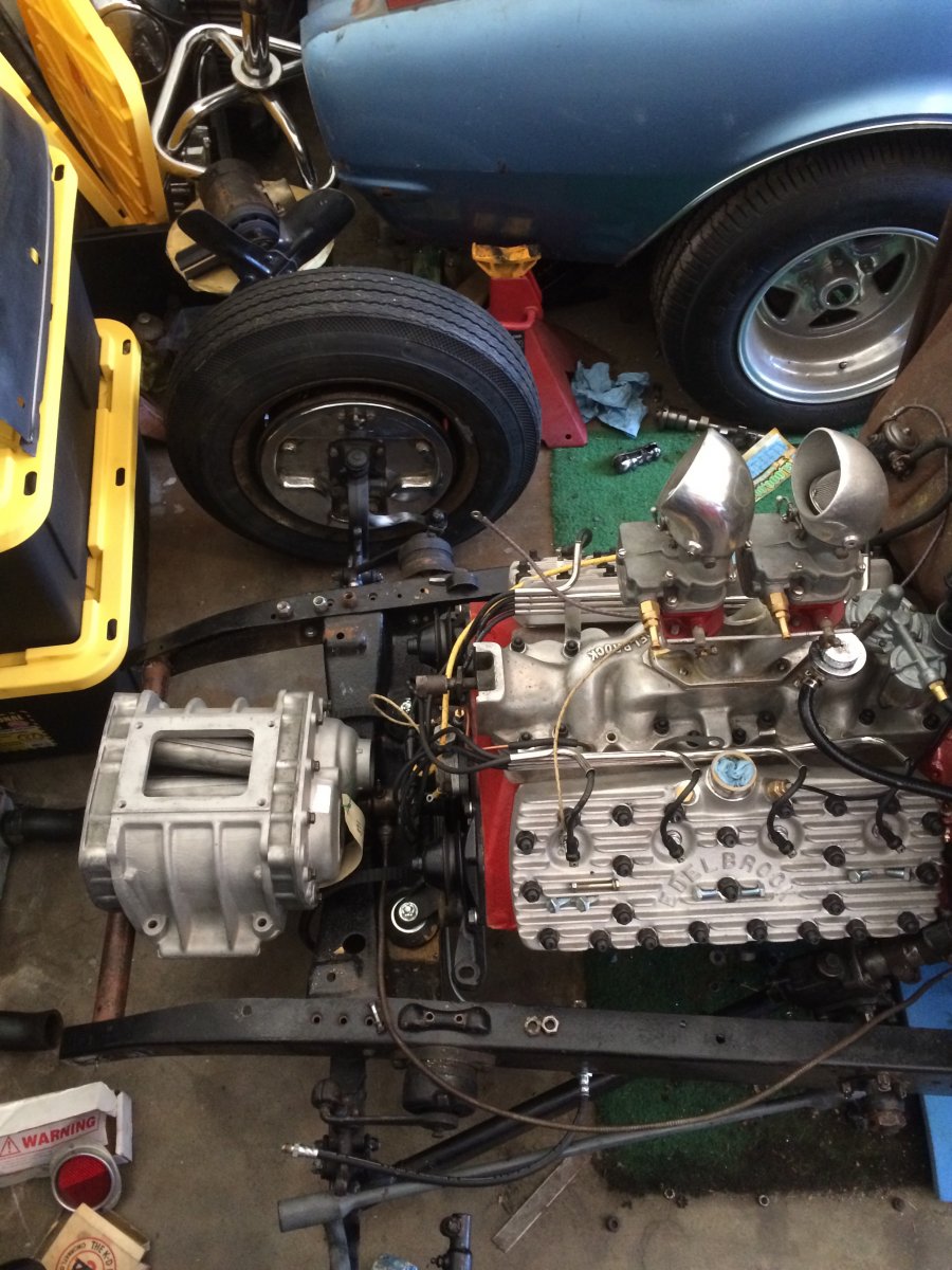

  8. 383deuce
    Joined: Jul 10, 2009
    Posts: 3,668
    383deuce
    HOT DAM, Bruce I have died & gone to heaven...The 371 blower is the ***s!!!!!!!!!!!! now I want to hear it run with that hufffffffer on top.
    You just keep pulling **** out of the bag dude!

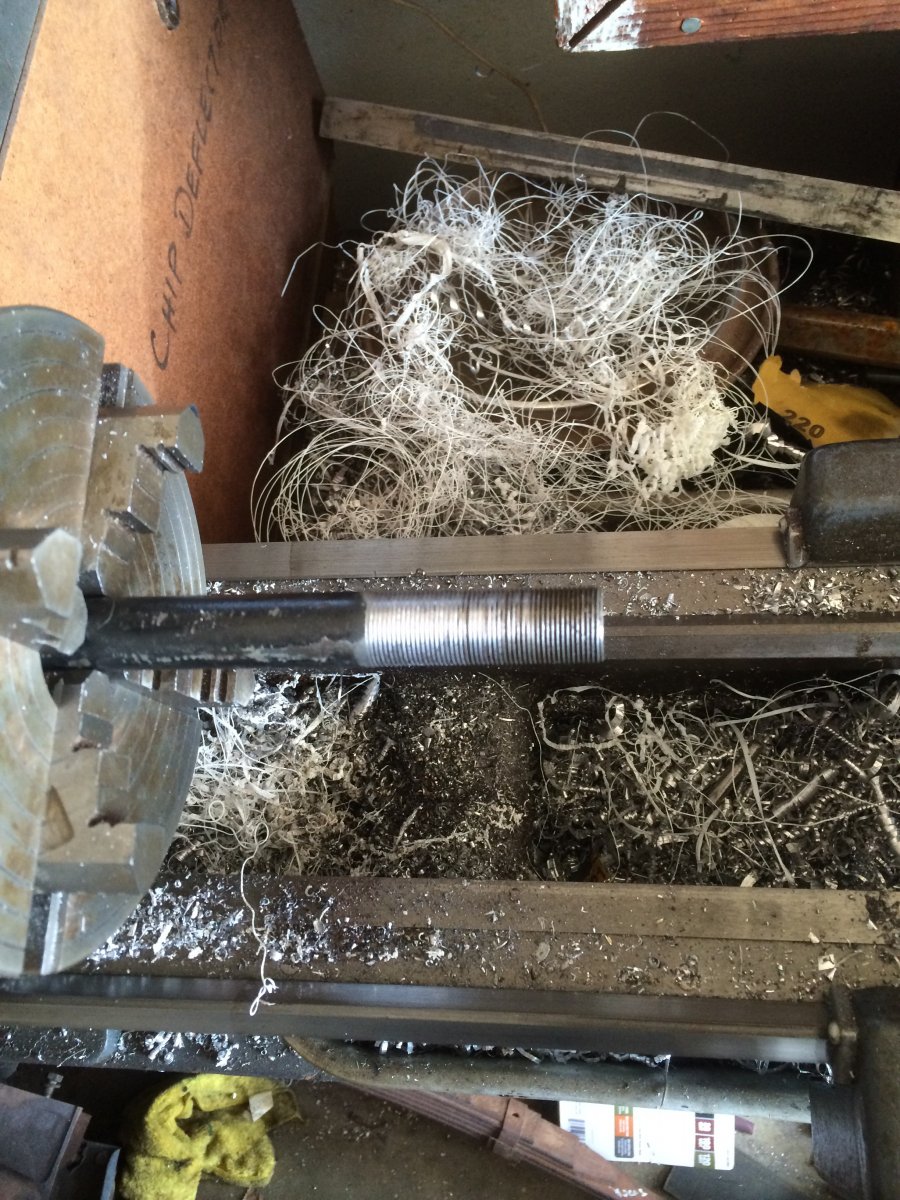

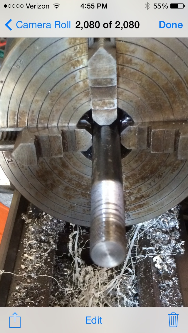

  9. image.jpg image.jpg So I figured out that when you drop an axel they get narrower. That makes the tie rod to long. So I put it in the lathe and cut around two inches off. After I cut it I then realized I cut the left hand thread side like a dummy. But it's a good thing my lathe can spin both ways. I figured out the threads are a 24 tpi. So I got down and cut new left hand threads. I also reamed the inside and pressed in a new plug.
    FOR ALL those who don't know a tie rod is hollow ol Henry ford knew that a tube is stronger than a solid round. So now the front end is done. More to come later.
  10. I just don't know if the plug is to keep grease out of the tube or to add strength to the threaded area so when you tighten the tie rod ends you don't crush the tube. I'm gonna guess so you don't crush the tube.

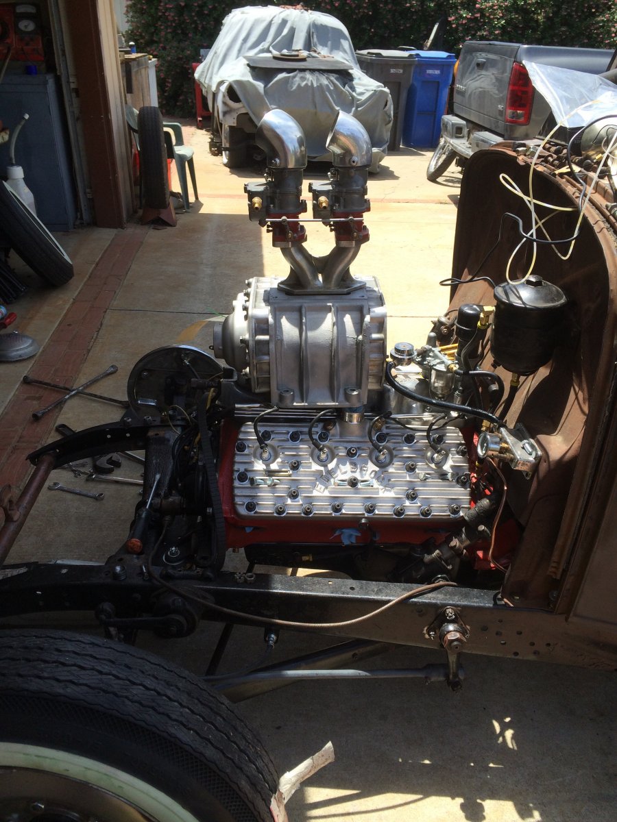

  11. Well Dennis before I can run the blower I will have to save about 10 grand and talk a lot more with dale on how to set it up correctly. But thy ol hypersonic sure is asking when it can get BLOWEN!!!!!!!!
    brEad and loudbang like this.
  12. 383deuce
    Posts: 3,668
    383deuce
    Well I was wondering about that myself and almost PMed Dale and asked him what all you needed to do to run it on your motor. Then I thought hell I bet Bruce has already asked him about it.
    Sure does look cool on top that motor.....

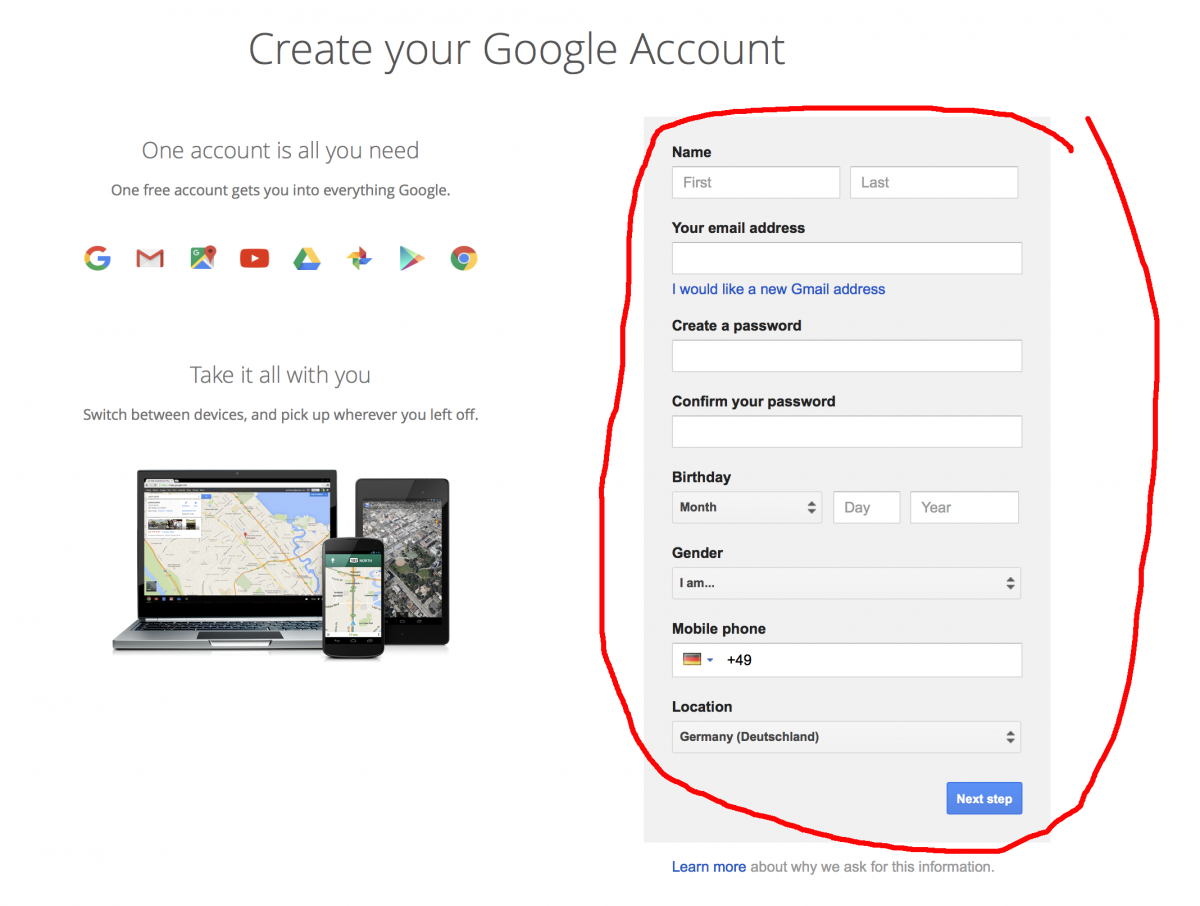

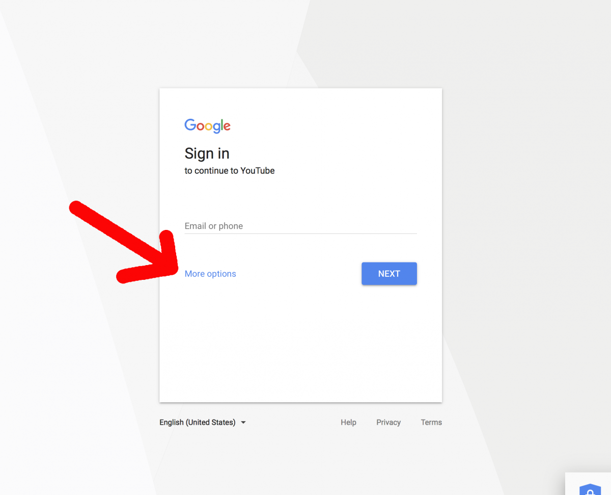

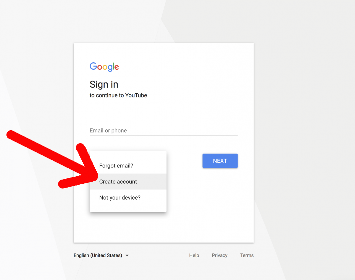

  20. Steffen Jobst
    Joined: Sep 16, 2016
    Posts: 1,993
    Steffen Jobst
    Best way:
    Make your own channel at you tube and then post the link here.
    So everybody can easily see the movie - and all other movies taht will follow of this great car:
    Bildschirmfoto 2017-05-20 um 10.08.28.png Bildschirmfoto 2017-05-20 um 10.08.44.png Bildschirmfoto 2017-05-20 um 10.08.50.png Bildschirmfoto 2017-05-20 um 10.09.08.png
    PS: I will instantly delete this post if you have your account at you tube.

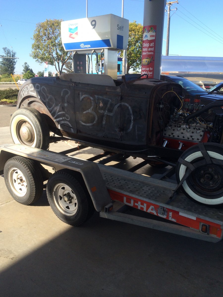

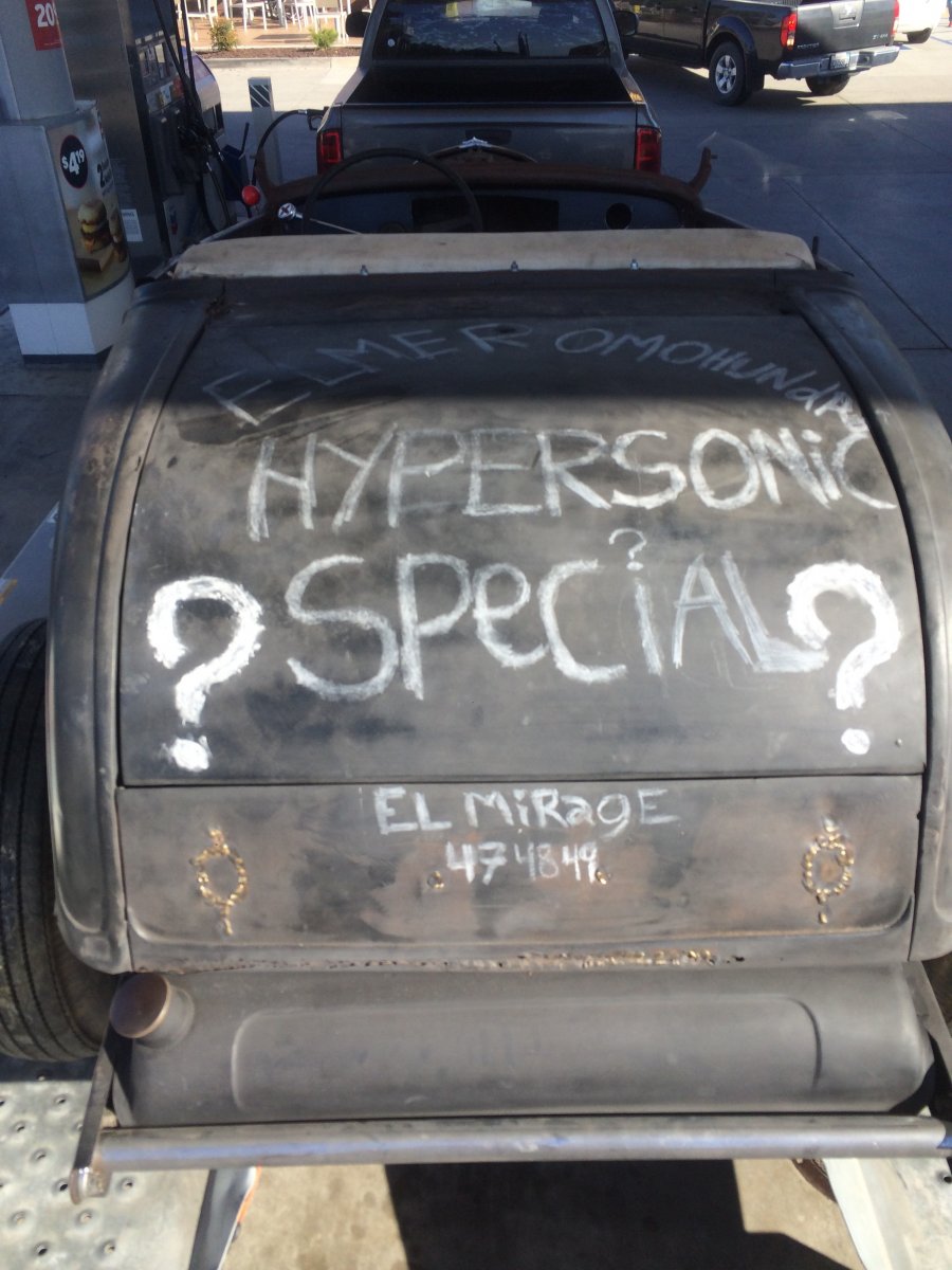

  24. image.jpg image.jpg Off to the lakes... Looks like littles kids drawing on some ol junk..:D

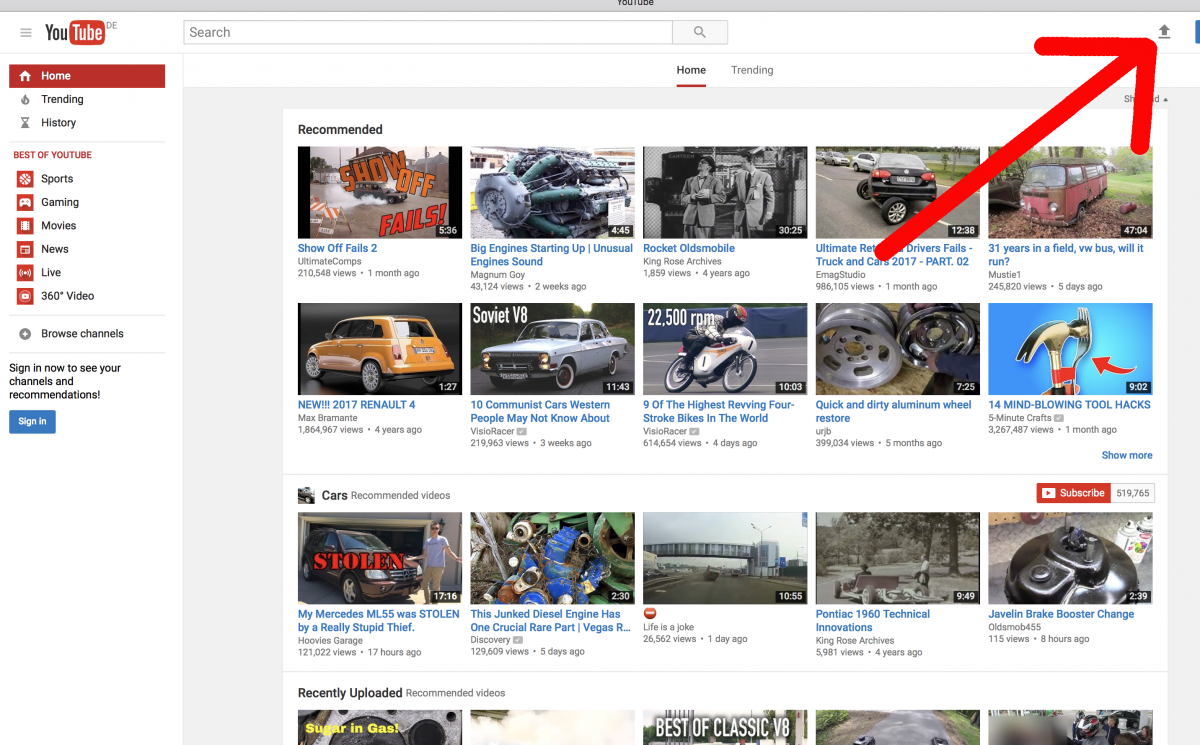

  27. Steffen Jobst
    Posts: 1,993
    Steffen Jobst
    Mr. Paintslinger, go to your movie on Youtube:
    .[/COLOR
    Highlight the Youtube adress of your movie and copy it:
    [/COLOR
    Paste the adress in your post here in the HAMB. Ready!
