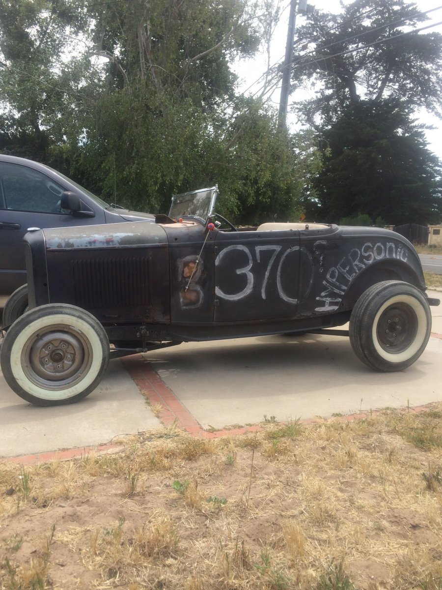

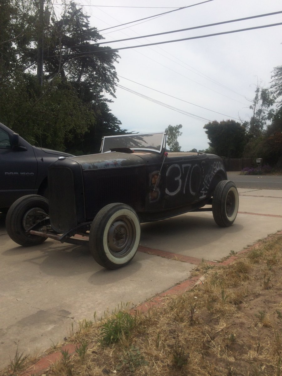

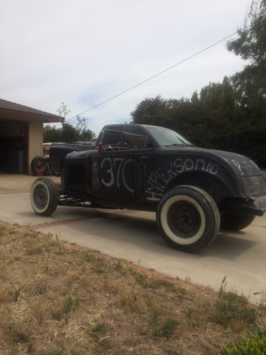

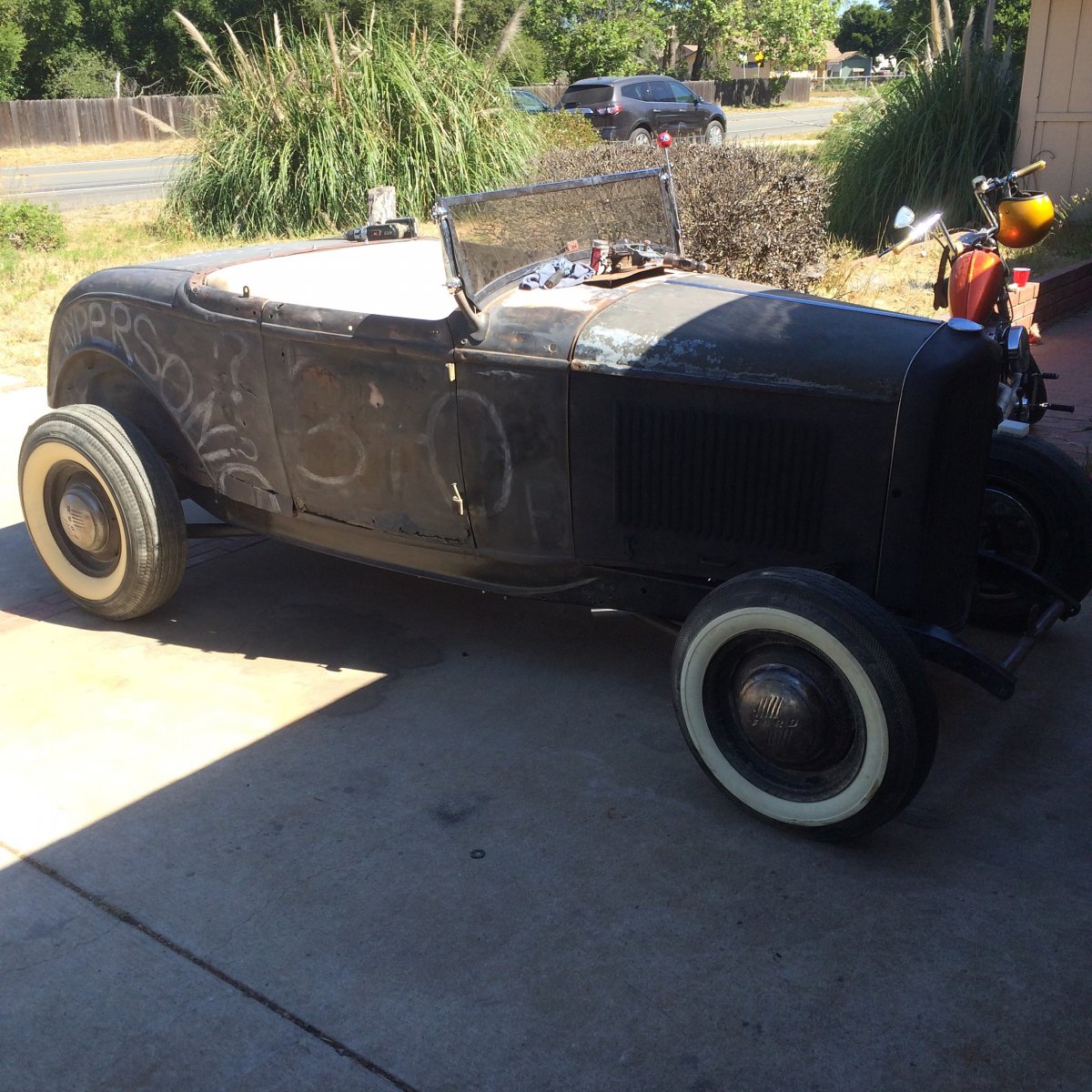

  5. image.jpg image.jpg image.jpg Looks so much better with the hood on!
    heavydumper, bonesy, Stogy and 8 others like this.
  6. Looks great! What's going on with the rear end? Is that the stock location? Sorry, if this has been addressed I missed it!
  7. Yes I believe that's the stock location with fenders on. I have another torque tube and drive shaft I just need to cut them and have the drive shaft re splined. And set it back. I also need to put in a model a or t spring and get rid of the curved 32 spring.

    Yep, looks better with the hood on for sure.

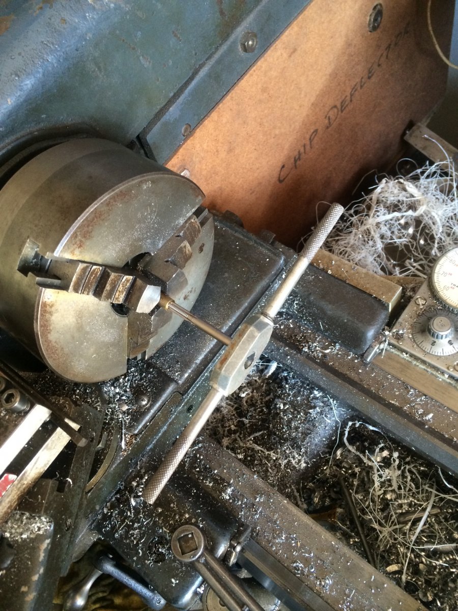

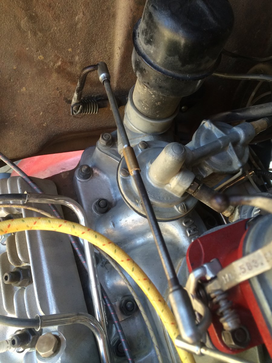

  12. image.jpg image.jpg Did some more lathe work machined a br*** interlock for my throttle rods.
    Incase anybody out there wants to make a adjustable throttle rod out of original throttle rods you cut them down and tap them with 10-32 tap and die. .190 shaft = 10/32 tap and die. .190 shaft is stock A model and 32-48 or so. So buy you a 10/32 tap and die and get to work.

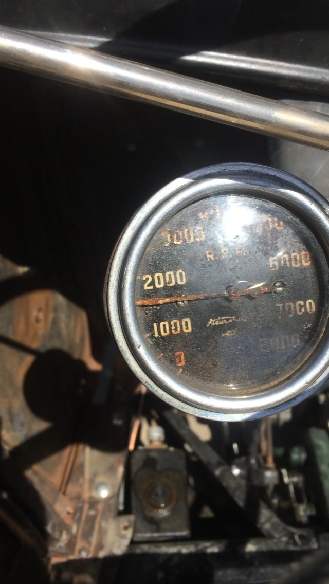

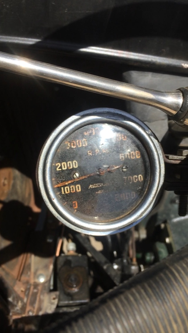

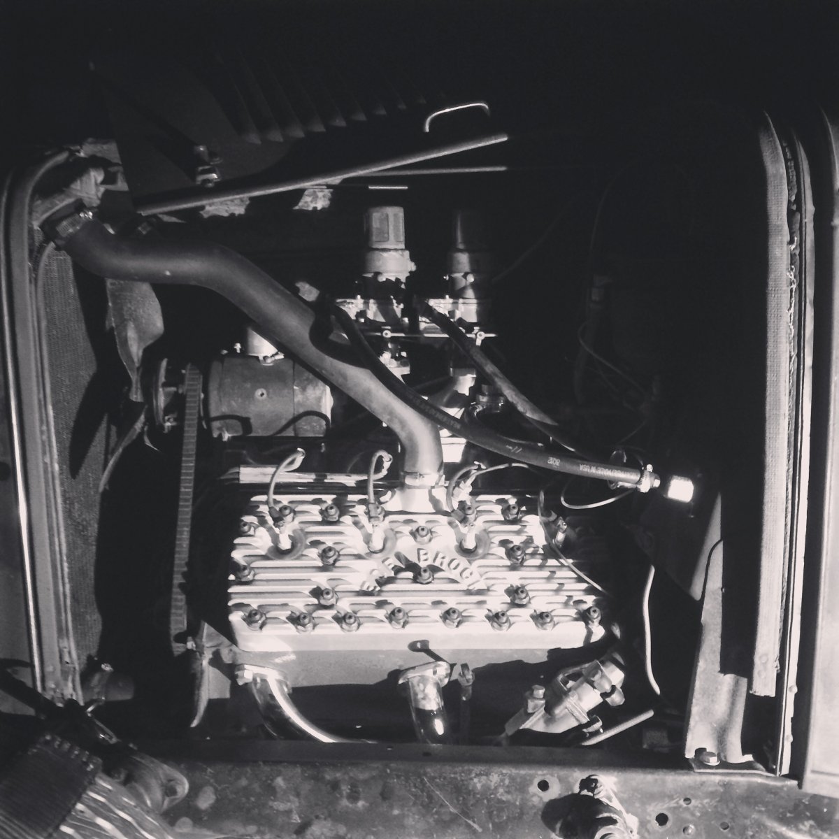

  22. image.jpg image.jpg It's been a fun journey that's for sure. Thanks everyone who has followed along.
    I got my tach hooked up and it works really good. It's got some great patina on it.:rolleyes::D
  23. Cool **** . . . love it! Looks like about where my engine 'idles'! LOL

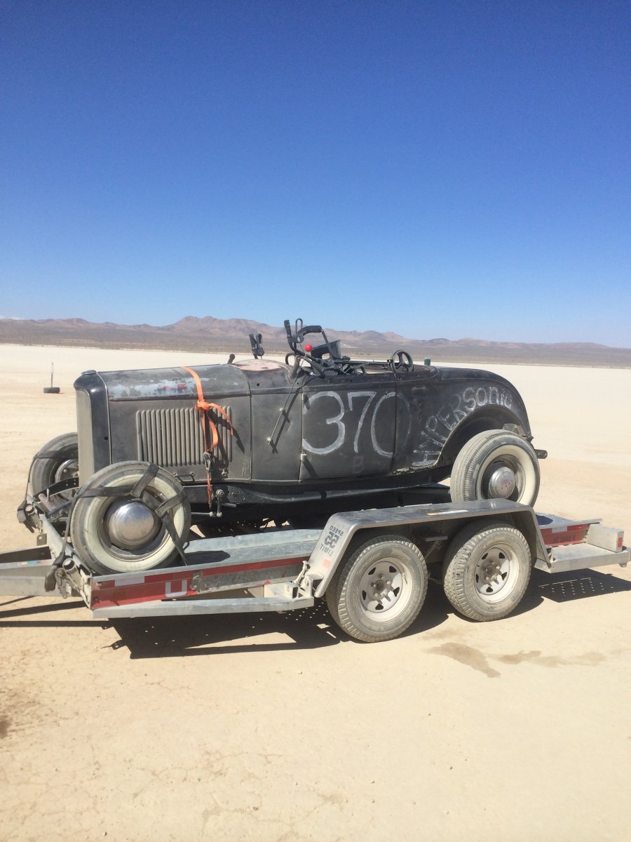

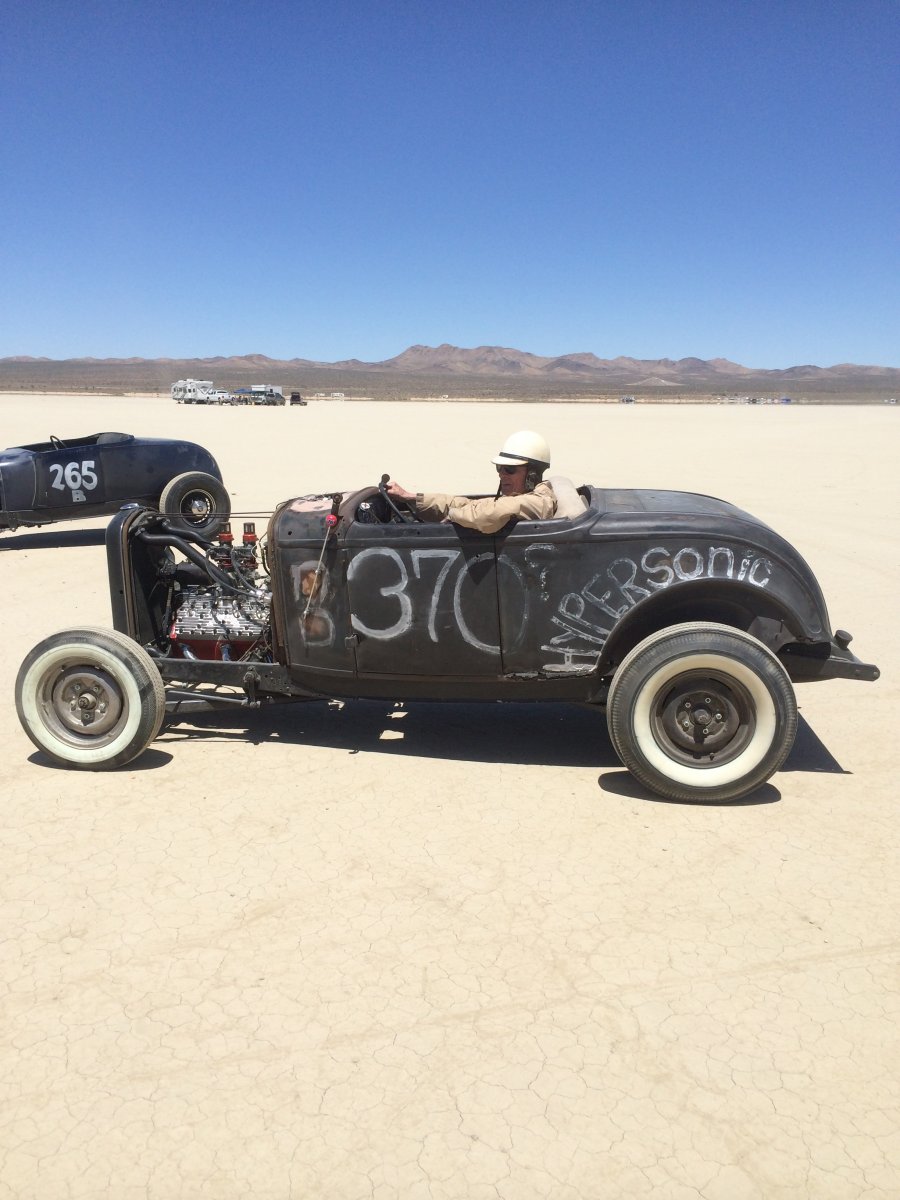

  24. image.jpg image.jpg image.jpg Elmirage tomorrow. Oh **** wait it's 1:20 am so elmirage today lol. I better go to sleep.

    Yeah buddy! Can't wait to see the results :)
  26. Now we're talkin . . . get that bad boy out on the dirt and have some fun!

    The tach is bad *** cool........& looks just right, you have a great eye for the right parts.

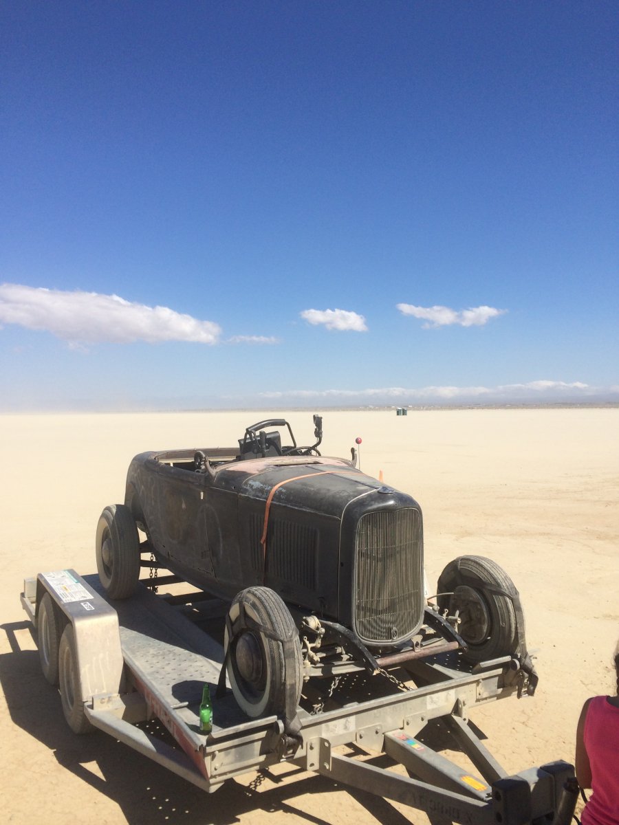

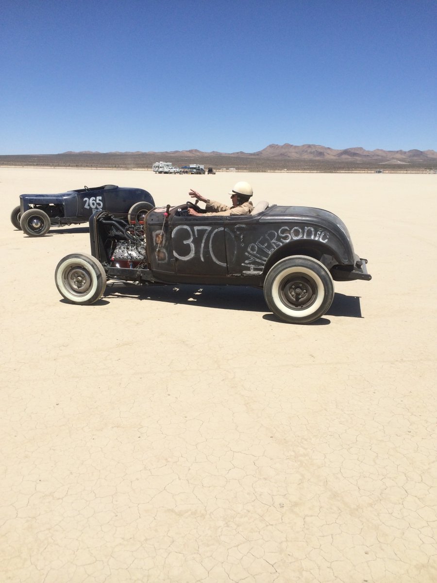

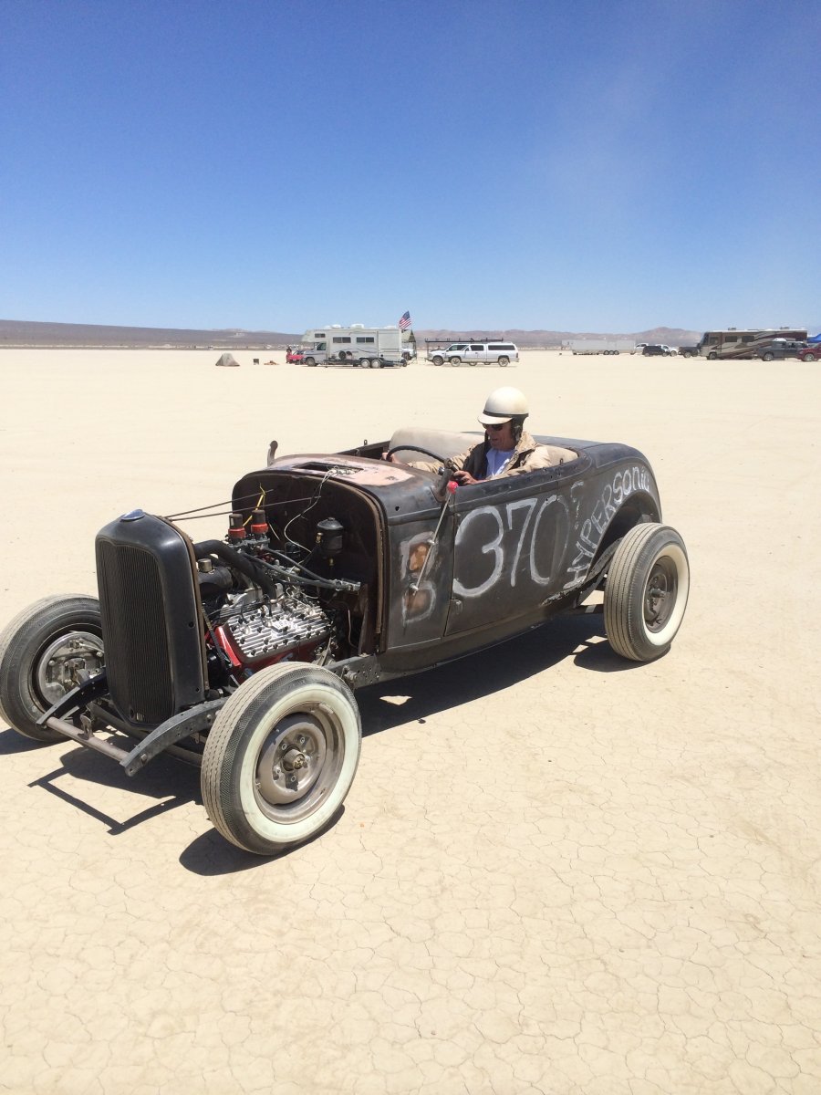

  28. image.jpg image.jpg image.jpg Well elmirage was a bust we got out there late. By the time we got there it was 35-40 mph tail wind on the lake. Grandpa almost blew away. To much moon dust flying in the air. It was like a ghost town out there. They cancelled the runs around 11 or so. We played alittle with the car but the wind was just too much. See y'all at LarsLars
