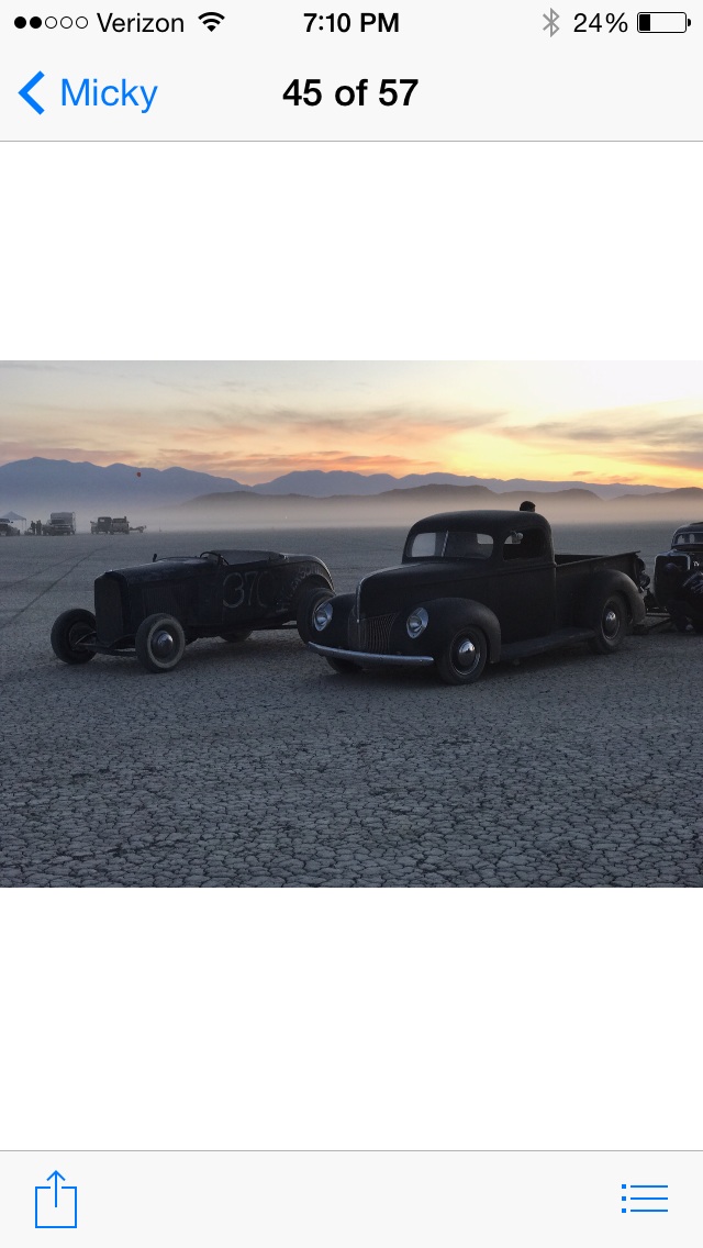

  2. Had a great time with Gary from San Antonio. Wish we had more time to hang out but I had to get my friend back to Hollywood that night. image.jpg image.jpg image.jpg image.jpg image.jpg image.jpg

    WOW! Bruce...Some great photos right there..I really like the one with the dust in the back ground.
    Thank's for posting them...

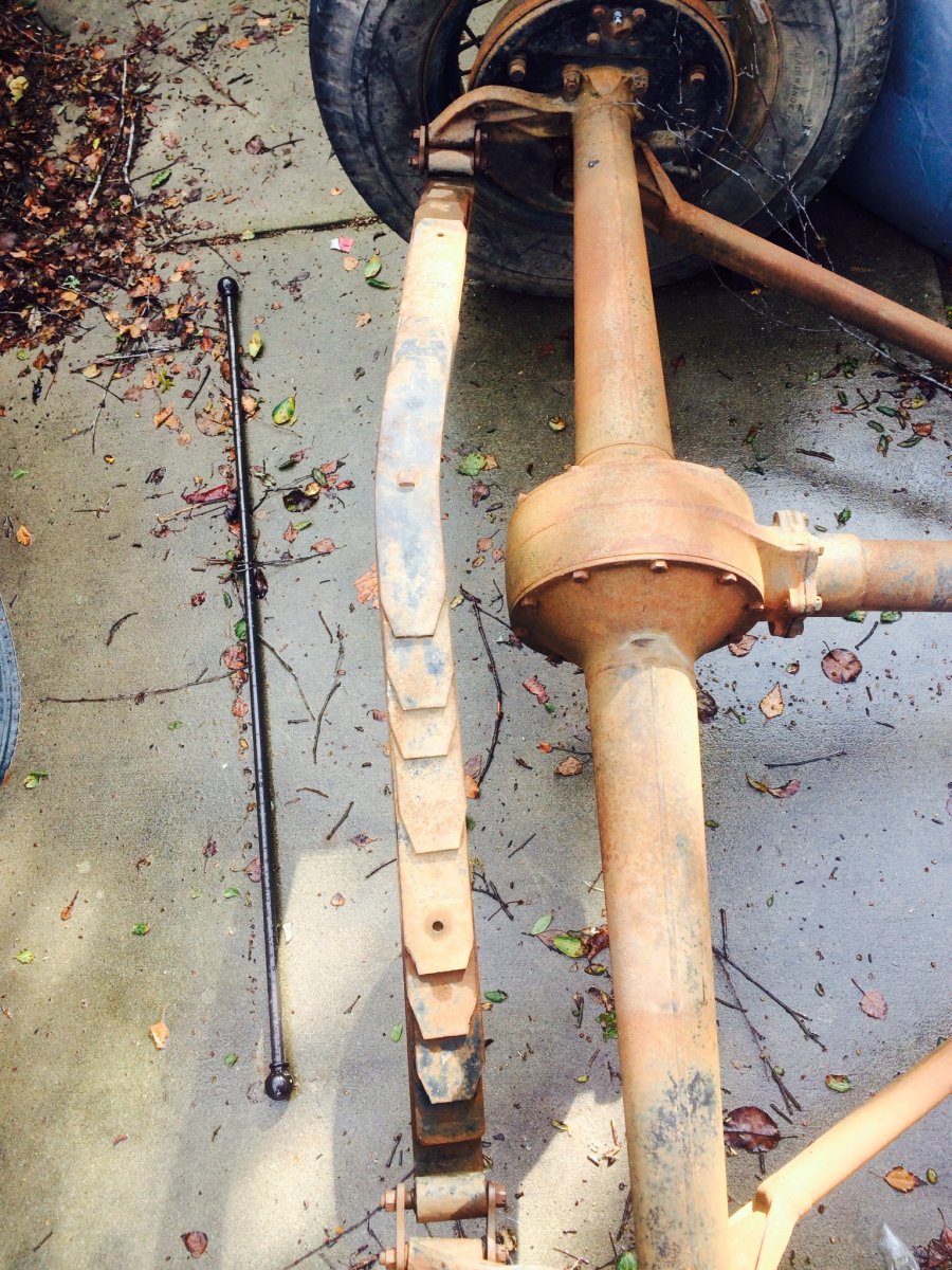

    Hi from Australia , I have been reading this article for a while have spent much enjoyable time studying every detail . It takes me back to my first 32 ford in 1962 . Your rear end problem with centering your wheels in the correct spot is because of the 32 spring and the 39 rear axle . The curved 32 spring pushes the 39 rear end forward because the spring hanger brackets on the 39 are longer than the 32 ones . My first 32 had this setup but ran a strait 39 rear spring , i never checked it pot properly , how it had the straight spring in the curved c/member .

    Dear Sir , I struggle with this computer . The above photo of your ch***is and rear axle shows the miss aligned shackles and the diff center is too far from the crossmember , so the curved spring has pushed the axle forward . I could have helped with some of you parts needed list but the shipping costs are horrendous from down here . Its good to see you have it done and i applaud the guys that helped out . I'm probably cl***ed as one of the dreaded " Hoarders " but i been a 32 Ford fan for 55 years and i really like my stuff . Thank you Turbodiesel from Downunder
  18. Thanks turbo. The second ch***is I bought was set up with the wheels forward. I think it gives it an alter look. Shorter wheel base. I have all the stuff to make it fit perfect with the wheel wells but as of right now it's not broken so I'm not gonna fix it. Plus it gives everyone something to talk about.

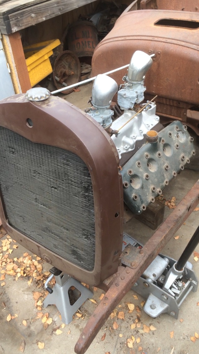

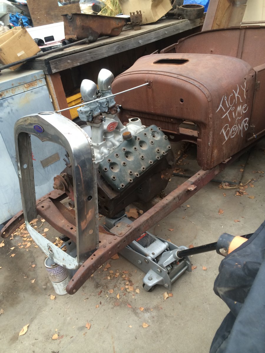

  19. image.jpg image.jpg Boy oh boy with all these fires here in California has kept the weather in the high 70s so I just keep hustling. It's snowing here but not cold snow. Just ash!!! 27 rpu on A model frame. Getting her ready for May el mirage. Get out there and work.

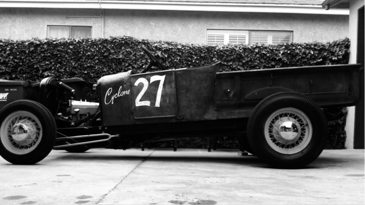

    Tom Fritz did this oil painting in 1999. I saw it at the 2000 LARS, Wally Parks, was driving around in a golf cart and indicated that one just like the one he was looking at (mine) was on canvas in the vendors area.
    It was so good to hear Wally say to his p***enger,”Now here’s a Hot Rod!”, So I went and checked out the painting. Tom Fritz took a ton of pics of it when we were out at the Antique Nats.
    621C8F4F-DAB7-49D3-83FE-8E6AEDD0E369.jpeg For the 2001 Mooneyes Show in SFS, I took the T-Ster to the show, but this time she was sporting a pick up bed, was a great move.
    This is one of those cars that are just plain fun.
    Congrats on getting one of those as well.
    The kids are going to dig it!!!! See ya at El Mirage!!!!

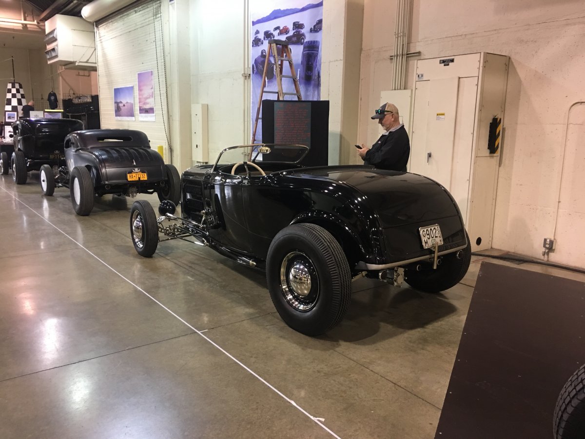

    Dennis,
    I was there on Thursday, much easier to see the cars in their natural states. F92D62F6-300D-42CE-BC11-07027923E0AF.jpeg 3C27215F-51EC-42D4-9924-A76CF6DE7916.jpeg D8A4FE31-1B25-445E-9524-9111B6D5E683.jpeg Gotta a text from Bruce, he was with Jimmy B. Friday Night.
    Sorry I missed you, call me when you’re in town next visit. ;).
