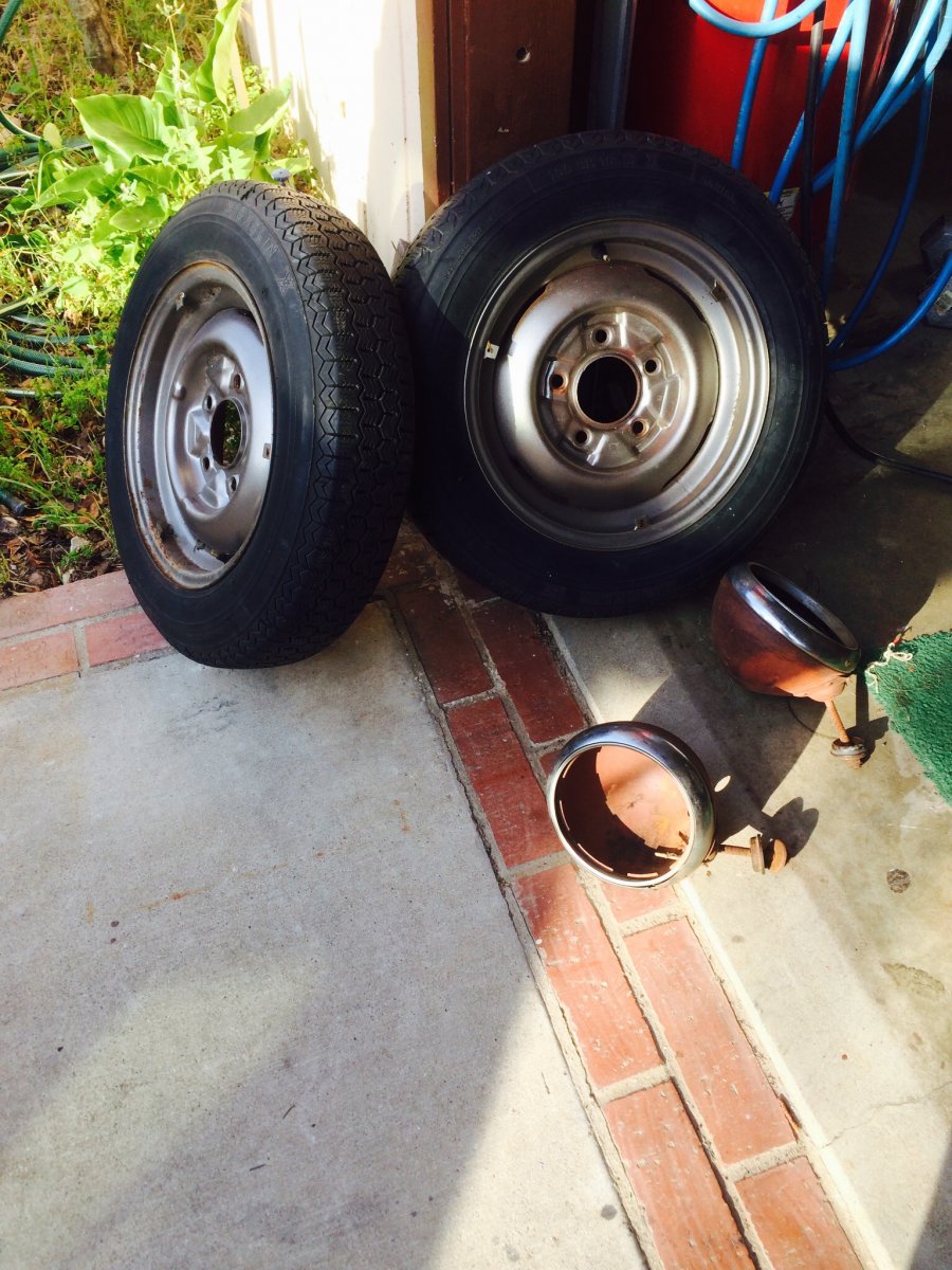

  3. image.jpg I went down and spent the day with kiwi Kev and he donated a set of 15 inch wheels and some *****in old headlights to the cause. Very greatfull thanks Kevin. I also picked up some other really good parts from a buddy of his. Now i have complete brakes, ebrake set up a way nicer 32-34 rear spring and complete 32-34 spindles with the old school way of spacers for the juice brakes. Ready to run hey pump your brakes. Build is rolling along. After hanging out with Kevin all day I'm thinking about building a g***er out of my wife's 67 Camaro.
    kiwijeff, skatermann and volvobrynk like this.

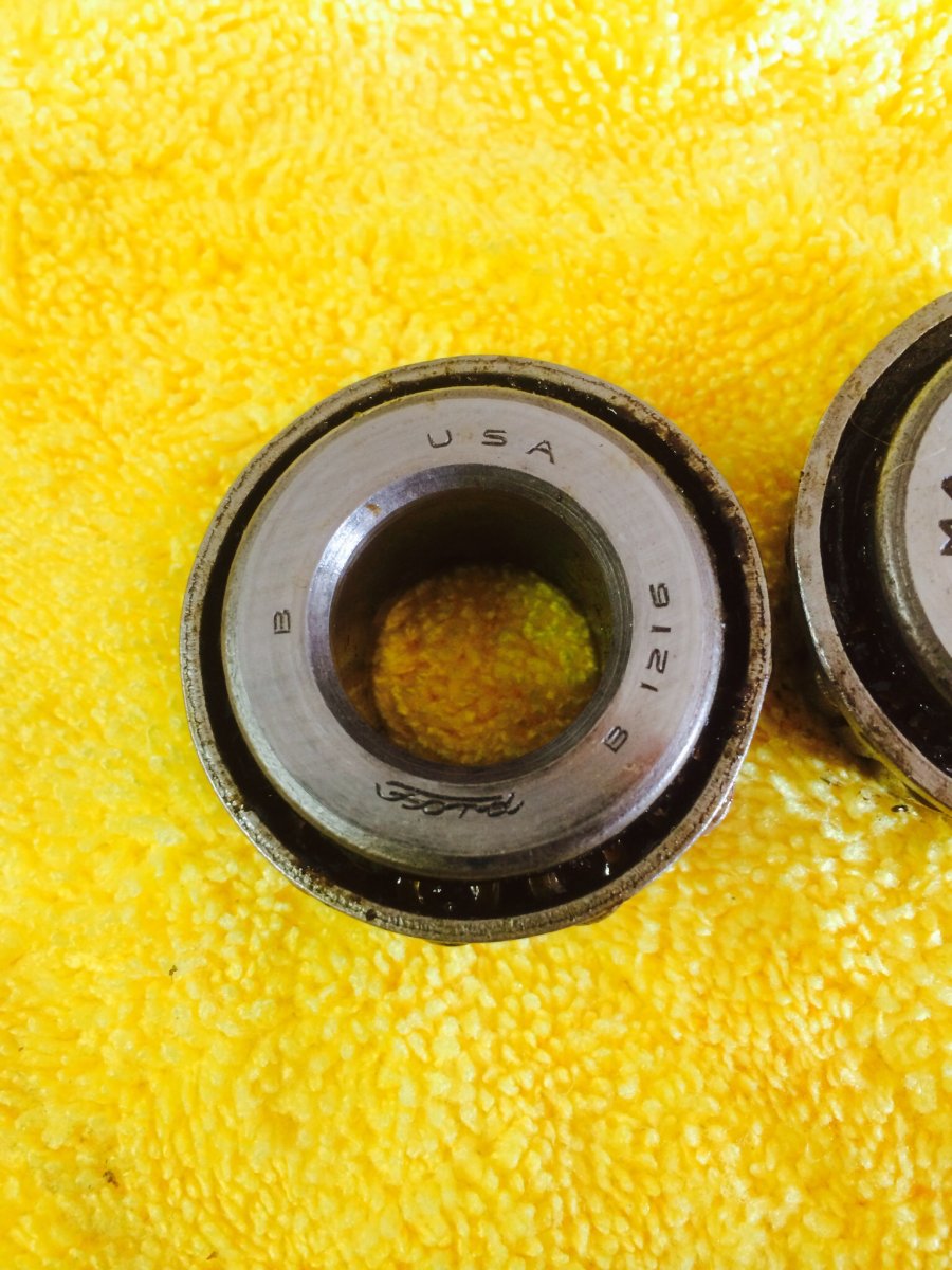

  21. image.jpg image.jpg Wow cool are these ford script bearings in like brand new shape. Part number b-1216
    63fdsnr and kidcampbell71 like this.
