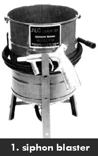

    Pic. 1. is a siphon blaster, basically a bucket of sand with a hose in it. The sand gets siphoned thru the hose.
