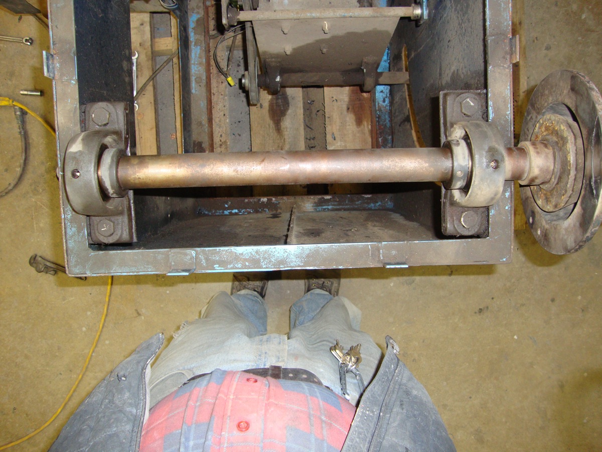

    The boat prop shop I go to has an antique gravity balancer that has $2000.00 worth
    of bearings in it.
