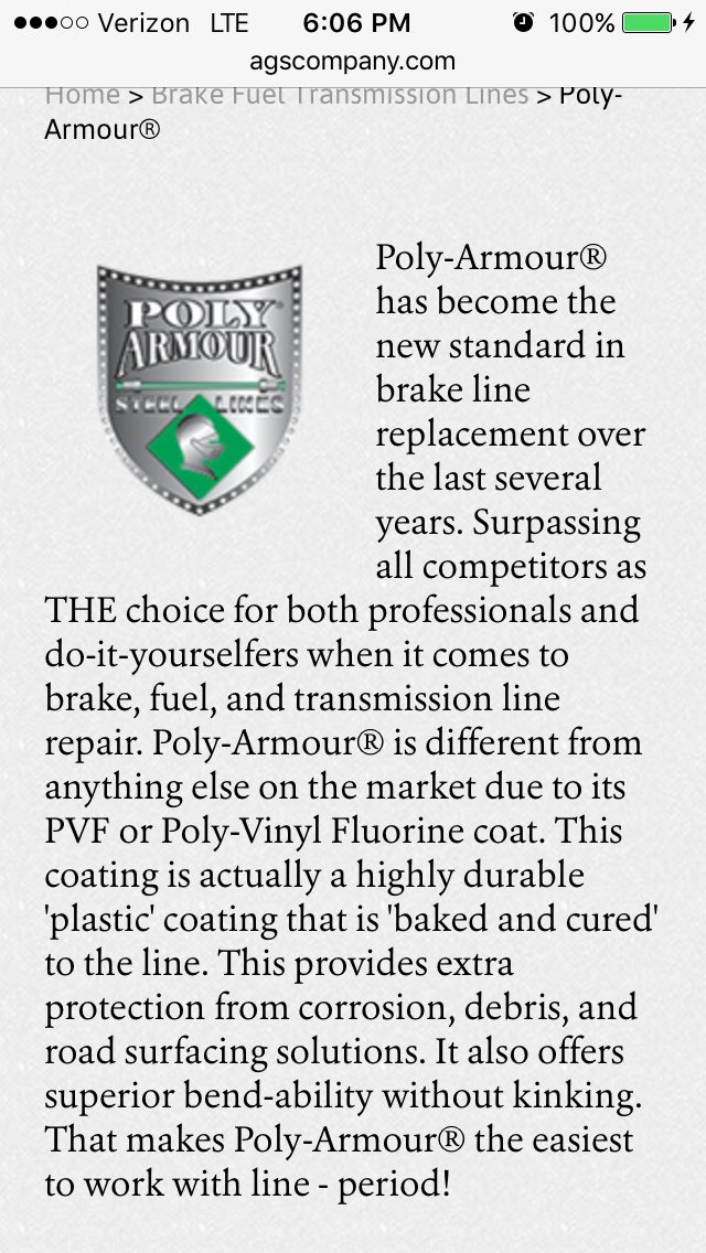

  14. Let's be sure we are talking about the same stuff. Not sure what y'all have in Cali or Alaska.
    Around here we get "poly armor" by AGS. It's coating certainly is plastic. It's absolutely a pain in the *** to flair and Removing the coating to flair it removes the protection, but necessary. It bends nice, so nice you can loop it bare handed and not need to flair it.
    crashfarmer likes this.

    We have green line that has p***ivated phosphate or zinc. No plastic.

    It would appear that there are TWO different green line types.
  18. FMSI brand ?
    That's what I find for pasivated brake line. They says it's a zinc "green coat".
    I figured that you must be talking something different. Maybe there's more out there and it's already clear that one mans "green brake line" isn't the same as another's.
